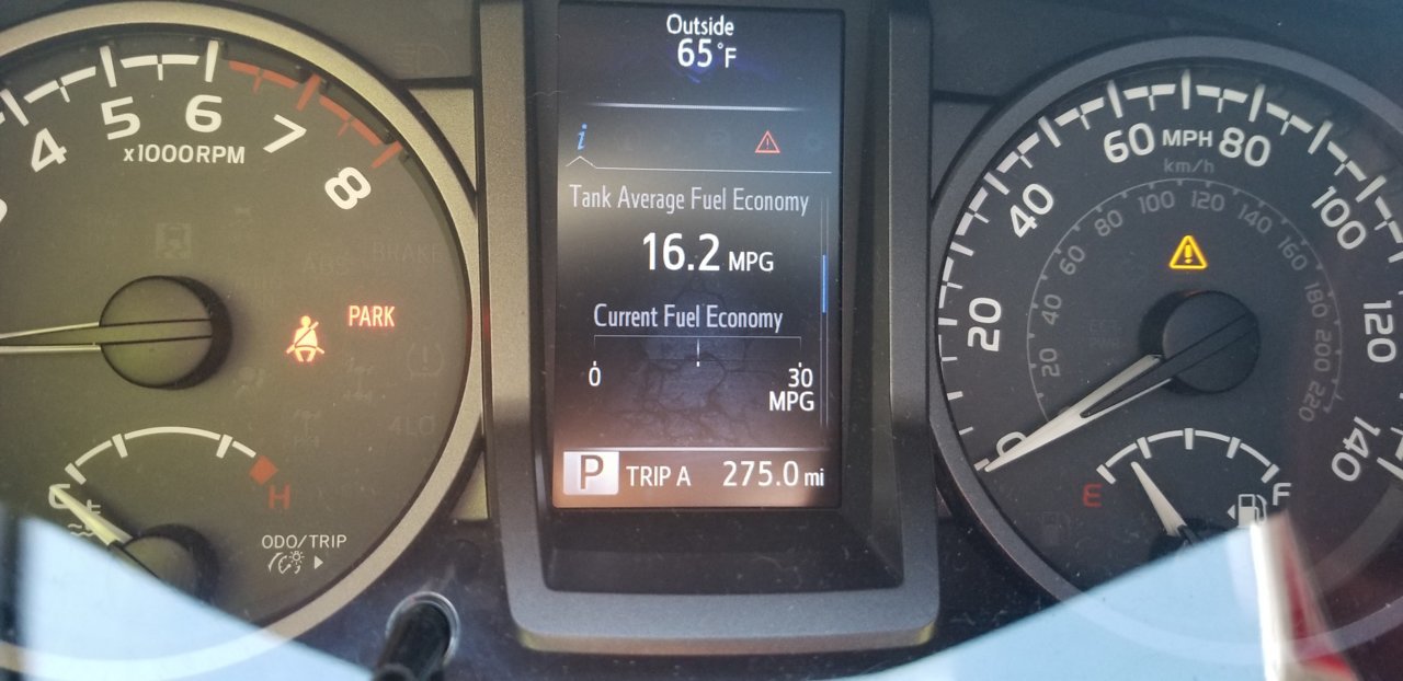

    This is on 87 octane gas. Add in the tire size difference and its 17.17 mpg. When I switch to 91 octane i get 16.75mpg, with a tire correction to 17.75mpg.
    Sorry to burst your bubble. :luvya:

    They're not impressive. I'm just proving you wrong. When you said no one gets above 15mpg with 285s lol.

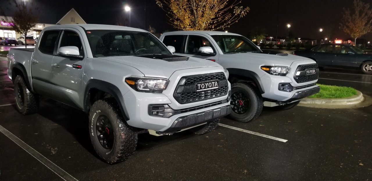

    Acceleration is a little slower. People reporting huge MPG losses also need to realize the truck thinks it's going 7% slower than it actually is, and thus your mpg is reporting 7% lower than actual. My mpg dropped by around 1. The big bonus is the truck handles better on my 285 k02s. More grip, they're stiffer, and much wider. It's better.

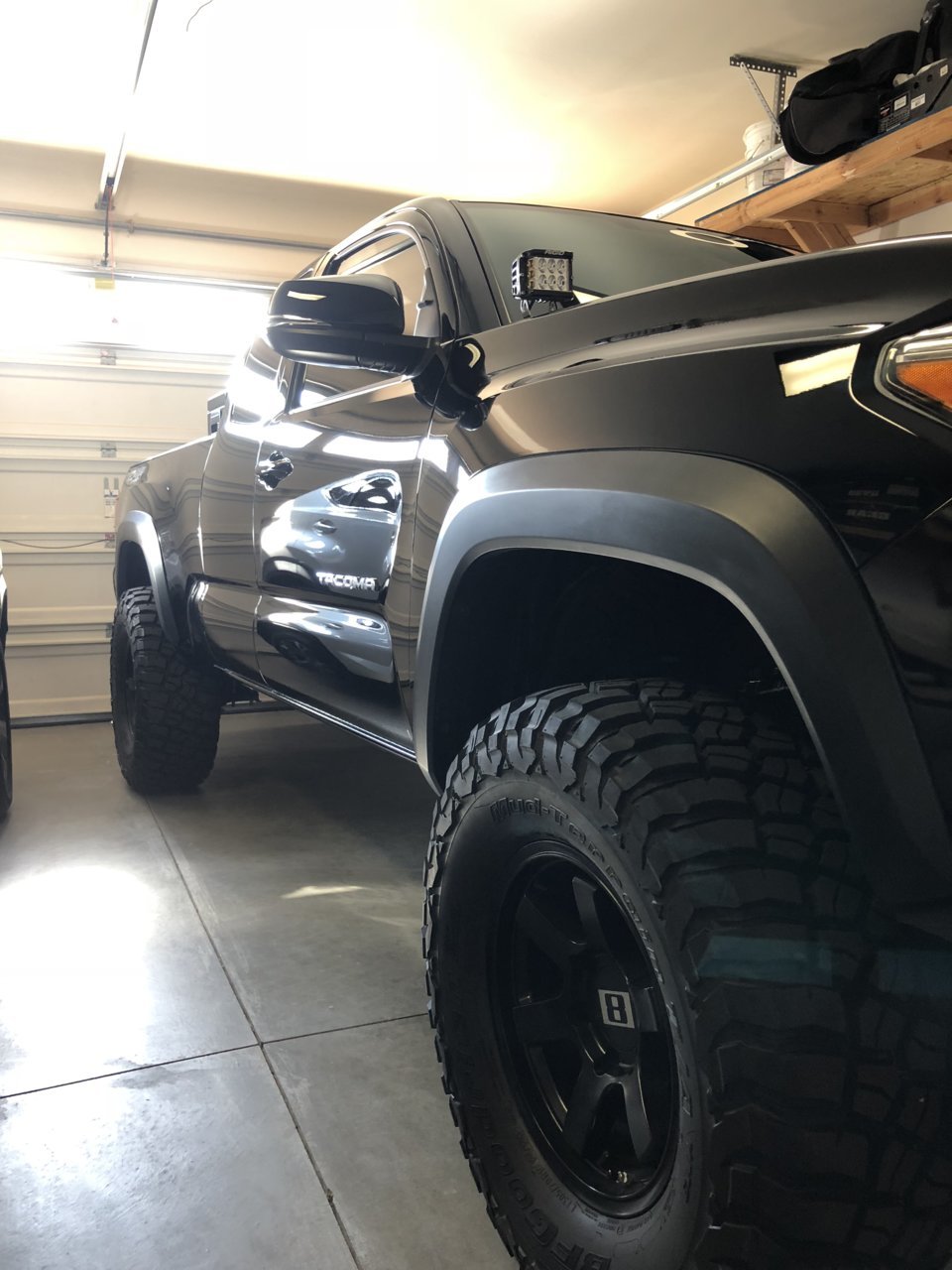

    Go 305s everyone has 285s. And you have the width of 35s. And totally worth it!! If I got 285s I would have always wondered what 305s would have been. That’s just me and in sand they are awesome and at 12psi they float over rocks !
