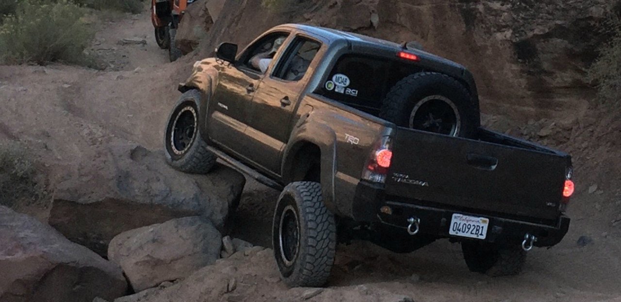

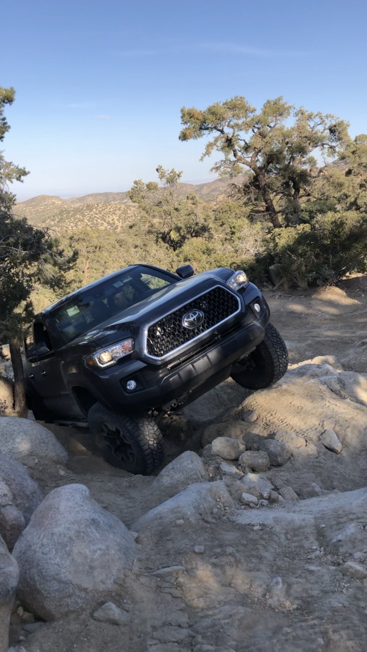

    Tuned Fox 2.5 resi with dsc, JBA HD UCA, total chaos knuckle gussets, rear trd pro fox shocks, Deaver U402 stage 1 rear leafs, archive garage u bolt flip with fox 2.0 air bumps, White knuckle off road rock sliders, BAMF 1/4” steel skids, Magnaflow exhaust, Archive Garage Hammer Hangers, Cbi high clearance rear bumper, 285/75/16 tires.

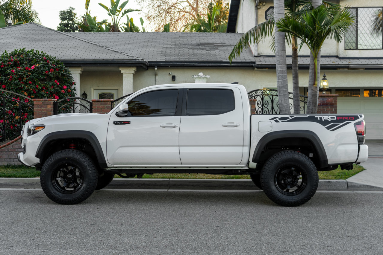

    285/75/16 so worth it. This same spot I would just touch my front bumper climbing up and would rub my diff no matter what line I took, not any more.

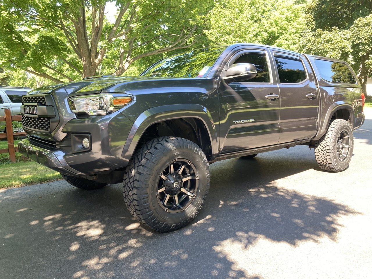

    Bilstein 5100's w/ OME 888's & Deaver AAL, OME Carrier Bearing Drop, SPC UCA's, ECGS Bushing, Method MR305 NV - 18x9, -12mm w/Nitto Ridge Grappler 285/60, Cali Raised Fog Lights, TRD Pro Grill

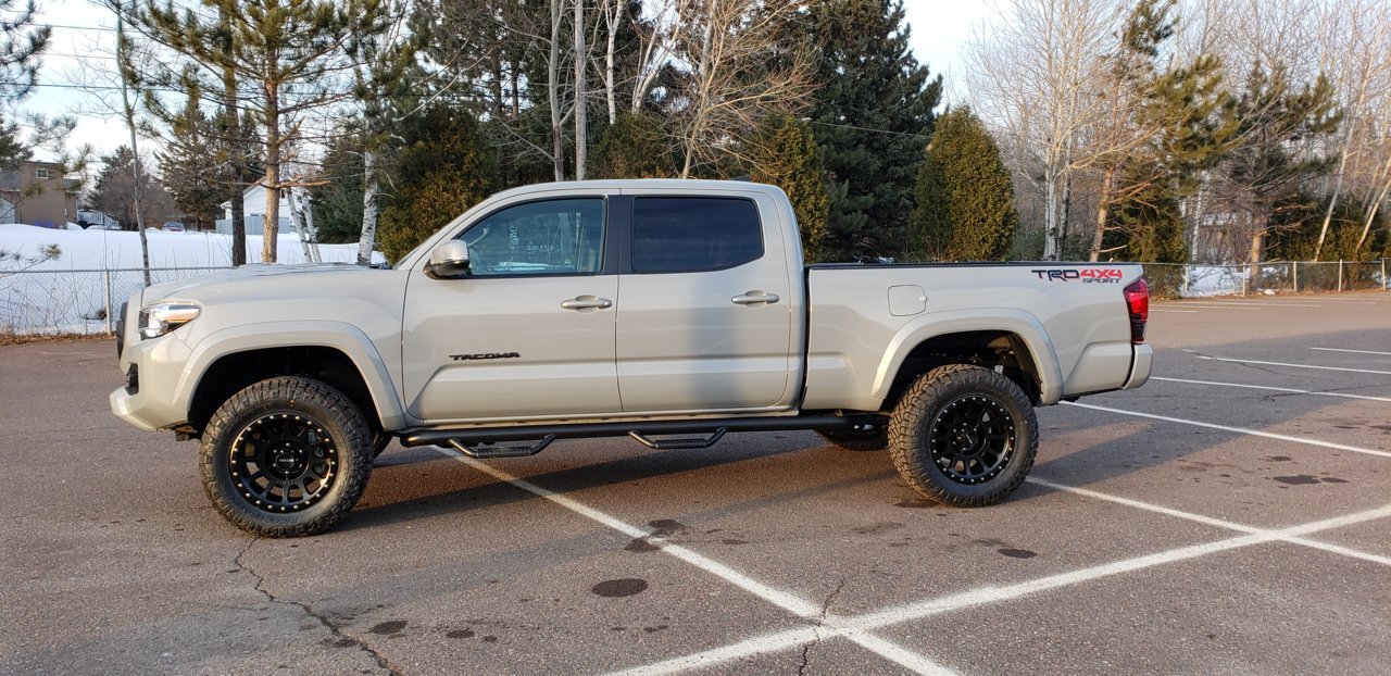

    285/60 on an 18x9 with a -12mm offset. 2.75" lift and lightly rub if turning fast in reverse. Wanted to see what I could get away with before upper control arms. TRD Sport.jpg

    Looks good. I texted you the other day. Want to meet up, I wanna see the 285s.

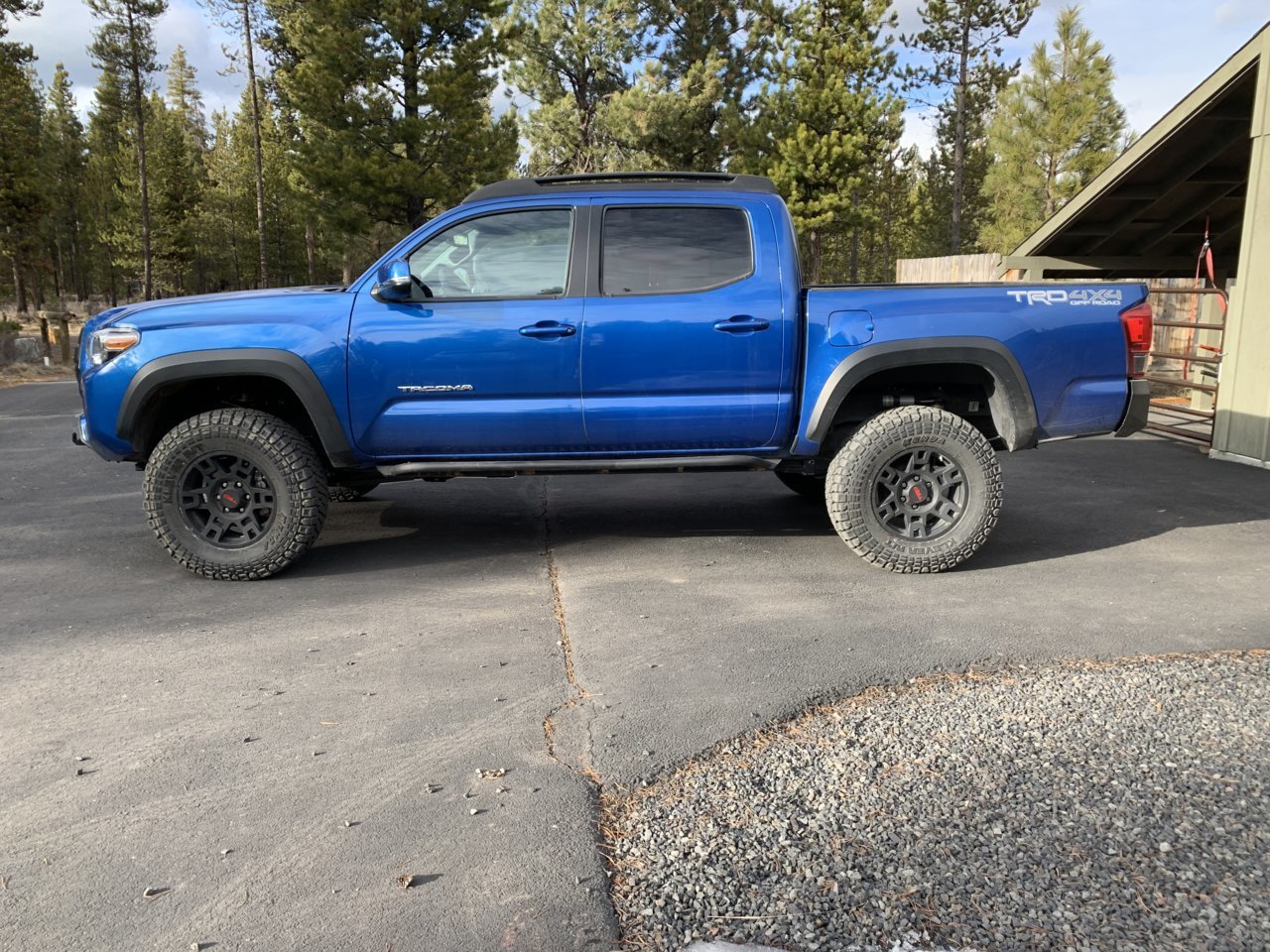

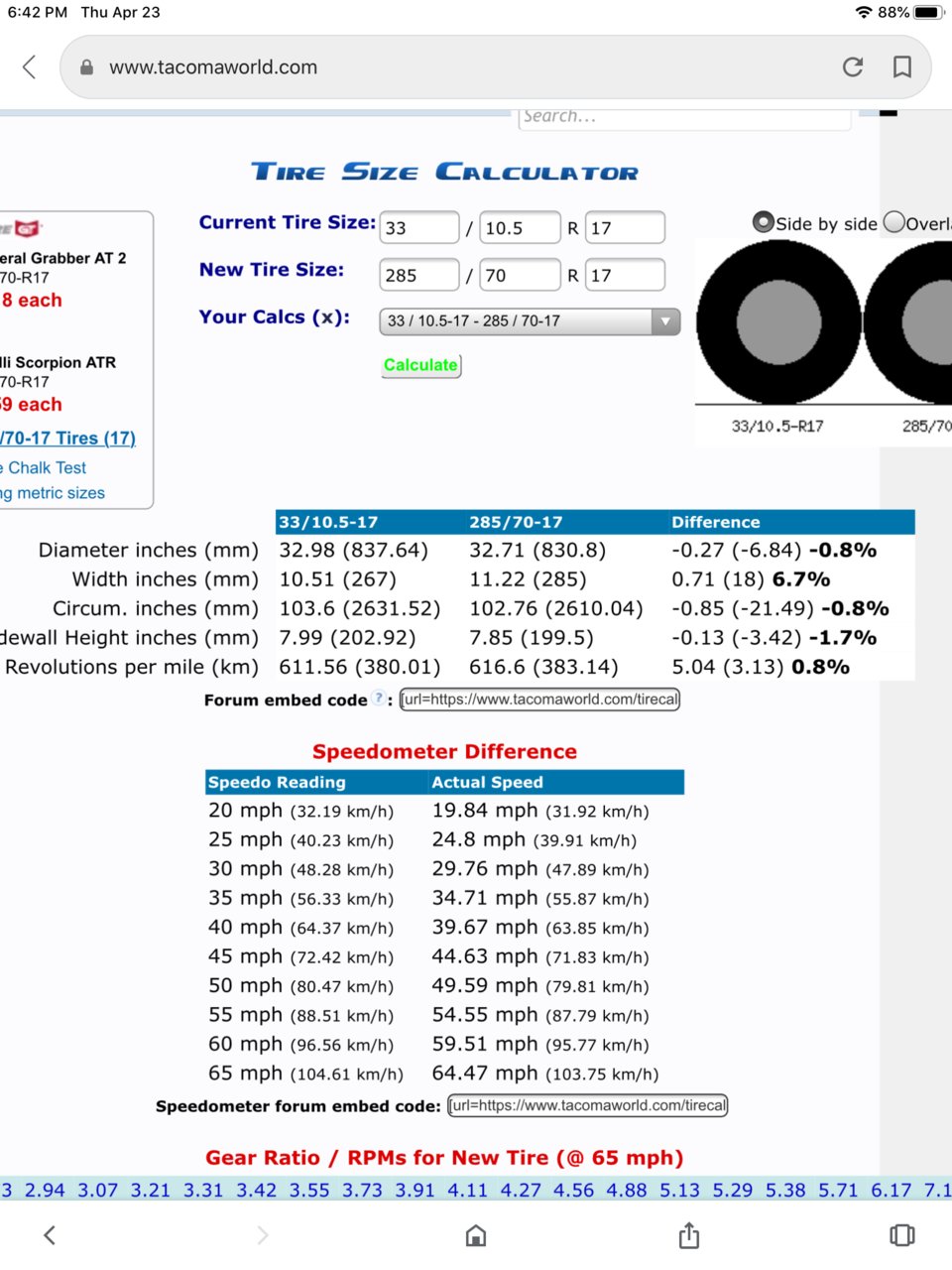

    Don’t forget about a 33/10.5 tire. Love my Kenda’s.DA884B61-01B5-44D5-86F3-6EED806818F5.jpg1FF1F65B-CDCE-499E-AF3D-92DDD1AFE052.jpg

    Wow those look great. How’s the ride quality?

    They rode very similar to the KO2’s I was running before the Kenda’s. Great tire with better snow and wet weather traction versus the KO2. And they do look great! A good tire size for these Tacoma’s as they are very close to the same width as a 265 tire so no rubbing anywhere (no need for a CMC).

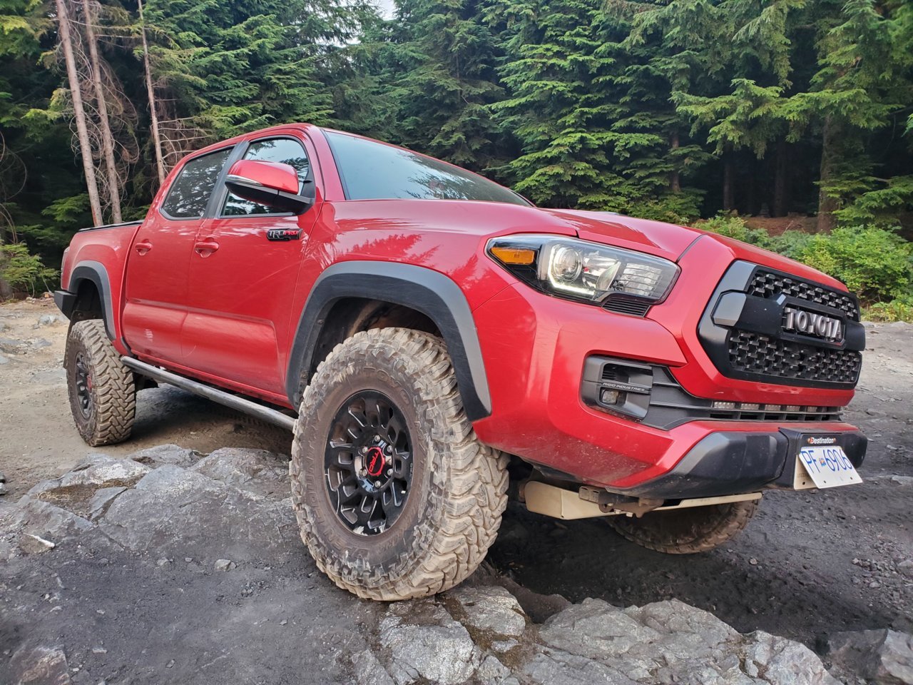

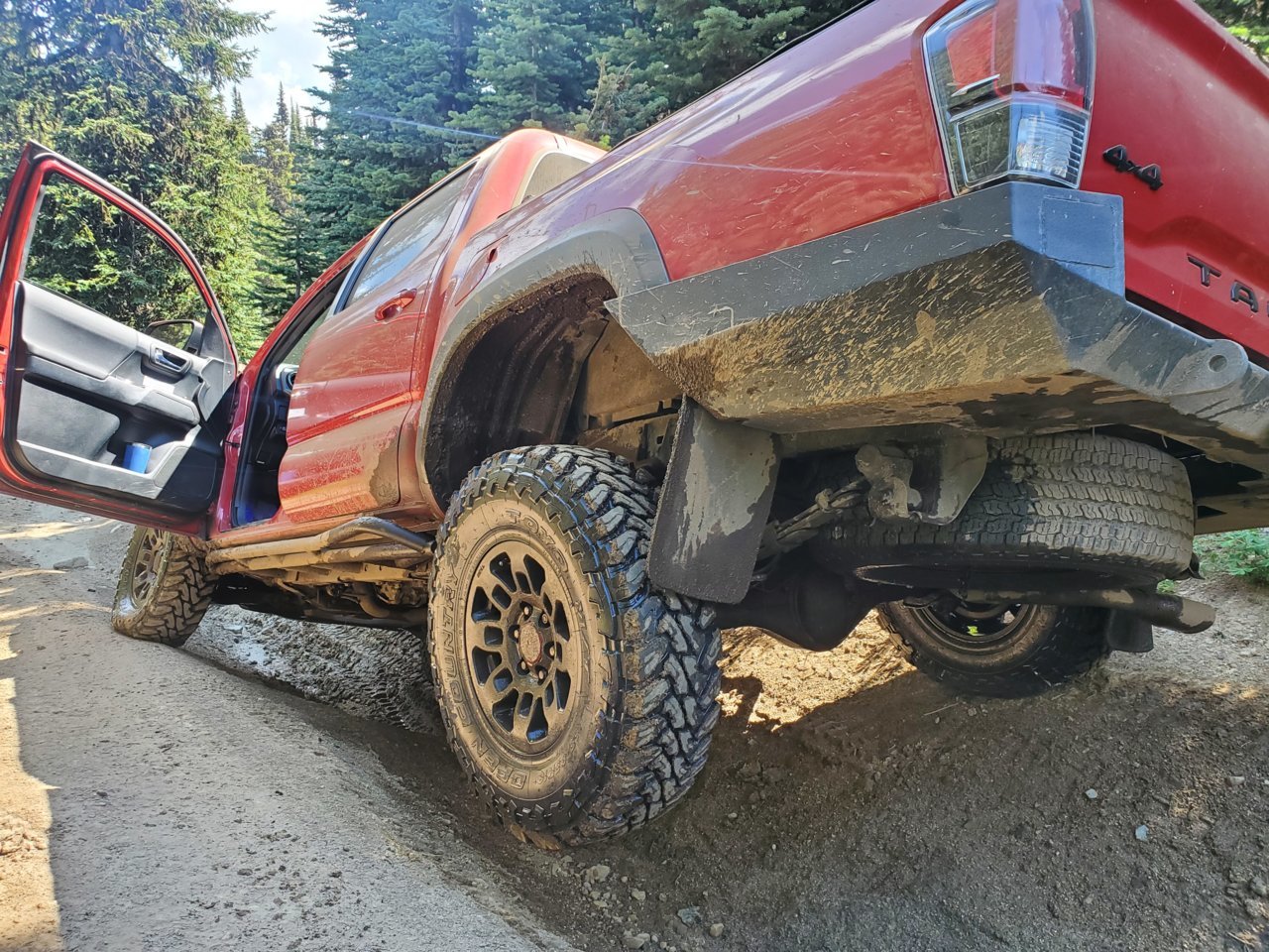

    2017 TRD pro, stock suspension. 255/85/16 toyo MT, E rated. Needed to remove mud flaps and trim fender liners to reduce rubbing. Still get some rubbing under full compression. Daily driving they're alright and offroad they are great. 20210801_202418.jpg 20220821_132425.jpg
