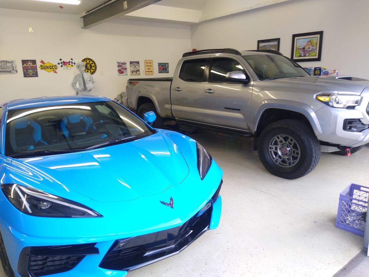

    IMG_20221222_140310731.jpg IMG_20230120_153954409.jpg I was against 285s when I lifted my truck almost 4 years ago. I now have about 20k miles on my truck @ 16k miles on the lift. I was told by the local 4wd shop in our parts that with my set up when they installed the 5100s I could go 285s. Well a few months ago I added a new set of Toyo at3s SL rated and the fit was perfect. I went back to my local off-road shop and had them do an alignment and raise the front 5100s to the 5th perch from the 4th. The ride is so much better but it may be the newly designed Toyo at3s. The aggressive look is what I wanted. So no rubbing, no cab chop or pinch weld needed, still running the factory mud guards, getting 18 plus around town. The same day I had the tune updated to the new KDMAX Pro 9 and still don't feel any loss of power or mps. My Tuner also used an inline calibration from Rough Country and got the speedometer all dialed in. I could not have asked for a better setup than this. So I lucked out, did my research and everything came out perfect, the ride is awesome, no cutting, trimming,good mpgs,no loss of power, retaining factory mud guards and looks awesome. I swear it looks as if my truck came stock from Toyota looking like this as I get asked this sometimes by fellow Tacoma owners.

    Hasn't rubbed since installed and I don't think its going to. But every truck is tweaked a little different, It doesn't seem so in this case.
