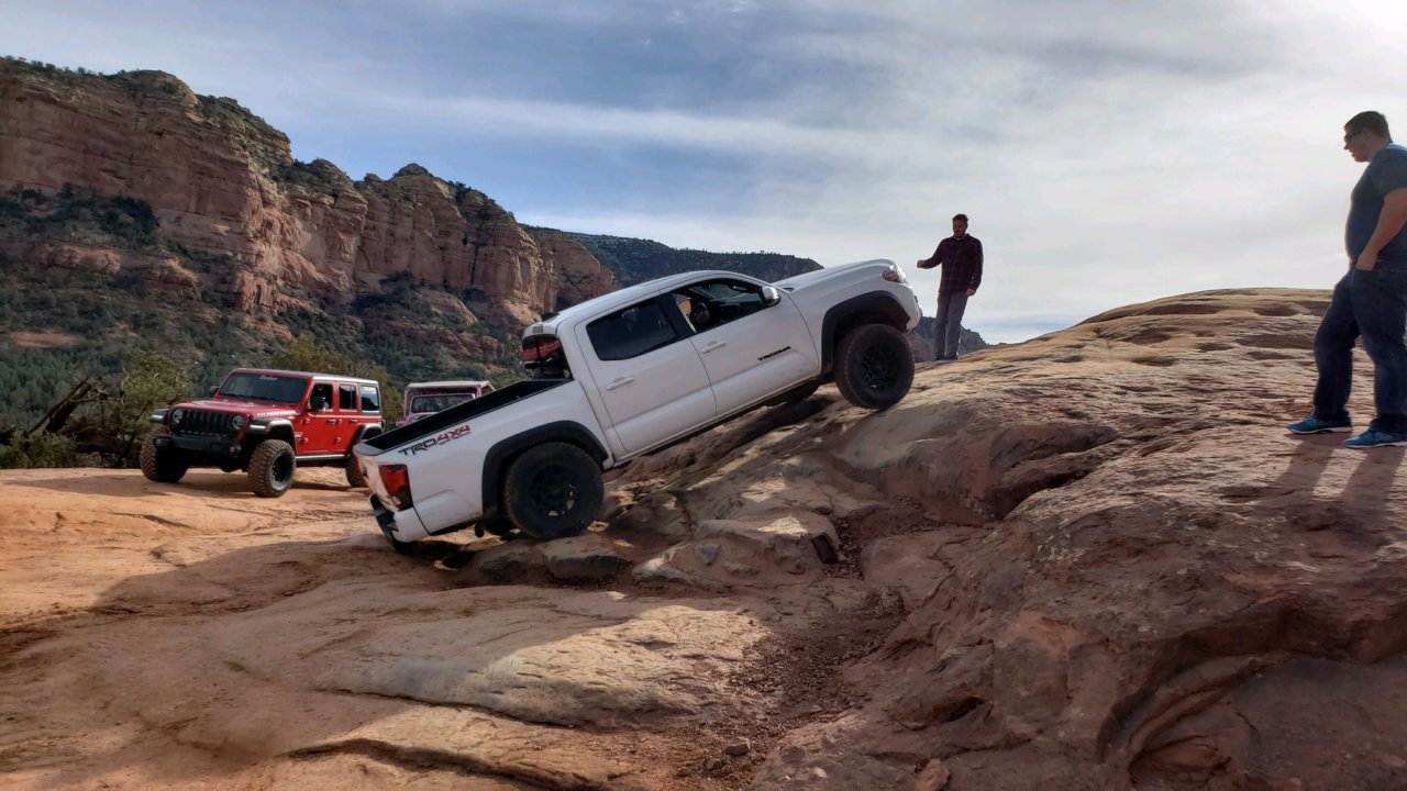

    Stock taco with good tires and front skid.
    I've got close to 6k dirt miles out of 35k total miles on the truck. You'd be surprised what a stock TRD or will do. Biggest issue will be clearance my front skid shows that but know your trucks limits pick a solid line and air down. Only after 5 years of hard use did I finally upgrade to Fox 2.5 dsc front/rear. Imo if you're going to replace the suspension and actually wheel buy once cry once. In the 5 years I stayed stock I watched friends go through 2-3 suspension changes and spend a lot of money doing so. And went 95% of the places they did. 20191102_123729.jpg 20190603_171520.jpg 20190112_111610.jpg 20230606_085713.jpg 20190603_165642.jpg 20191130_165436.jpg FB_IMG_1681922172596.jpg FB_IMG_1681922176620.jpg

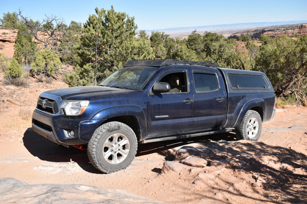

    I know mine is a 2nd gen, but still applies. I went out to Moab on stock suspension with 125K on it. I bought sliders and skids first(and used the shit out of them :rofl:). I never had plans to lift my truck...until I did :rofl:
    These things are pretty good stock.
