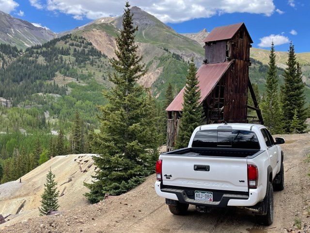

    Link to what I did getting 5100's 2" lift and one size bigger tires.
    https://www.tacomaworld.com/threads/2022-tacoma-trail-edition-4×4.723589/page-55#post-28391533
    I have the 22' SR5 Trail and wanted (not needed) better suspension than the stock SR5 shocks along with beefier tires. Hindsight is yes it's much better than stock however shoulda just waited till I needed new tires and done it then, but I money burning a hole in my pocket so it's done.
    With the type of off roading I do this is more than I'll need as my rock crawling phase was over when I sold my FJ80 Land Cruiser I'm older now and some one else can have that challenge.
