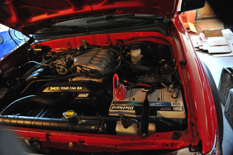

    Yeah the battery size numbers are just age old conventions and don't have any meaning in terms of capacity. I just got the biggest I could fit/afford in the space available. If you pull the plastic box spacer out you can (I could) fit a 31 series in the stock location. The battery is so heavy though that I got a cage to mount it more securely.
    I thought I had a pic of the stock mount with 31 series but here is someone else who did it:
