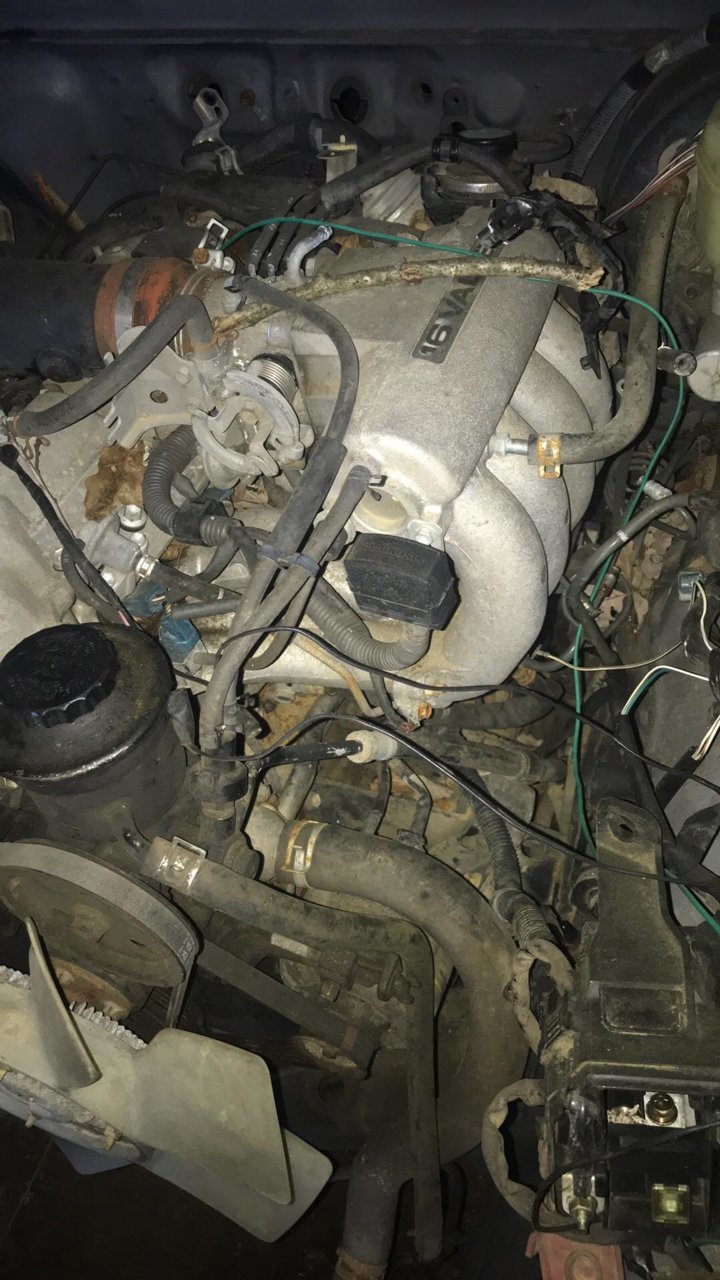

    I've finally found a donor motor out of a 95 but I'm not sure if its going to be compatible with my 96. So before I drive almost 3 hours one way to buy this motor that is supposed to have 100k on it I need to know a few things. My current motor is the 3rz-fe and the guy is telling me that all the 2.7's are interchangeable. True? I've read differently and especially due to coil vs distributor setups. These are the markings that he sent to me off of the motor. Can anyone please translate these to me and let me know if it is indeed going to work for me?
    z-1083-93 z-83-z-n83-93 2499380143 (sticker on motor)

    Got a pic of the donor truck or engine? It's pretty easy to tell the difference between 3rz and 22 re or tacoma vs pickup.

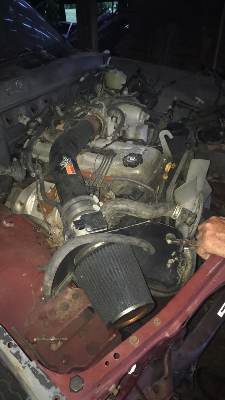

    It looks just like my 3rz and not a 22re but the numbering he sent and not saying it was a 3rz threw me off. Also I read up on something saying there was a updated variation to the 3rz-fe being 3rz-fe-?? and I want to make positive that I get some advice from you guys if there were sub models of the 3rz that I know for certain and dont screw myself. Trying to download the picture now..

  13. Jun 22, 2018 at 4:07 PM
    90Woody09
    90Woody09 [OP] Member
    May 22, 2018
    #254220
    9
    1996 Gold Tacoma single cab 4x4
    3rz?

    Look like a 3rz to me

    Is it 2wd 5lug or 2wd/4WD 6 lug?

    Also, that little tag on the valve cover should say wether its a 2r, or 3r
    Bolt patterns are the same for engine mount points on the block, and as well as bellhousing mounting points

    battery tray on the right side? That is a 89 to 95 truck.

    If the truck has 6 lugs it's a 3rz.. if it has 5 lugs, it's a 2rz. Also, 2rz/3rz is cast into the driver side of the block. Look through the driver side fender well. Should see it.

    100% is a Tacoma, and not a 89-95 pickup.

    Your kidding right? look at the fire wall, vin plate in the middle, heater valve in an odd position, and op say's,
    "There is where my problem begins. This is a barn find restoration project with with cab, frame, motor etc pieced together from all sorts of years. I'm interested in the motor but not sure from the lettering he gave me, and stating that its a 95 if it would work on my 96."
    cold air do not sit on battery box. This barn find is a mess of pieces from different toyotas. Whith the 2rz and 3rz being so similar, I wold look at the block plate like you point out above.
