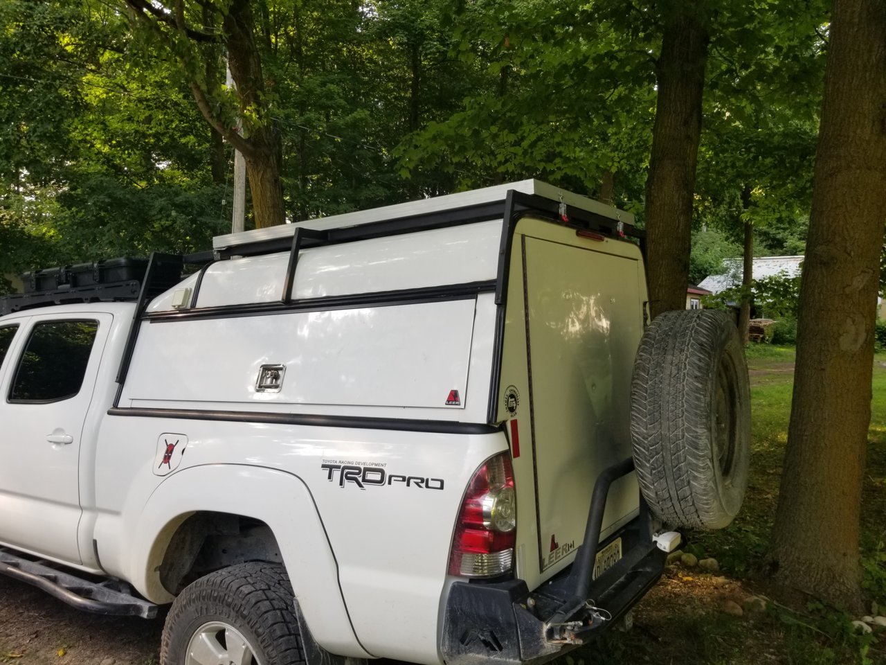

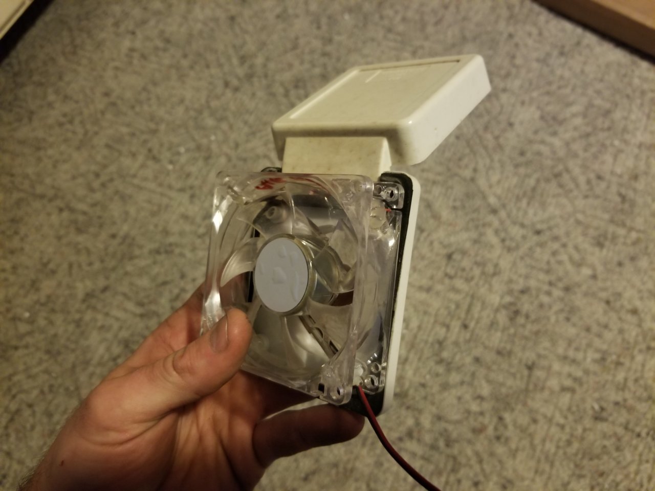

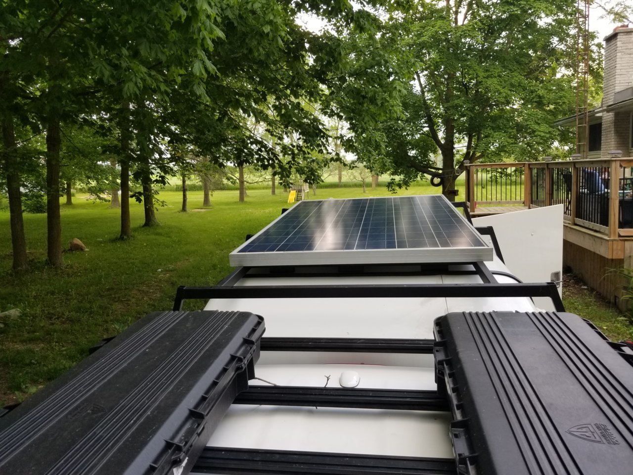

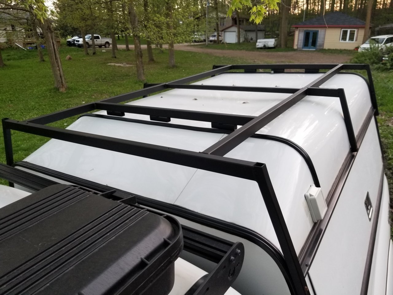

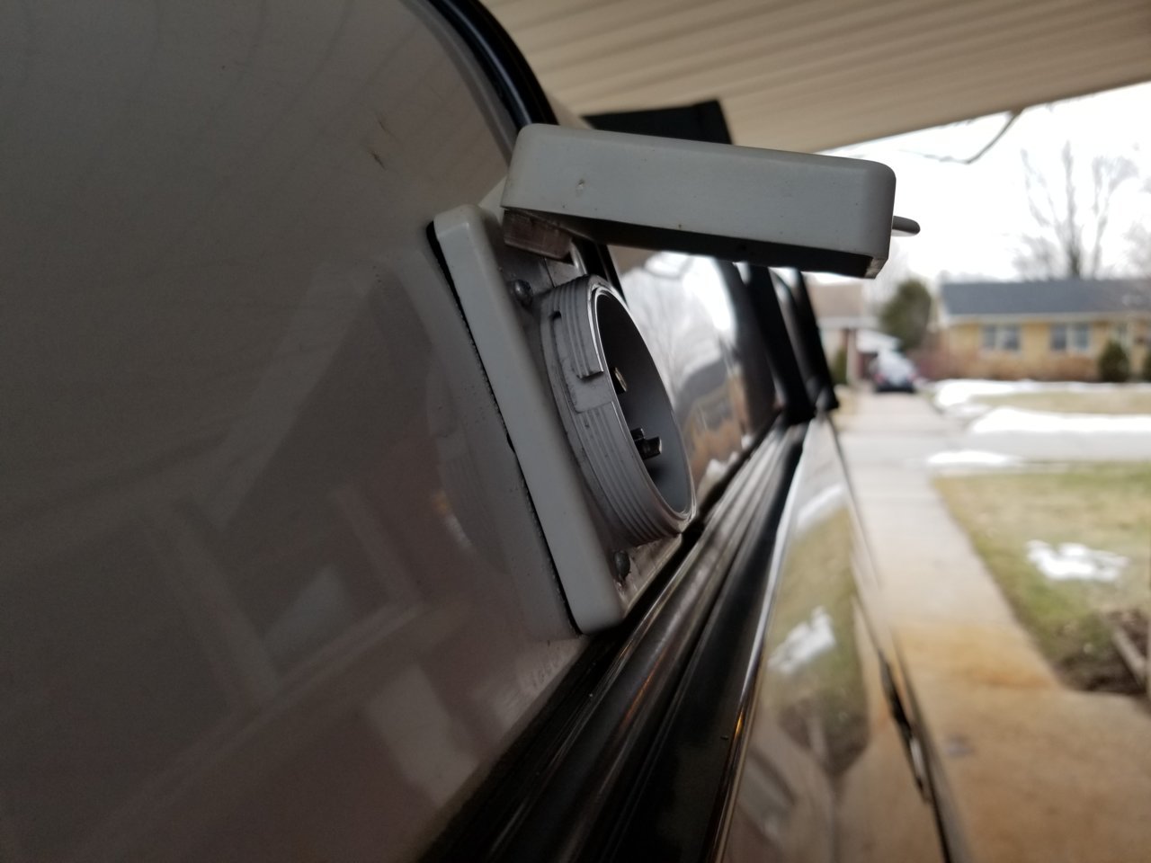

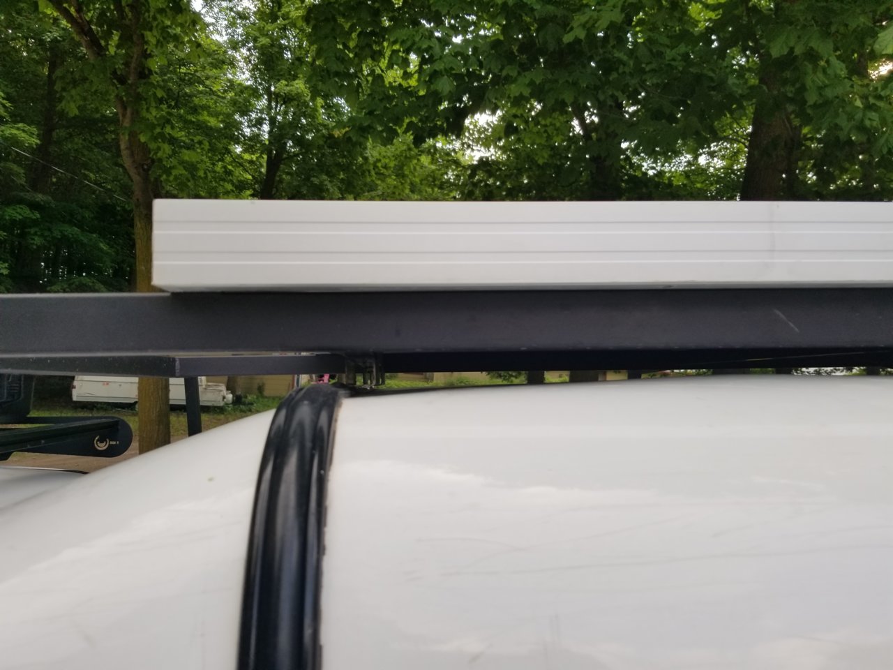

    Thanks for the great direction. To give some better visuals the little shore power cover will probably be retrofitted with the fan and theres a 220w solar panel sitting on the rail. While its massive I got a screaming deal for it so fitting a fantastic fan may not work unless it's on the down sloped portion towards the front of he cap

    Ugh, not sure what you could do about mounting that fan on the front. Face it one way and you risk having the wind catch it if you should forget to crank it all the way down, put it the other and you're probably going to get splash back when it's open and raining. I know they make some side vents for boats and RVs- a quick image search showed this too, https://www.dhgate.com/product/tytxrv-caravan-motorhome-trailer-side-air/523302458.html#seo=WAP, which looked kind of interesting and looks like it uses low voltage computer fans. Finest Chinesium quality with a side of corona virus but something like that might work on the side above the doors, maybe? I wonder how much whistling you'd get with it on the side too.

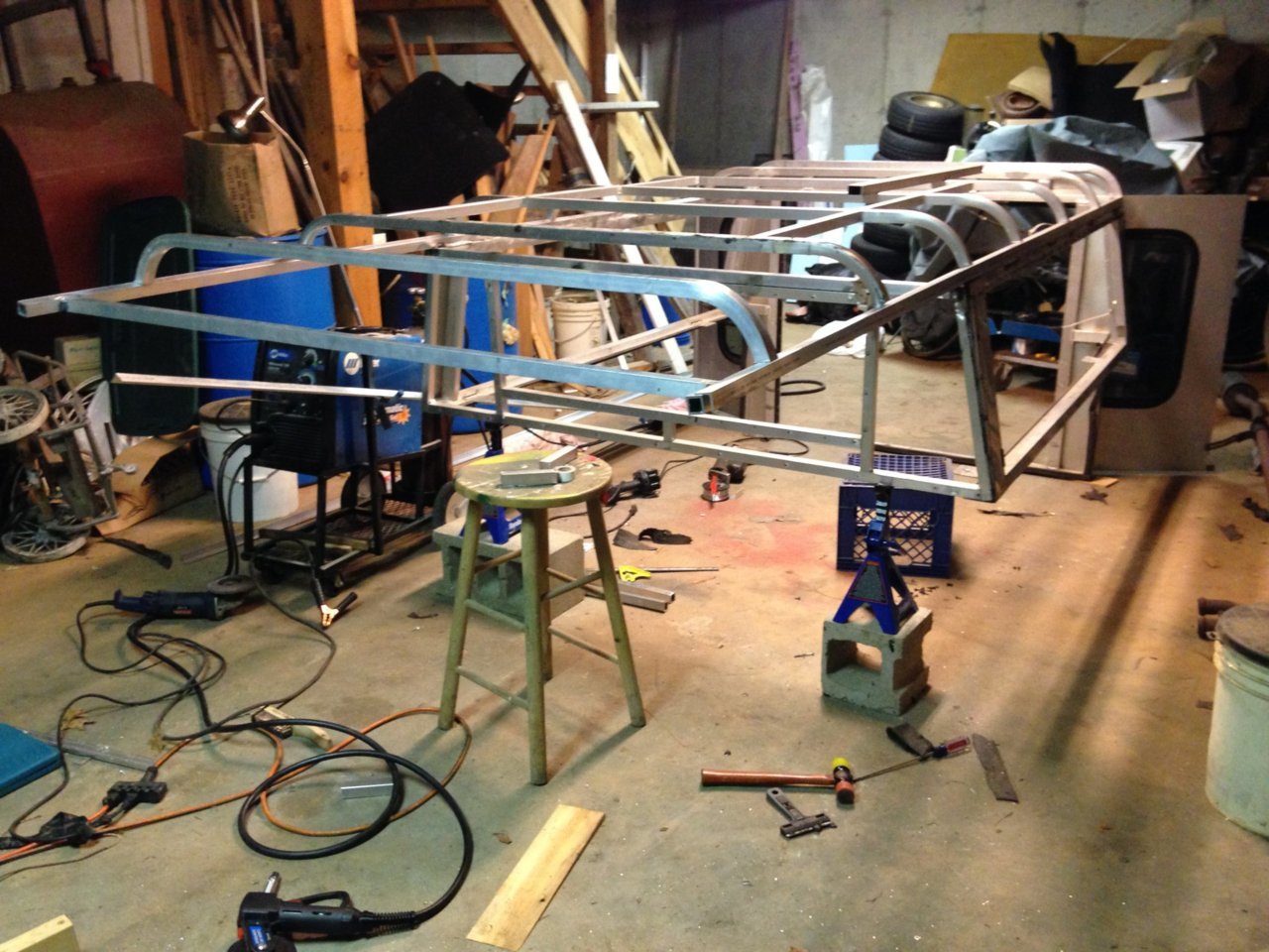

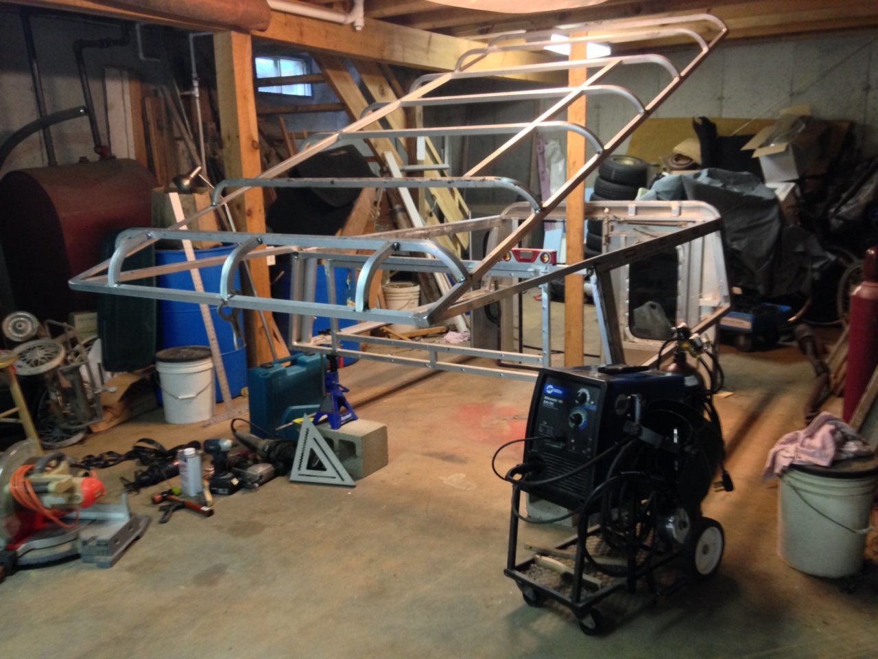

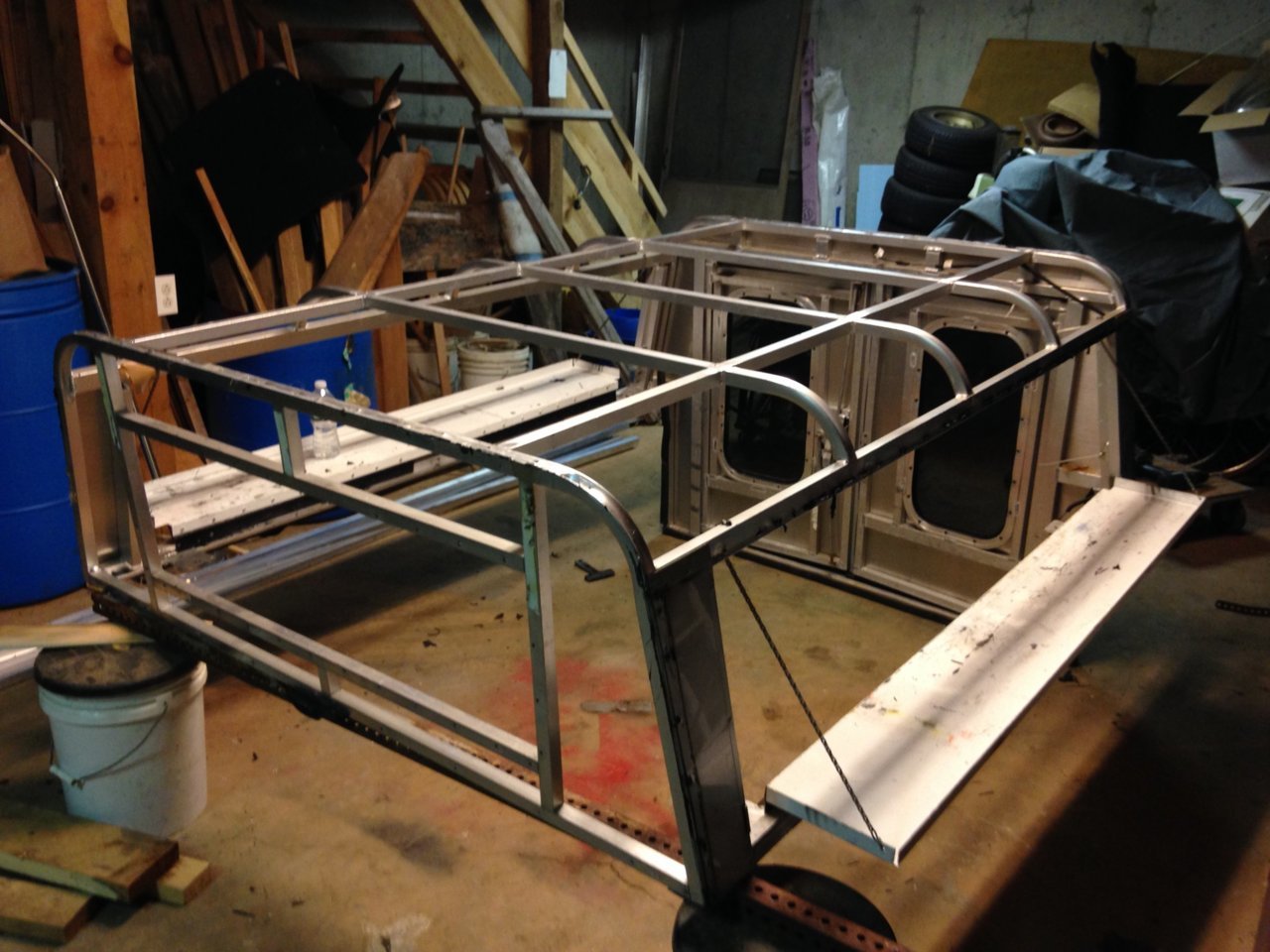

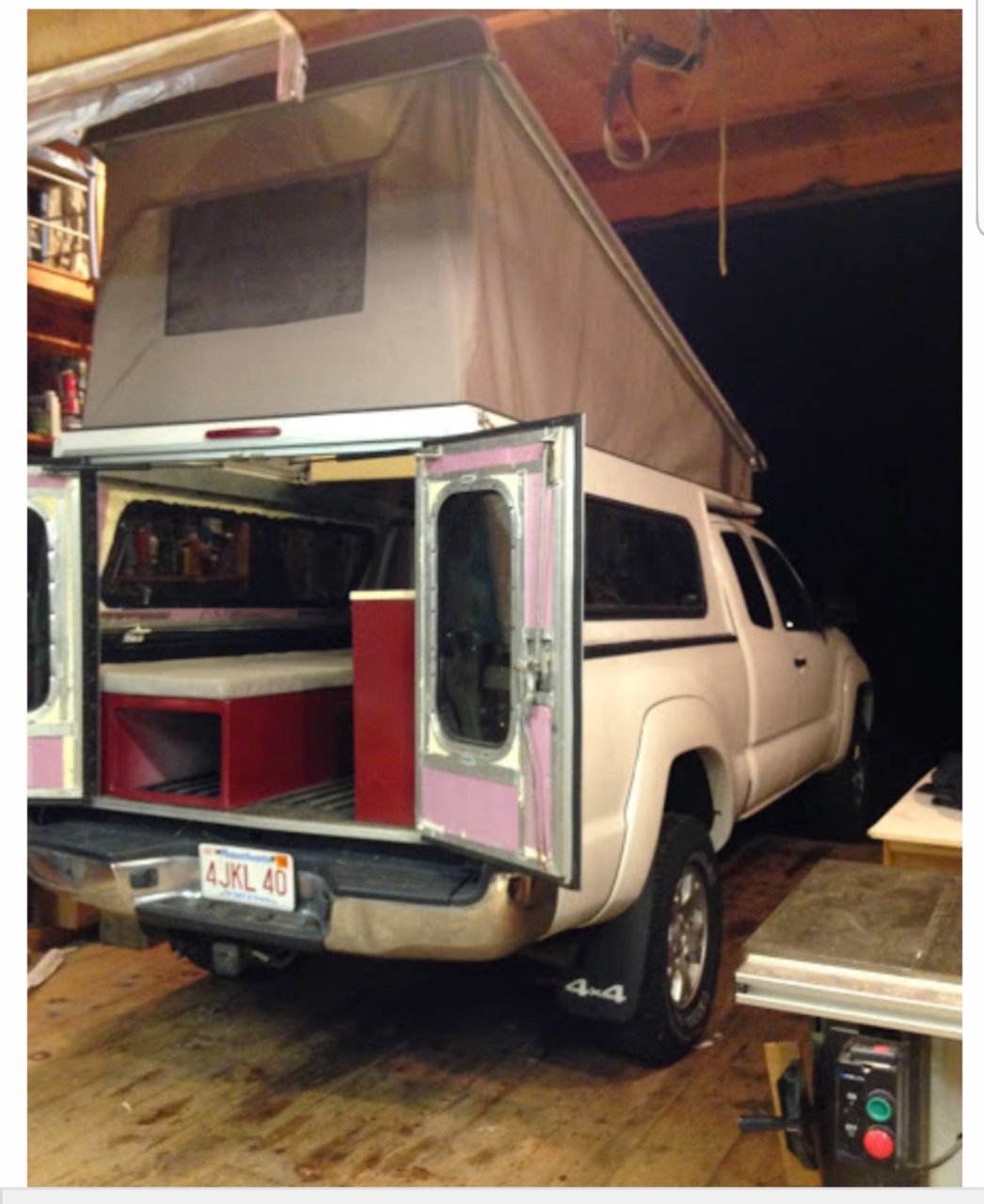

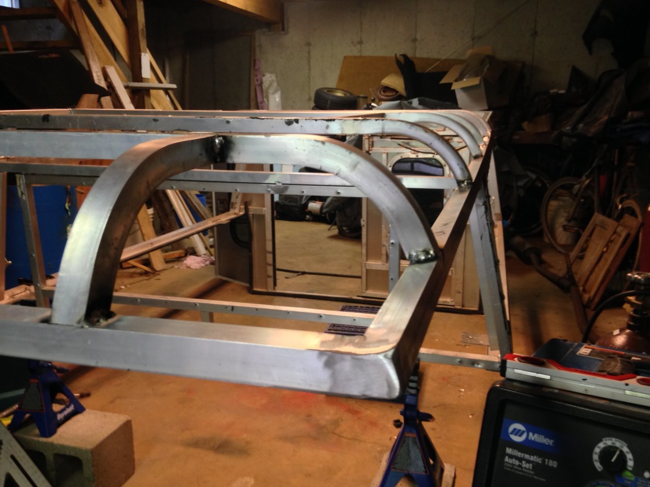

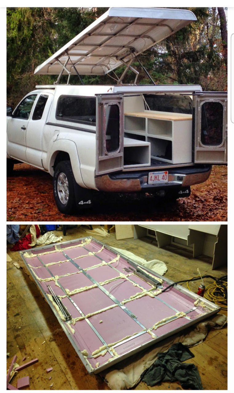

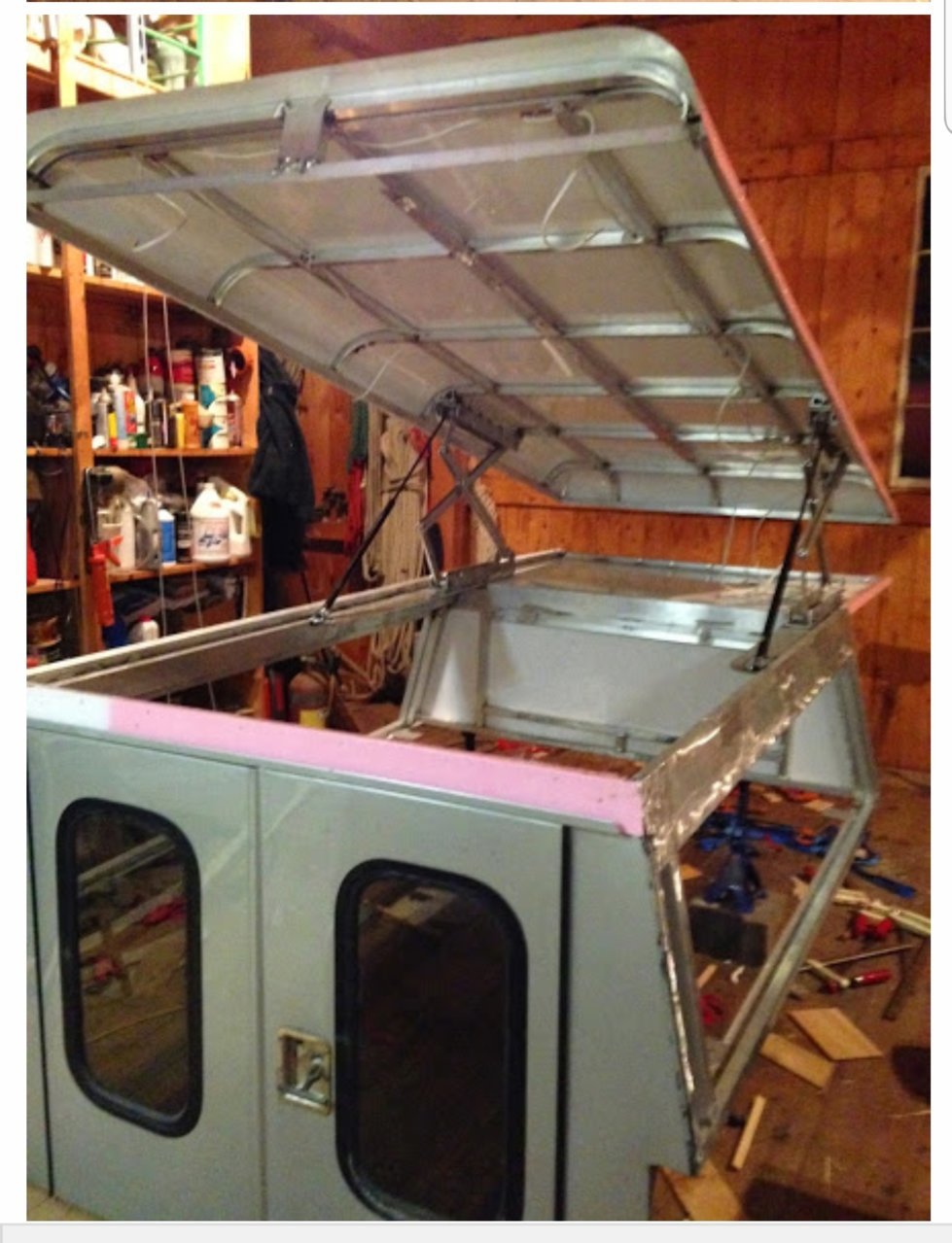

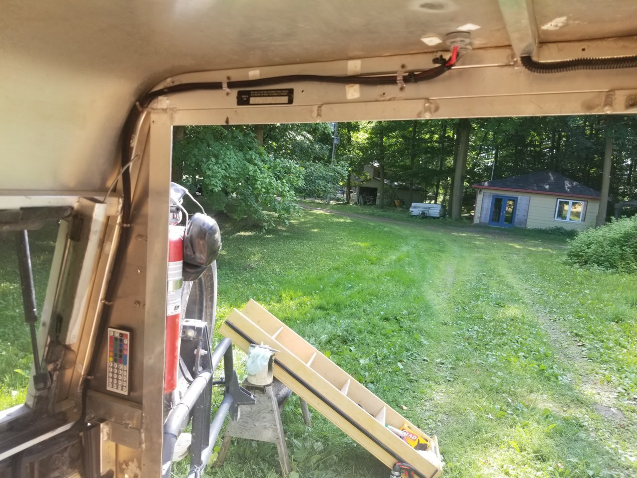

    A catch 22 right? ultimately when i get a set up going and a couple years of experience welding aluminum, this is what I wouldnt mind creating out of my existing cap
    Screenshot_20191209-122244_Chrome.jpg 20191209_121827.jpgScreenshot_20191209-121138_Chrome.jpg 20191209_121631.jpg
    Until then I feel as if insulating it and adding a fan at a time for ventilation / air flow would hold me over. After all I got this cap used for 425 bucks. Notice the green duct tape sealing off the hole that was existant from the previous owner lol
    Also super duper appreciate the input about those side vent, could probably tuck it forward where the back window would normally sit. Seems like it would give me enough air flow.

    couldn't you run the solar panel closer to the cab (over the slanted part) and run the fan towards the back?

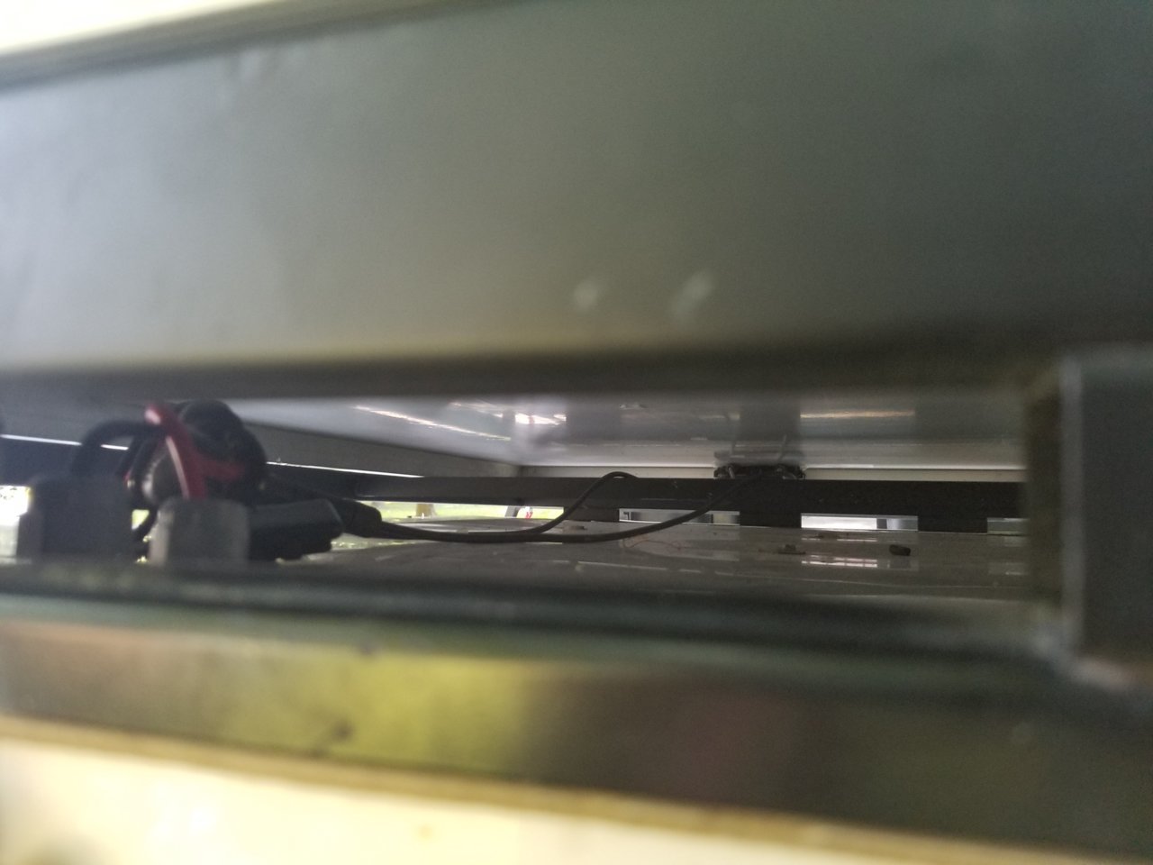

    ya potential for that, relocate some of my tie downs but an option, also what sits towards the back are my cables for the solar

    I've got that same thread tagged and saved a bunch of his pictures as well; shame he disappeared, I posted asking about updates a couple of times but I don't think he's been back. Did you save his drawings for the scissor hinge too? I've got it if you didn't.

    I might of.. I did locate it on expedition portal BUT I'd be more than willing to accept your kind generosity in publication sharing!
    EDIT: credit where credit is due, I stumbled upon his build thread on ExPo and found the PDF
    Thread: https://expeditionportal.com/forum/threads/tacoma-aluminum-pop-up.137366/
    Blueprints::https://expeditionportal.com/forum/attachments/camper-pdf-pdf.266432/

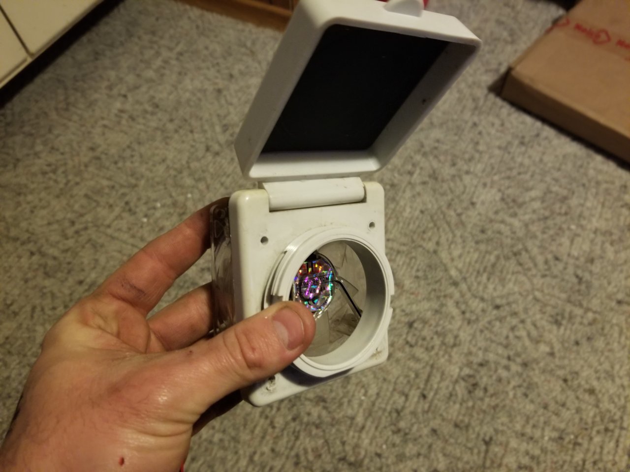

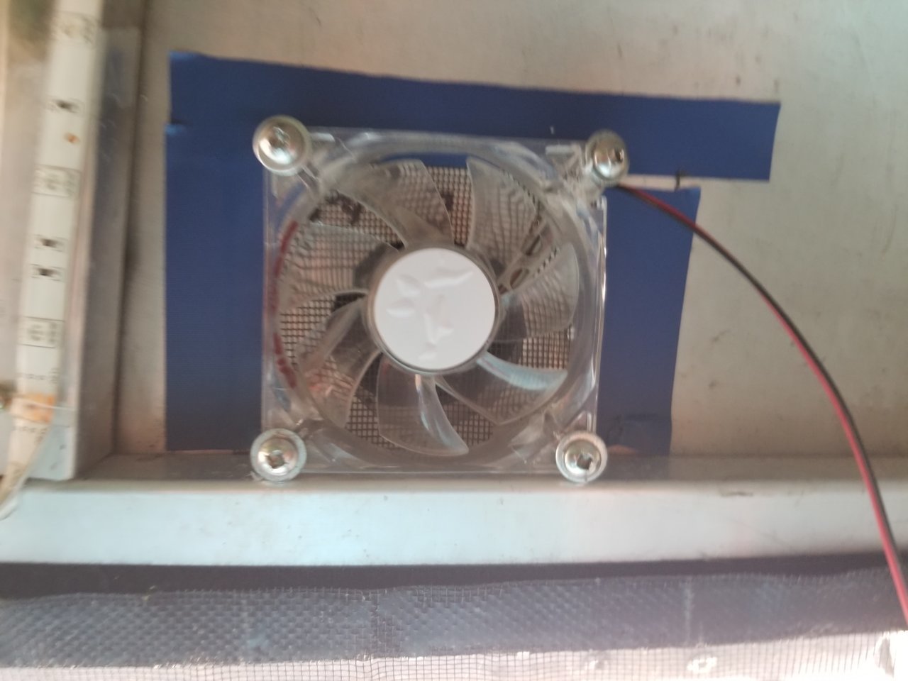

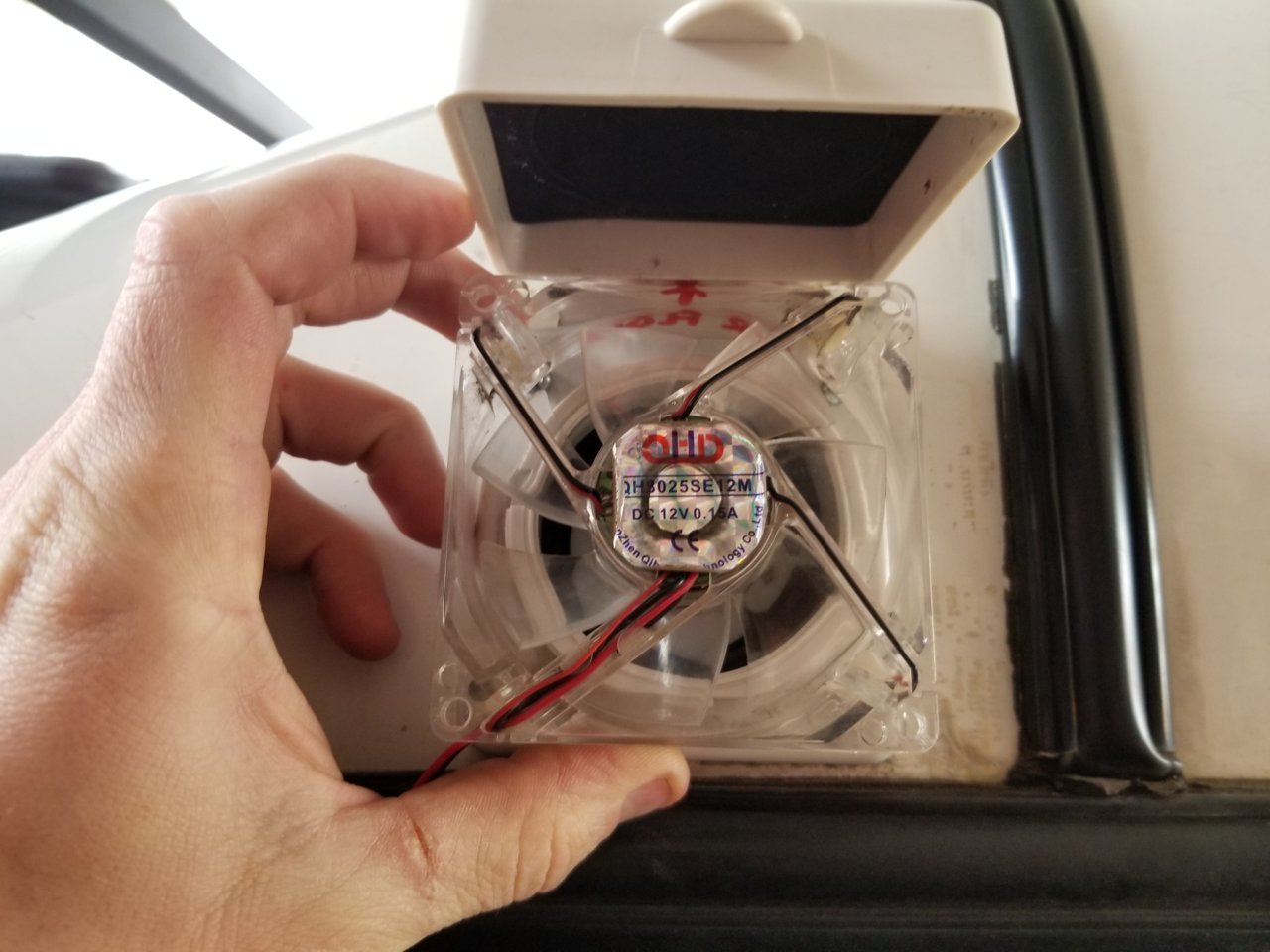

    Better visuals on what I was referring to earlier. Only difference is the fan would be located on he interior of the cap. Need to decide if I want to draw in or push out. I know from some courses I've been apart of the drawing in to ventilate is much more efficient

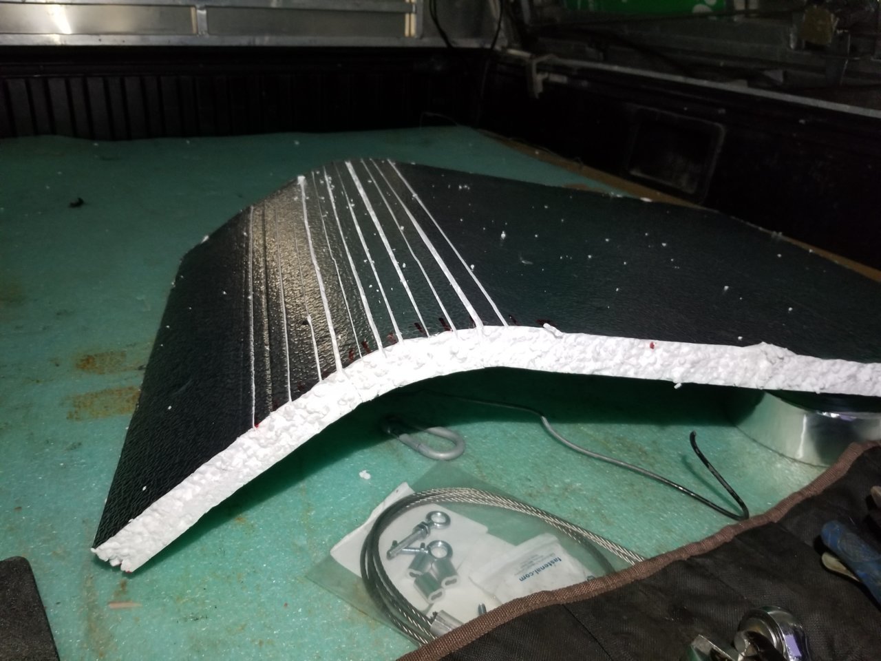

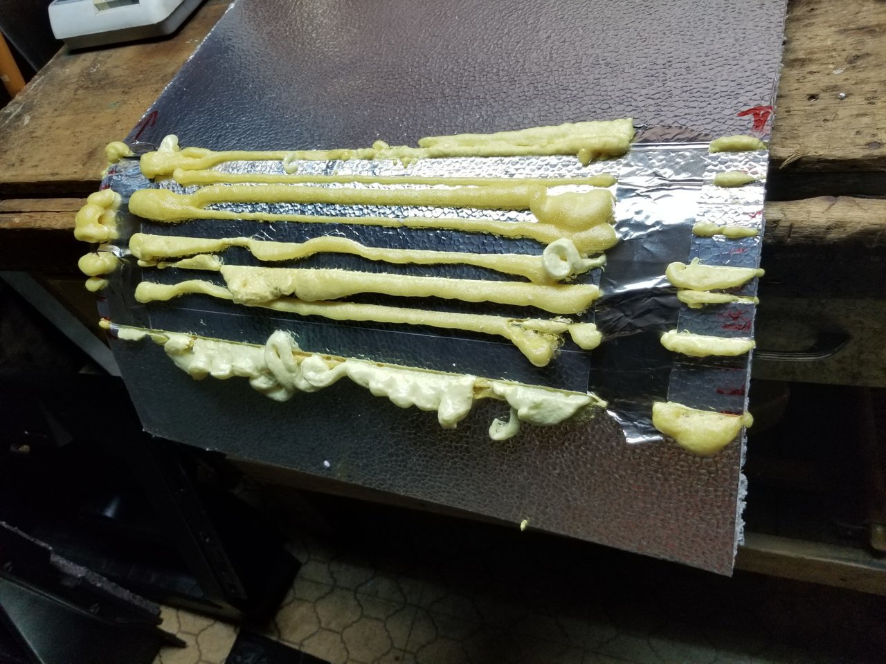

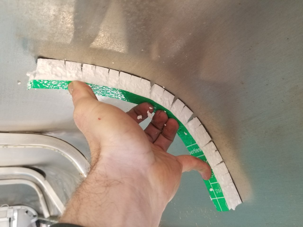

    Here's a little of what I've been up to since we last discussed. Opted with fan pushing hot air out since here are gaps where cool air can come in. And a R3.75 insulation

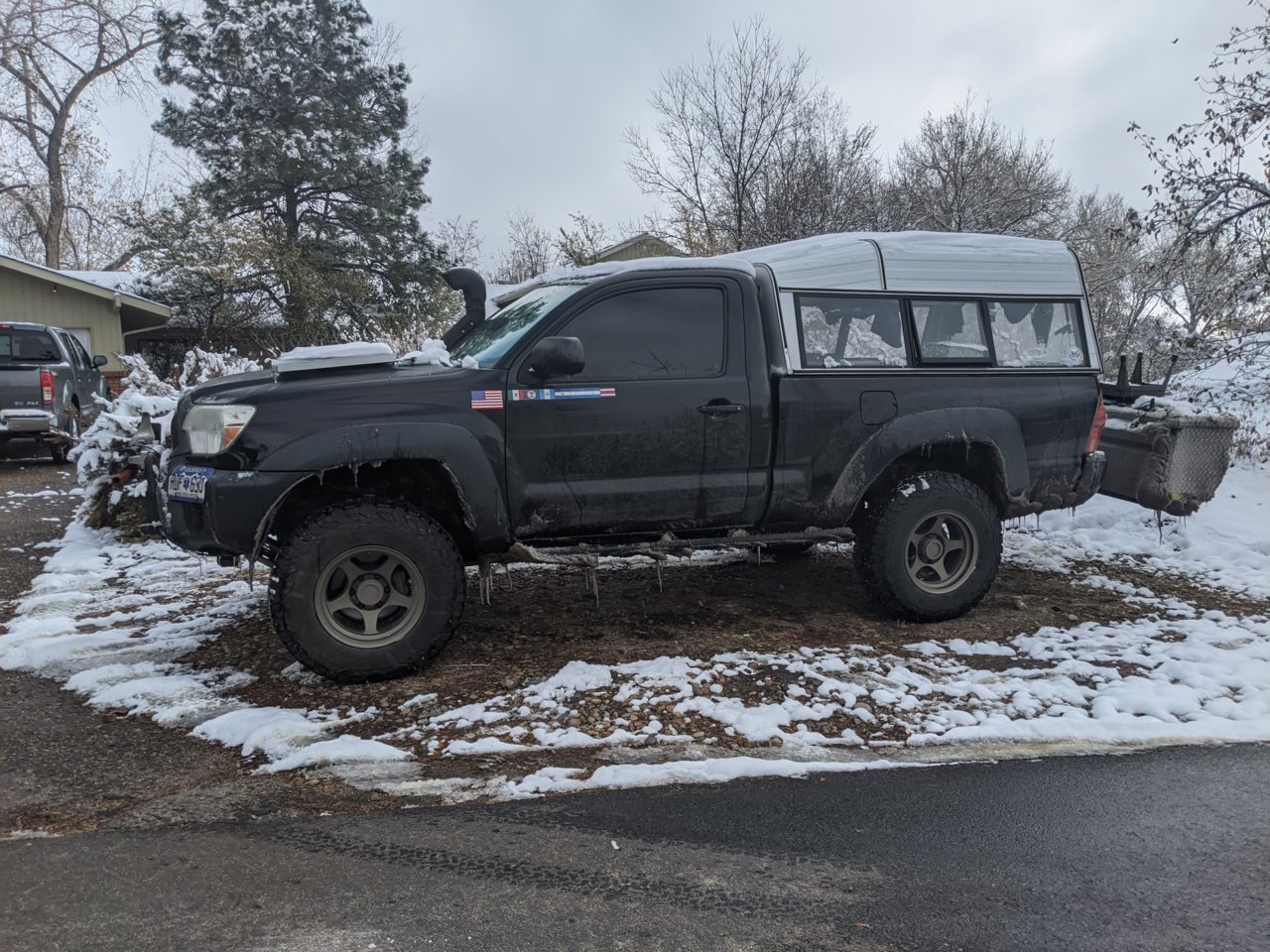

    Looks good! How has it worked out? I just picked up a similar topper, and plan to insulate it.PXL_20201110_171635734.jpg
