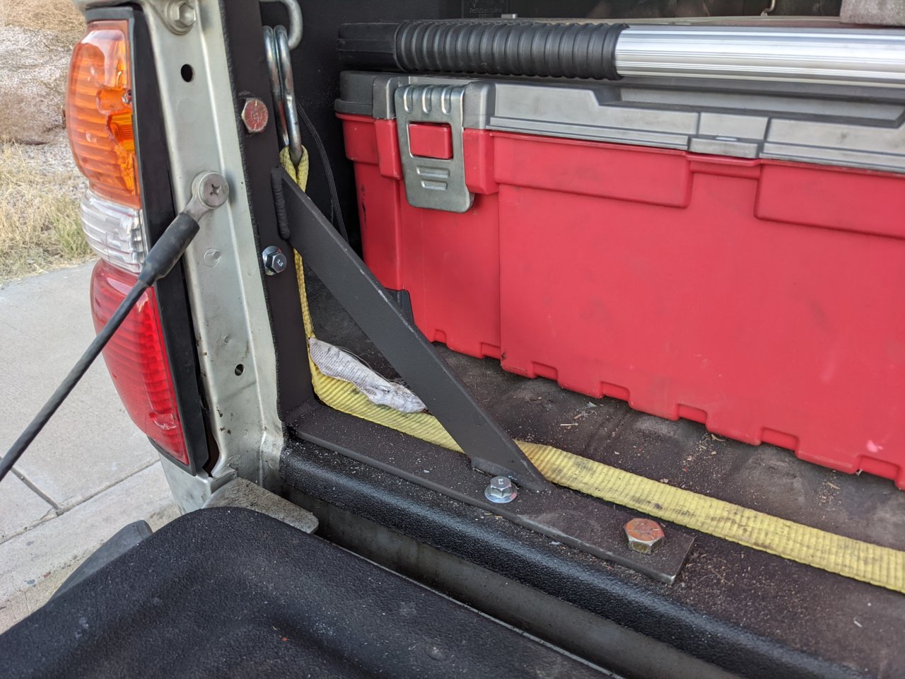

    I only said that cause I only got into welding recently, and already made 2 sets really fast. Not hard at all and materials were cheap.
    Figured anyone with minimal welding skill could easily make you some.
    Just no 2nd or 3rd Gens around for me to mock up.

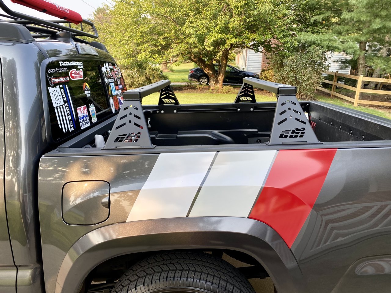

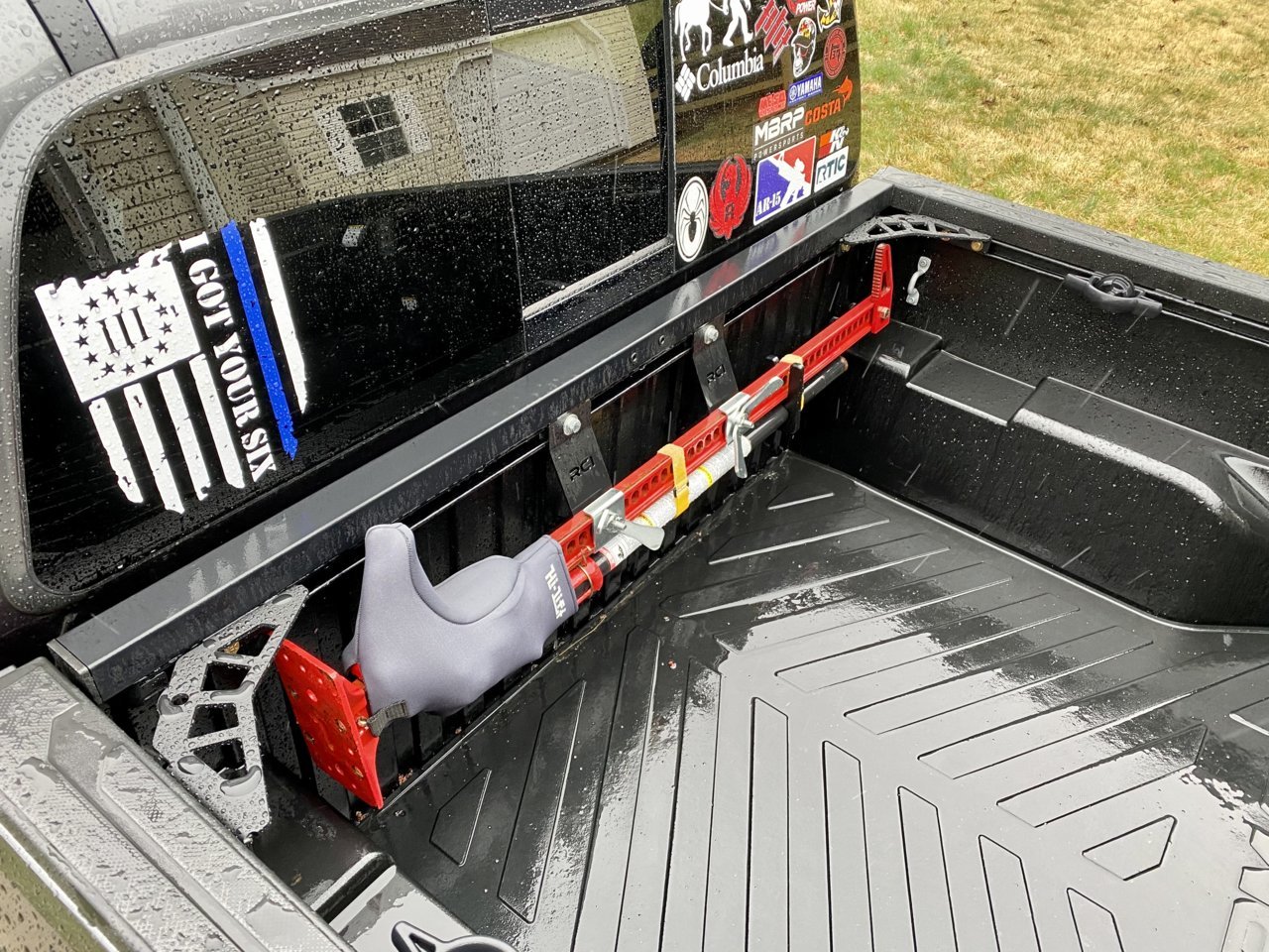

    4x the protection!! 5FC19786-6FAC-40DD-AC4B-CE3A415B0ACB.jpg 8F635325-6E7C-49AF-A42C-68F9946E56CA.jpg 3C771F34-C664-4373-8F19-10C85D075755.jpg

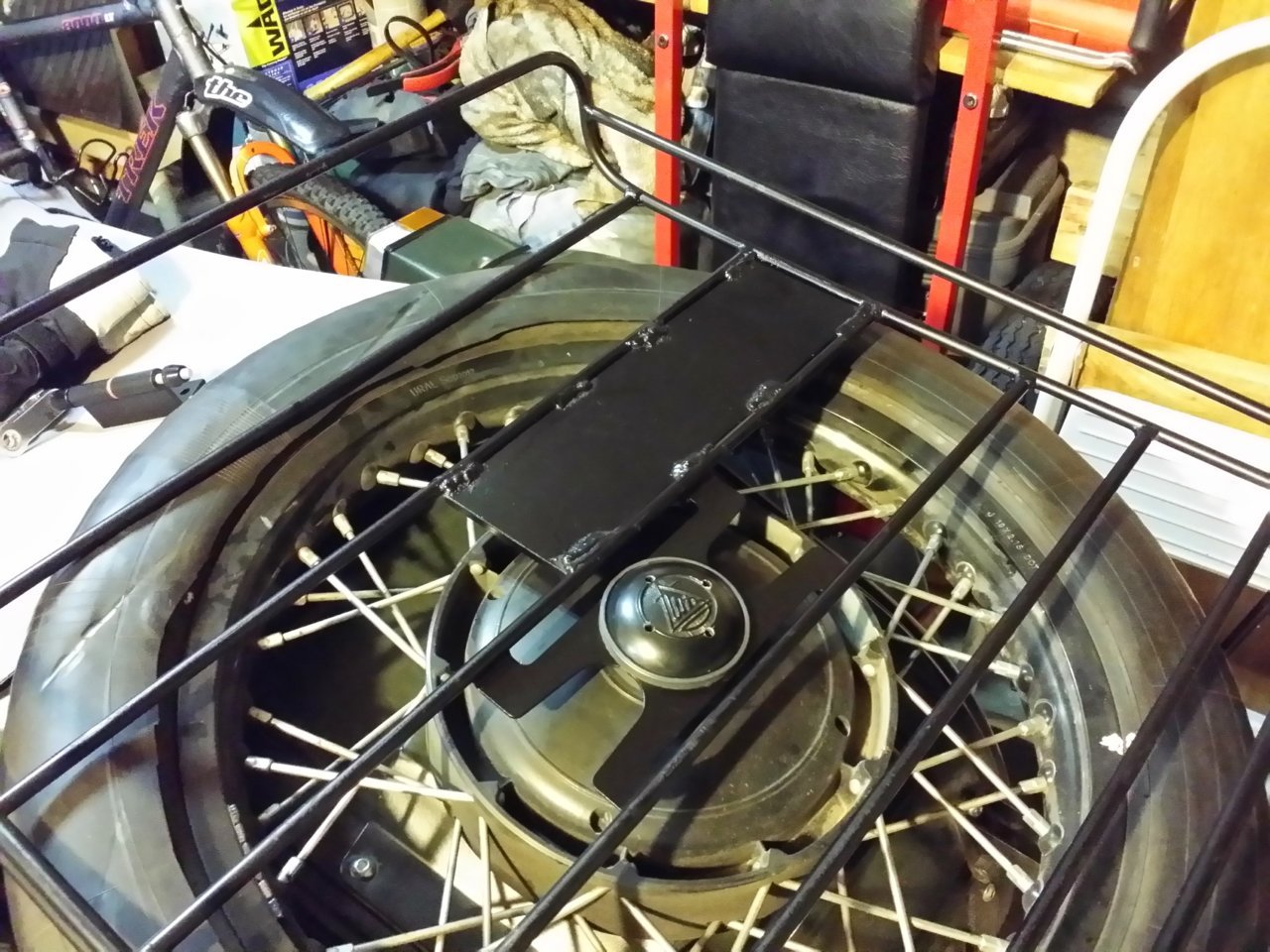

    I got some a long time ago when I had big dreams of a wedge camper. Still though, they have been handy for many other things.
    I enjoyed welding in HS and had a friend help me weld on a plate to the rack of my long gone sidecar to become a mount for my bicycles. That was the just about the limit of his skills as he was just getting into it.
    Lately, I have been watching some fab channels on YT. Folks can do some killer stuff.

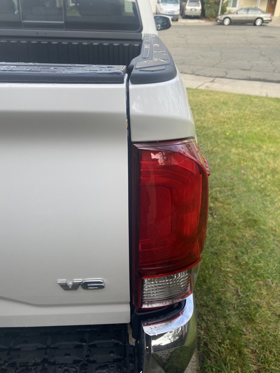

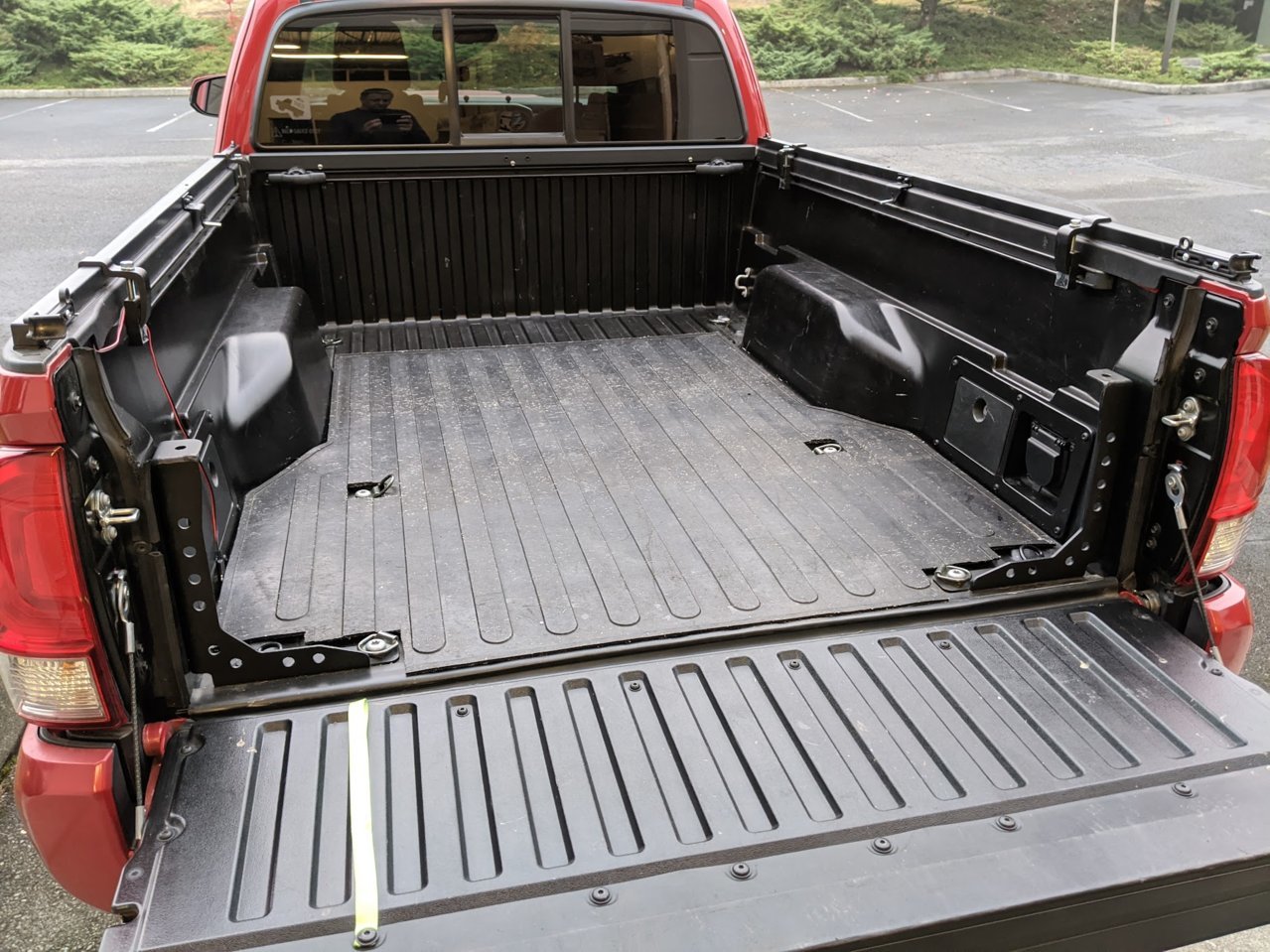

    Here is a pic of my bed without straighteners and with no load. Comparing with the narrow gap created by the straighteners, I’d say that straighteners do more harm than good.

    The stiffeners will not affect your existing gap. The post that you quoted was showing a bit of spreading (on a 1st Gen). The stiffeners likely pulled it back to the original panel gap.
    There are pics of 2nd and 3rd Gens posted around here. Both have the same bed design. The 1st Gen is all metal, but folks have noted that even some full sizers can have spreading.
    The stiffeners likely saved my bed this day. I had a real dolt helping me load up.

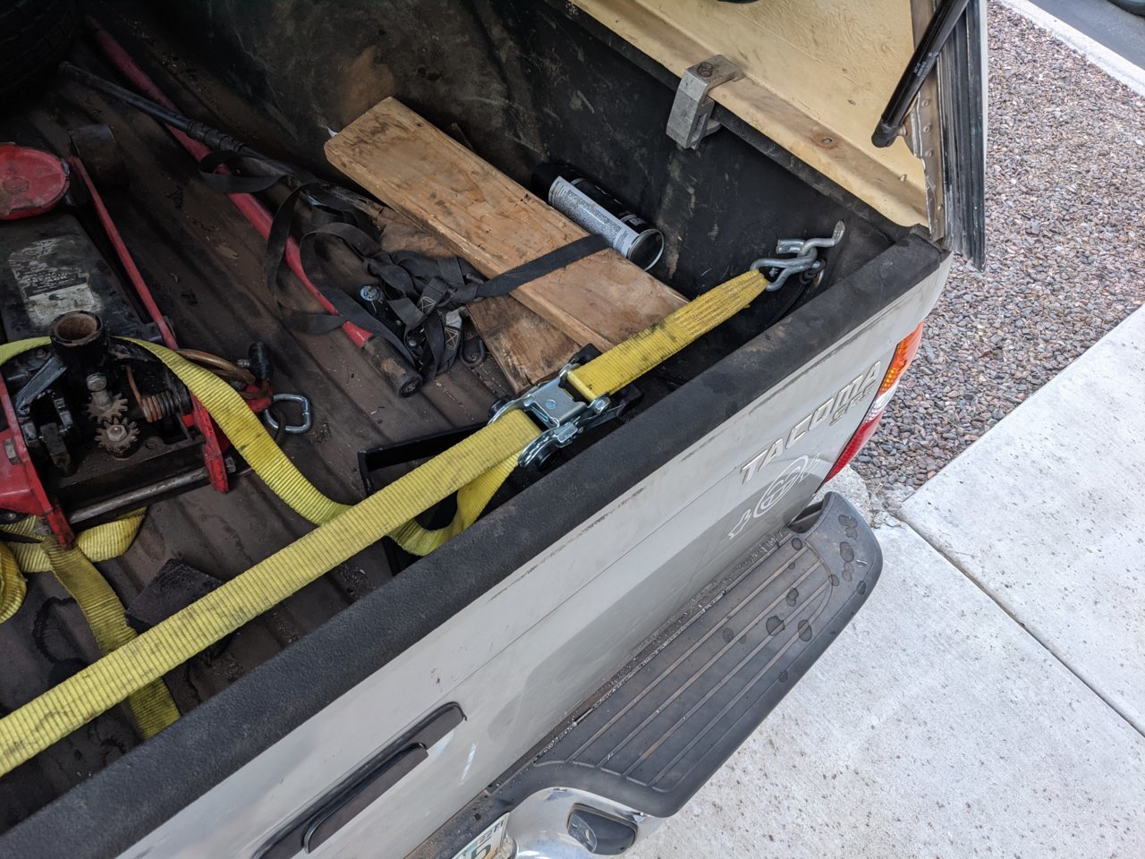

    Y'all really just try to argue on this forum lol. I used a ratchet strap, tightened the gap back up, tapped the bed, and bolted in. Jesus.
    It didn't look like that when i bought the truck 3 years ago, so evident issue.
