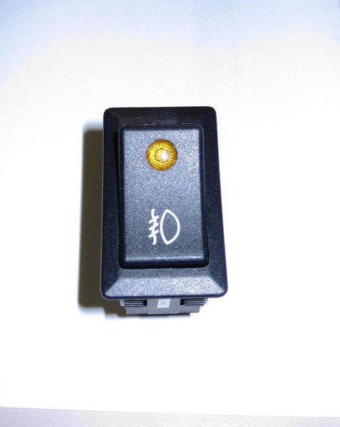

    Cool, ya I want to do the running lights/ blinker switchbacks to. I have a 2002 bumber on my 1999. Do you know of a good write up for that mod? What is the "toyota orange light switch", you have?

    Nice they have some cool looking switches
