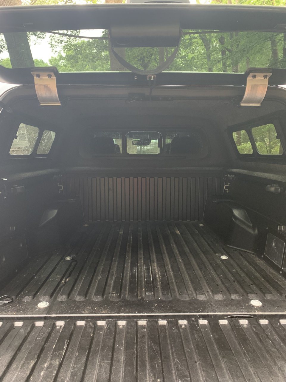

    It’s got bolts in the adhesive pad. I’m honestly not too worried about it cause the struts are supporting most of the weight when it’s up. I think like the guy with the problems said, the adhesive wasn’t fully cured. Maybe they used a better, stronger holding substance? Even if it falls apart warrantied or not, I’m gonna make them fix it after paying them 3k for it

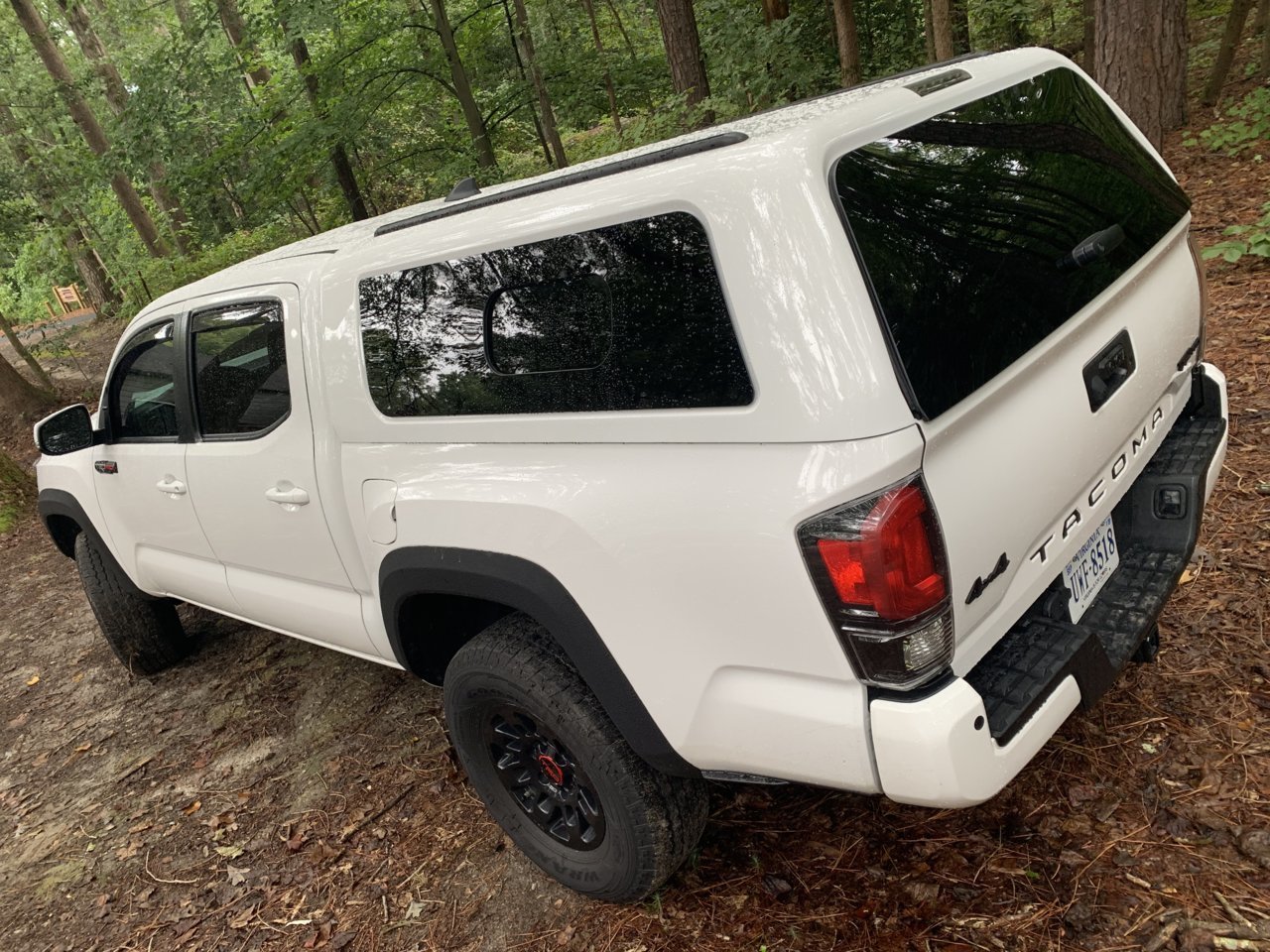

    That’s a sharp looking topper!
    Any areas where the topper could rub paint off the bed if the truck? I’ve seen that posted before as a concern with other toppers.
    I really like this topper and am glad
    I found this thread.
    In retrospect, is there anything you would have done differently?

    Fitment was perfect for me. No paint rub, very little to no water leakage after silicone filling the gaps up front near the cab. I have been 100% satisfied with this product. The rear window is not fragile nor flimsy at all if properly adjusted on there, I was even instructed by installers to come back a month later for readjustment once the gasket forms in.
    Only thing I would have done different is ordered a compression boot so I can just keep the power sliding window open at all times. Gonna have them do that as well as completely remove the front sliding window on the cap because I just don’t see the point in ever having those windows closed. Visibility is much easier without looking through 3 tinted pieces of glass haha

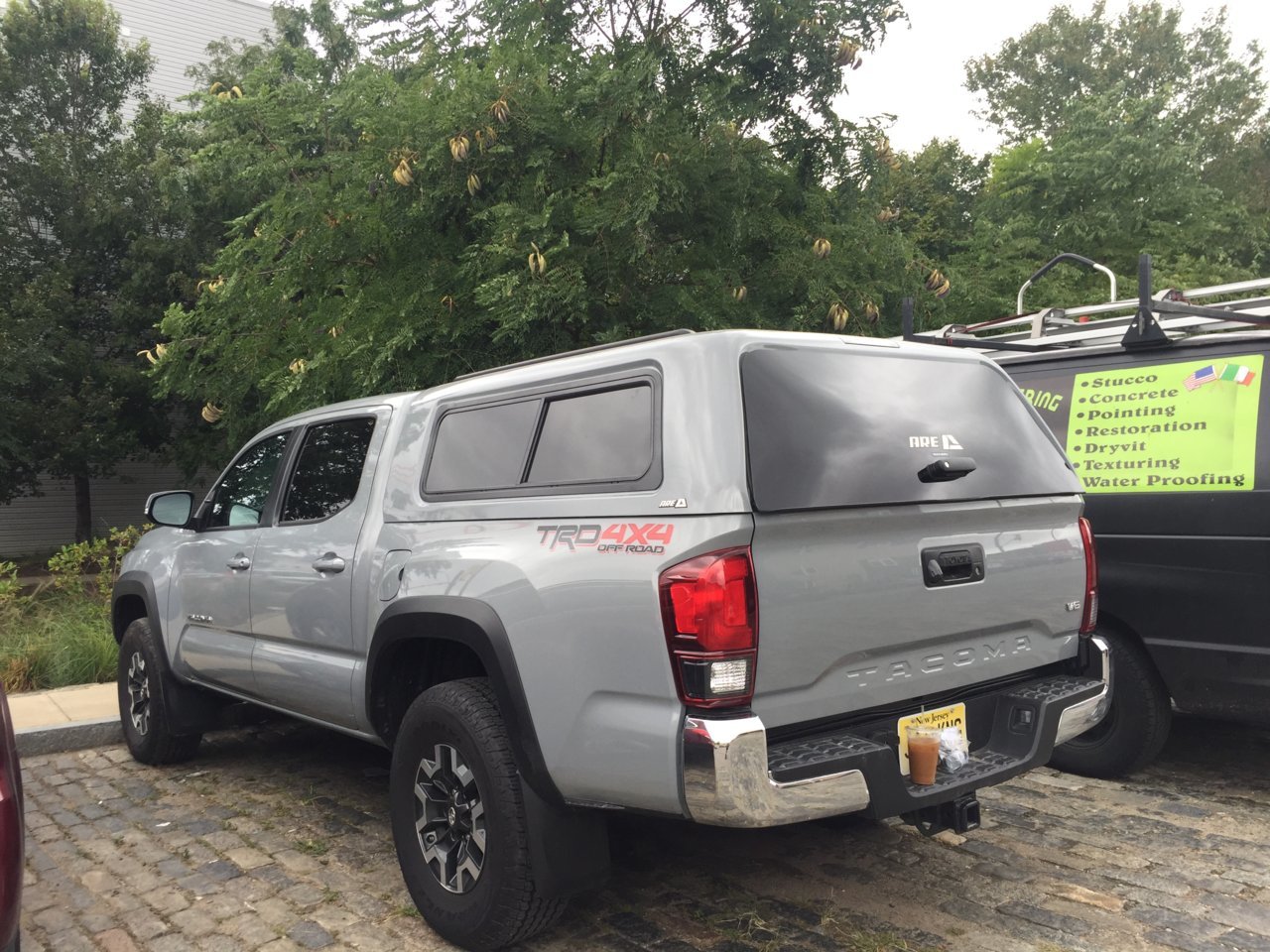

    I just got a CX Evolve installed on my Toyota Tacoma. Two quick questions. Is the cap suppose to sit more flush to the truck than pictured here? There is a little overhang on mine. Also, the back glass has about an inch gap off the back when it closes. Worried about potential leaking, and at first glance not sure how well it will hold up to weather. Any insights would be greatly appreciated. This is my first cap and just not 100% on other's experiences with their installs.

    Fitment looks good to me. That back glass normally overhangs a bit, shouldn’t be an inch though. It’s also supposed to be readjusted by your installer after 3-4 weeks. Get them to tighten more then

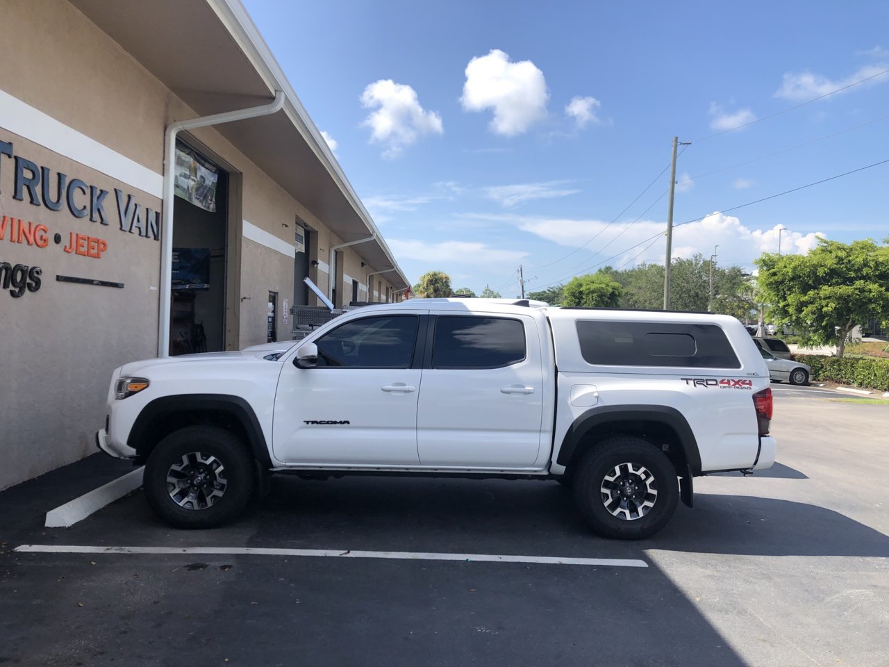

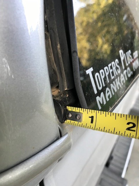

    So, first off I am in this forum for the discussion on the topper. I have a Chevy (don't hit me)! Maybe the tailgate of the Chevy is a different shape from the Tacoma. I measured my topper window and the gap is 9/16 inch between the tailgate and the INSIDE of the glass. If I really try I can force my fingers between the glass and the tailgate, but I can't open the topper door. Maybe the installer can adjust the glass door, or maybe they need to move the entire topper forward 1/2 inch-ish.
    I see that my installer logo is in the picture so I want to add the disclaimer that I do not work for them, I am not associated with them in any way. This is the 1st ARE topper I've ever bought and I have no obligation to ARE.IMG_1532.jpg

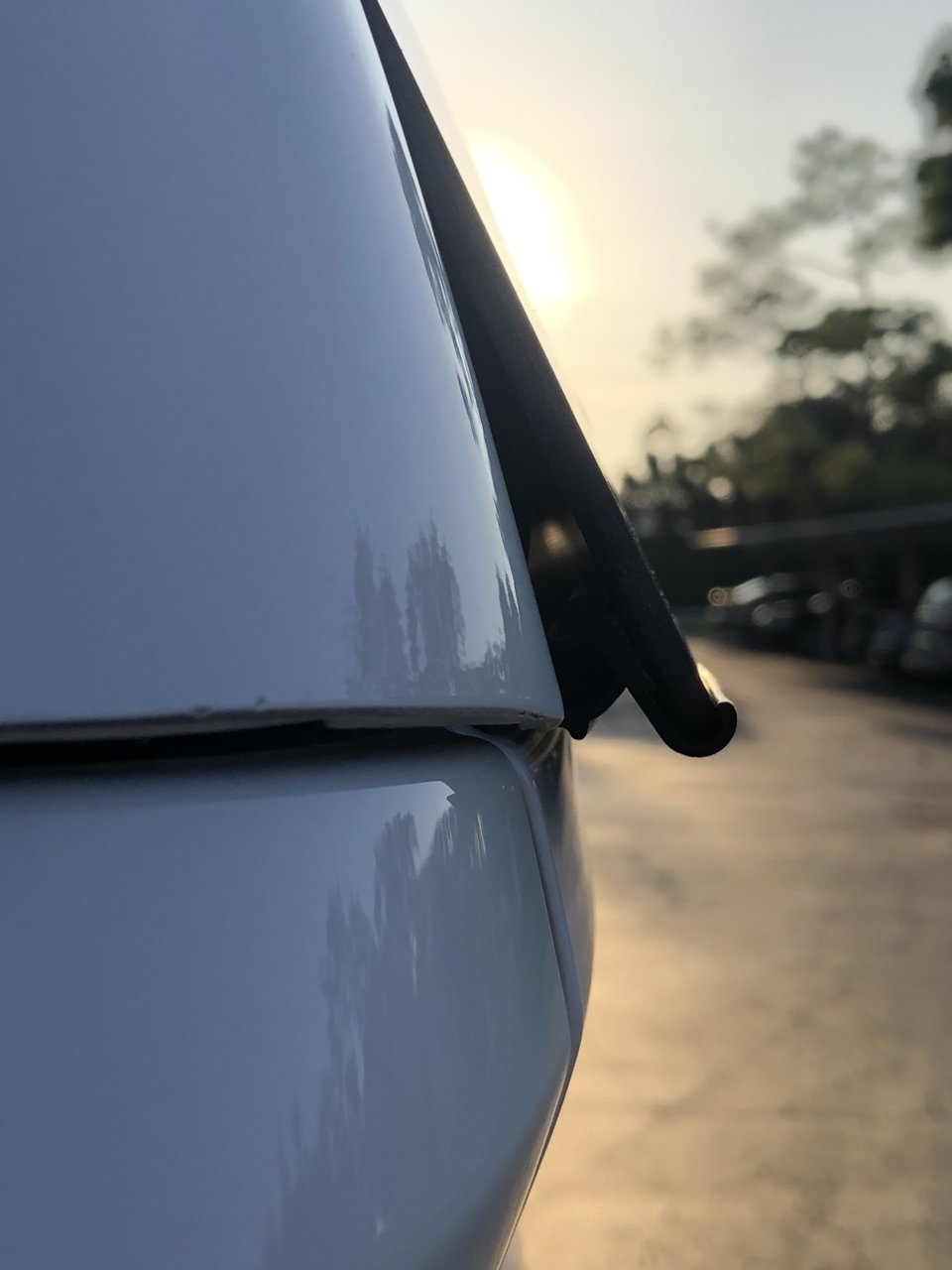

    I took delivery of the topper today. I'll post pictures but the bottom of the back glass sticks out from the tailgate. I can see light through the bottom seal and the glass is anything but flush. It's not even close to flush. I asked for an adjustment but they didn't know how and are reaching out to ARE. Does anybody have experience with this? If the dealer doesn't know how to fix it ( I dont think they will) I'm thinking about how to remedy it myself. It's so frustrating that you cant even contact the manufacturer. Oh, and the front window aluminum overtightened bolts problem is still a problem.

    Eww that gap is gross! My rear window only sits 1/8” from the tailgate if that..just enough gap so it doesn’t hit when closing it. You can try moving the adjustable latches on both sides in. If it doesn’t catch after that, you’ll have to find a way to push the gasket in more

    Let your installer do it. You don't want to void any warranty. The installer should never have let that out of their shop in my opinion. I'd be embarrassed. TG
