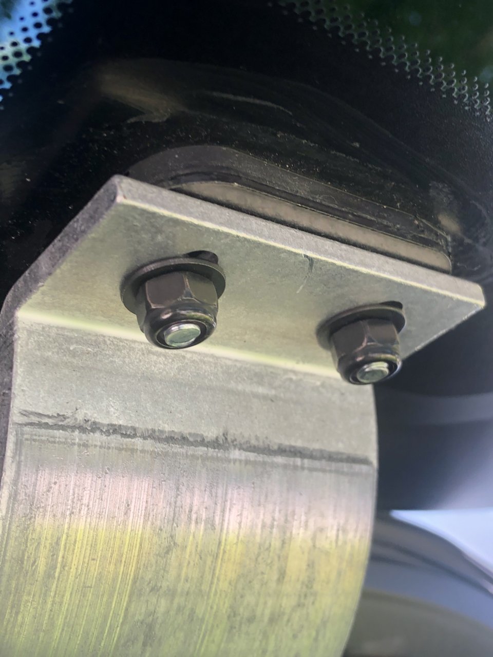

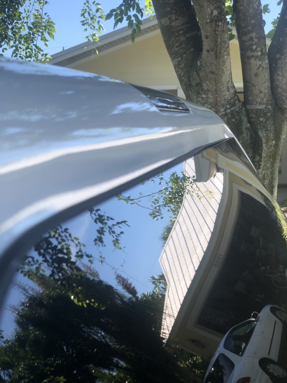

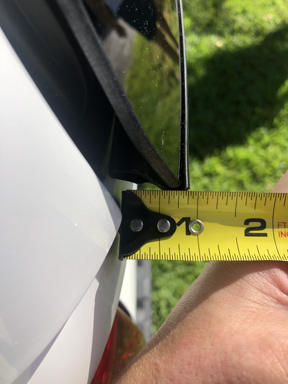

    Uploaded the full size images so you can see. You can see the 7/8" gap. Furthermore you can see how the mounted closing brackets are in the proper location yet the wear pattern shows that the hatch clasps at the very bottom. The picture of the weatherstrip sticking out of the top of the closed hatch and the adjustability of the bolts holding the glass to the hinges shows room to adjust. I have decided to wait for the dealer to adjust these because I don't want to break the glass and get stuck with the bill but I think it is fully possible to adjust. I'm not sure what manuals the dealer receives from ARE but I think they are capable of the adjustment. If only we could just call the manufacturer.

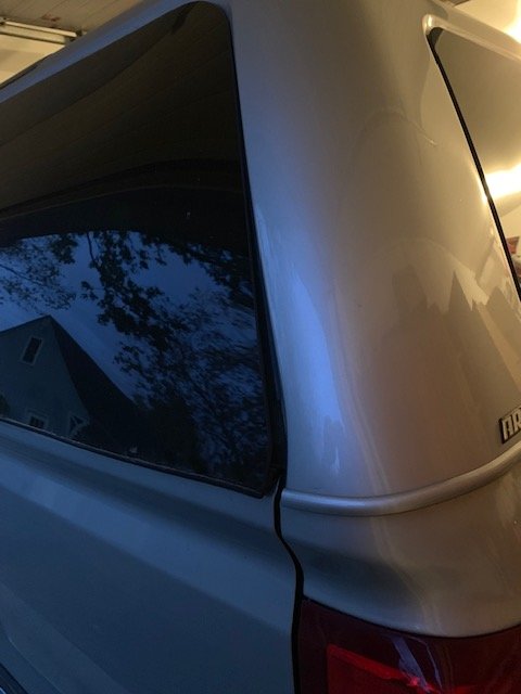

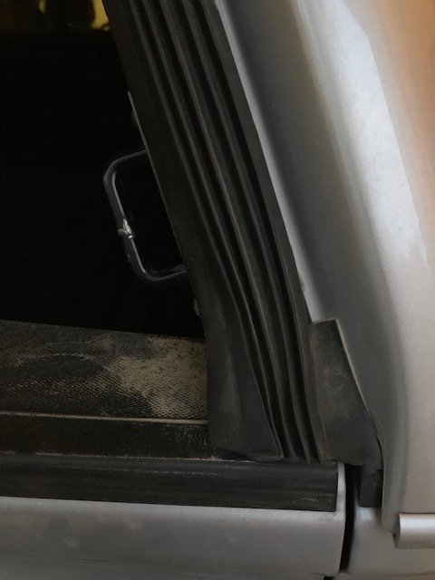

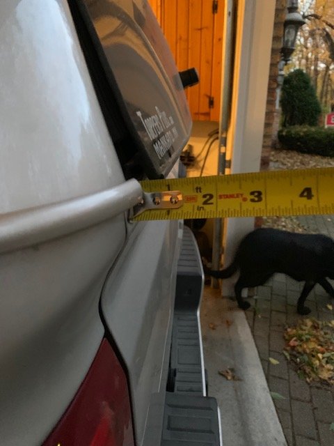

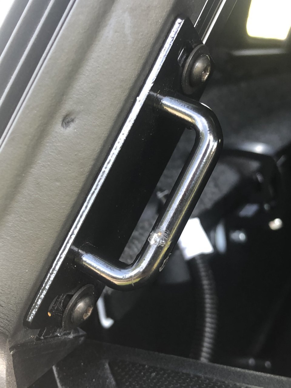

    I also am posting some more pictures. I'm showing the compressible rubber gaskets, vertical and hollow horizontal (on the bottom of the door). It was getting dark after work so not the best pictures. I also have some wear on the D-rings. TG
