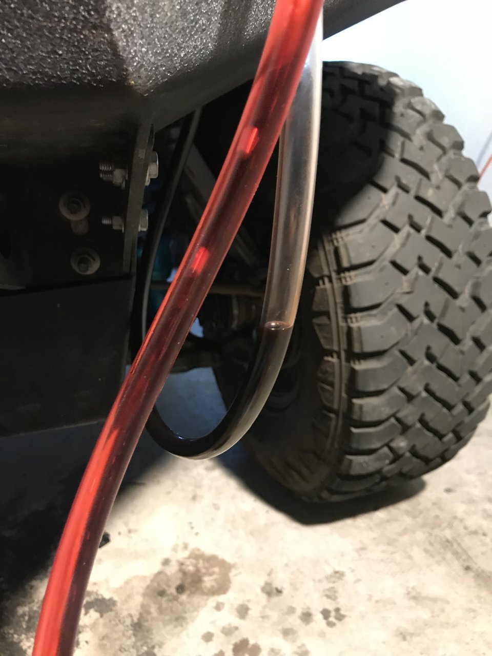

    Just do a drain and fill
    I did a flush recently but I had more miles miles

    Depends upon how the flush is done. Cheap shops do what is called a reverse flush. Pulling the crud trapped in the filter into the tranny, and valvebody. Done properly a flush is good. Just dont let them suck the old fluid out through the fill or dipstick tube. Cooling system flush yes it is good, cheaper to do it your self.
