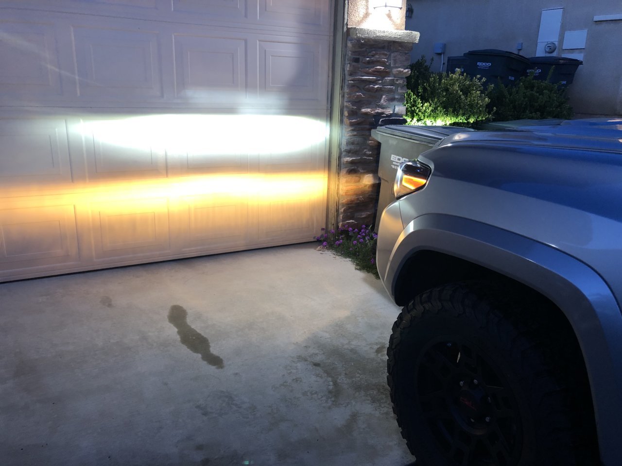

    Top is halogen. I wish I would have gotten a before for the beam pattern, but it’s night and day. Price tag sucks, but I have no complaints

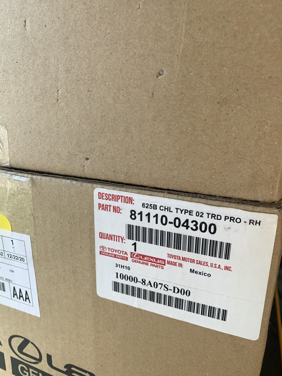

    anybody got the part no. for OEM LED headlights?

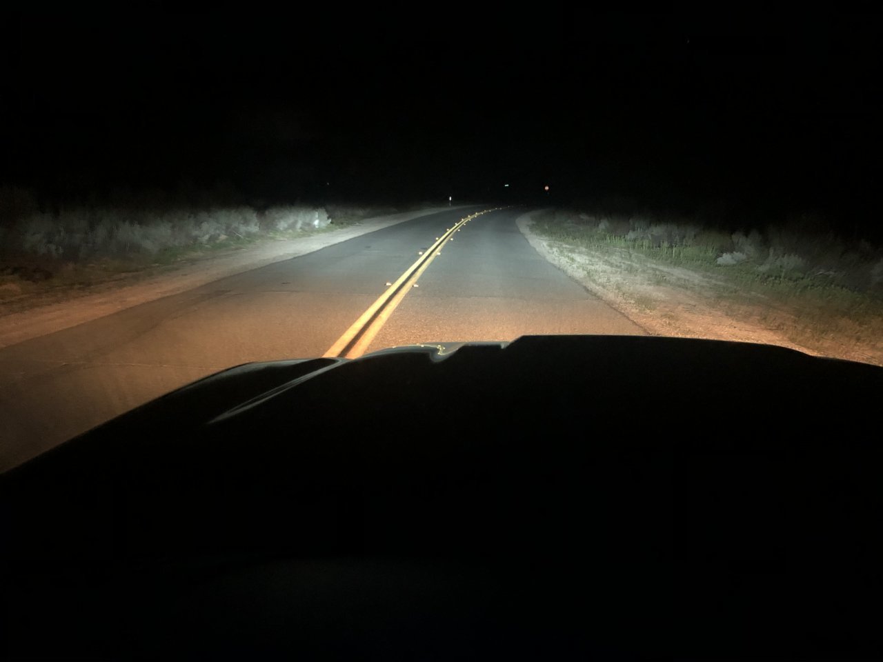

    I agree to a certain extent. I think it is location (lighting) dependent.
    When I lived in the city, halogens were more than enough. I live about an hour out of it now, and there is ZERO lighting, curvy roads and deer. LED’s were a night and day difference and worth every penny.
    the high beams on my halogens still give out less lighting (or so it seems) than my low beams. It’s pretty nice

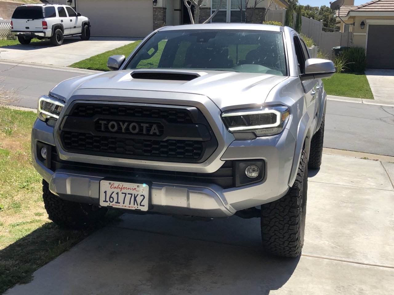

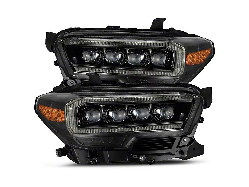

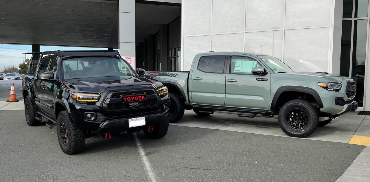

    Are LED headlights worth the trouble? Yes. I think so.
    I bought the AlphaRex LED lights. Best light upgrade - ever. Great visibility at night, looks better than the TRD Pro LED lights too.
    I get a TON of comments about them - people love them.
    Full on LED (left) and Sad Sad TRD Pro (Right)...
