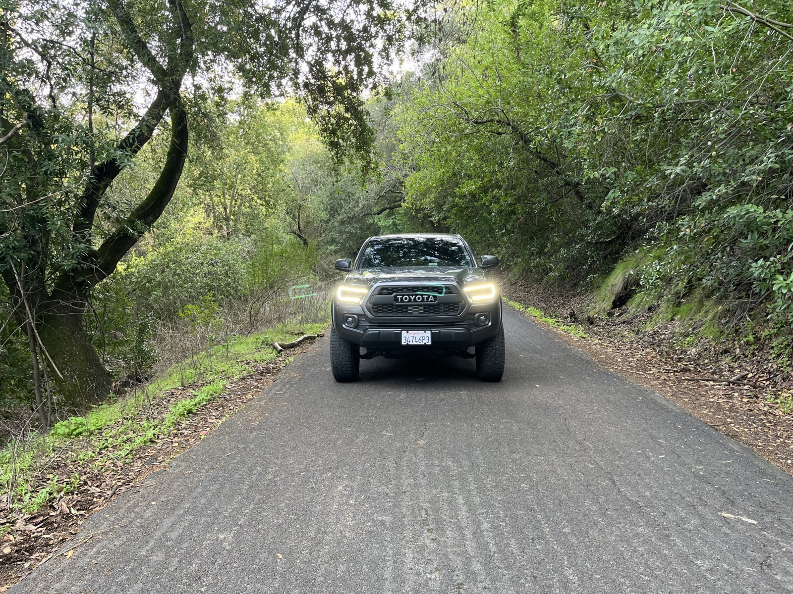

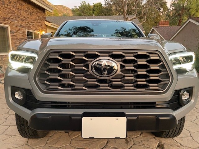

    If you have a trd/limited model, oem led is an excellent option. For us sr/sr5 owners the harness is different and if you want to go oem you have to purchase a different/ more expensive harness. I went with morimoto on my sr5, had them for a year and they’ve held up really well, drl and turn signal are extremely bright, beam pattern is also excellent, however they must be adjusted as they aim down from the factory. Alpharex headlights look great and have a cool start sequence, but alpharex cannot design proper headlight optics for some reason. For literally every single of the nova series projectors on all vehicles they make them for, not just the Tacoma, they all have the improperly designed hot spot with a giant unfocused blob in the middle resulting in over intense foreground light. They also make the reflector design that resemble the look of oem, but those bleed a ton of light above the beam pattern due to poorly designed reflectors. They are however probably the coolest looking headlights you can get, that’s why they’re so popular and people rave about them so much over YouTube and you see them on almost every truck on Instagram. Imo oem is the safest choice followed by morimoto xb, you can also get xb’s in an amber drl if that’s your cup of tea

    Those Morimoto look especially good on your Tacoma :thumbsup:
