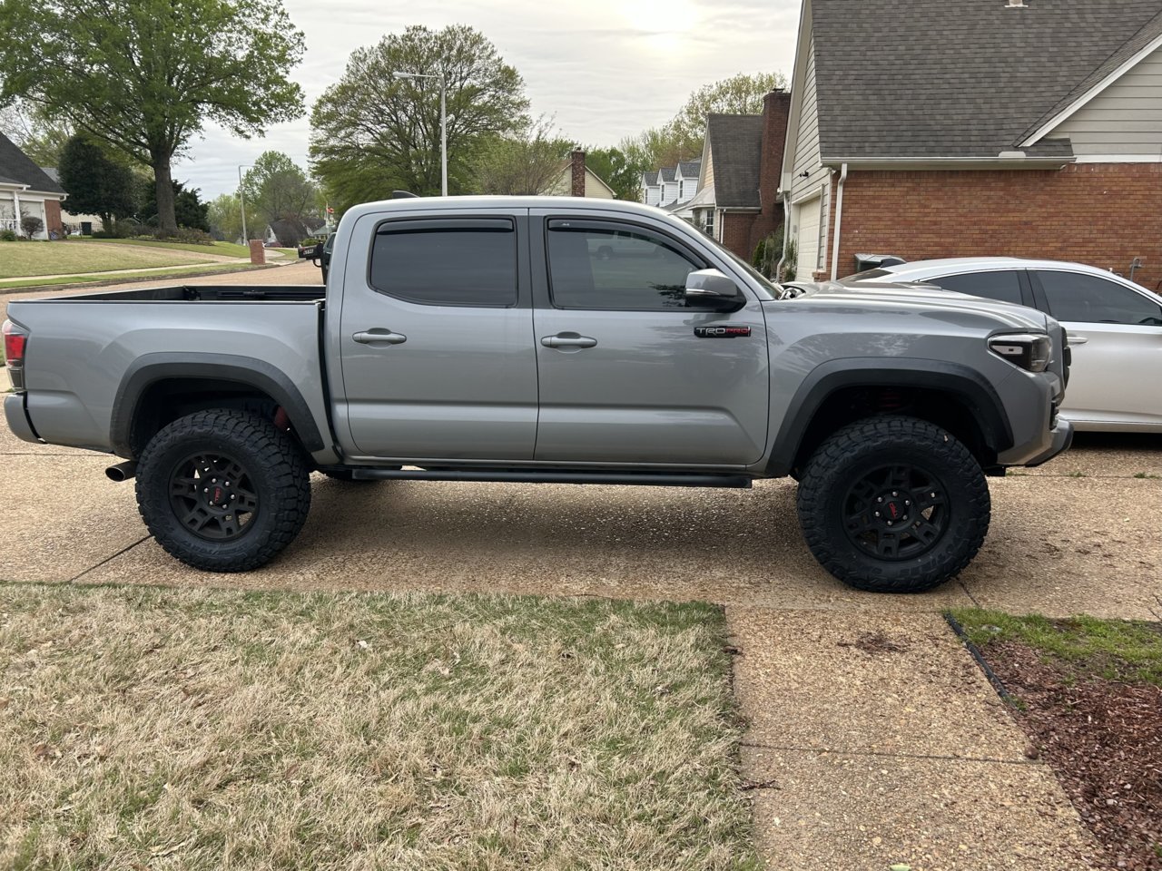

    3DDA6AB8-EFC4-46A2-976F-13551D286DD3.jpg I ended up calling an audible last minute and went with RT trails, C loads in 285/70/17. We’ll see if I regret the more aggressive tread, but very happy with the lift and stance.
