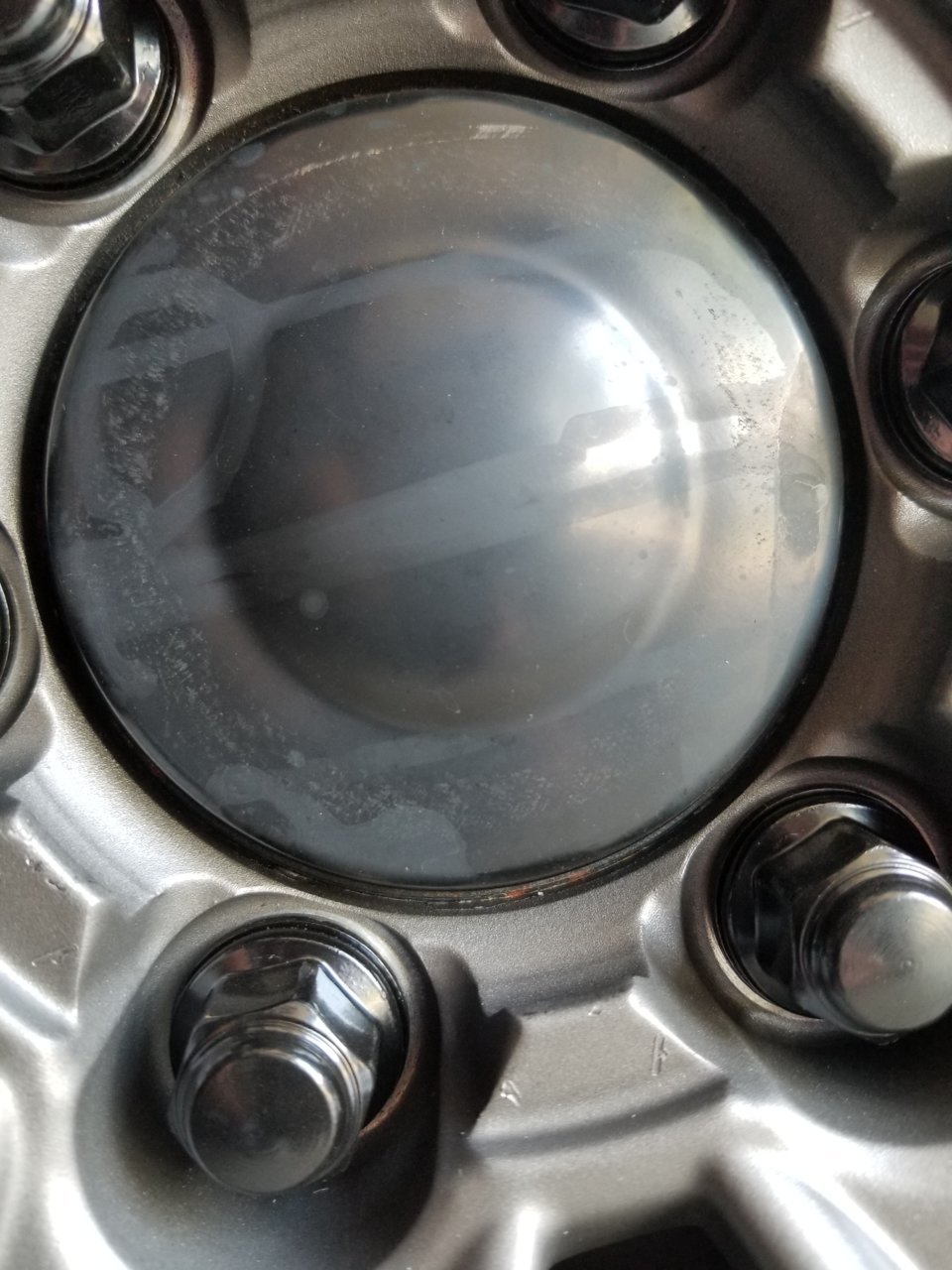

    I read on here the factory 2022 OR factory alloy wheels are hub centric. However, when I took mine off to paint them, I had to manually center each wheel (with a gap to the hub) to get the mag lugs started. All my other vehicles have always had the lug holes align (with a little c/cc rotation) to the female lug holes.
    So are my wheels lug centric? Do I have something wrong with my hubs?
    I didn't take any pics when I remounted.

    Unless you have conical lug nuts and seats, they are hubcentric.
    Gap? Pop the hubcap and take a pic.

  5. Sep 9, 2022 at 1:14 PM

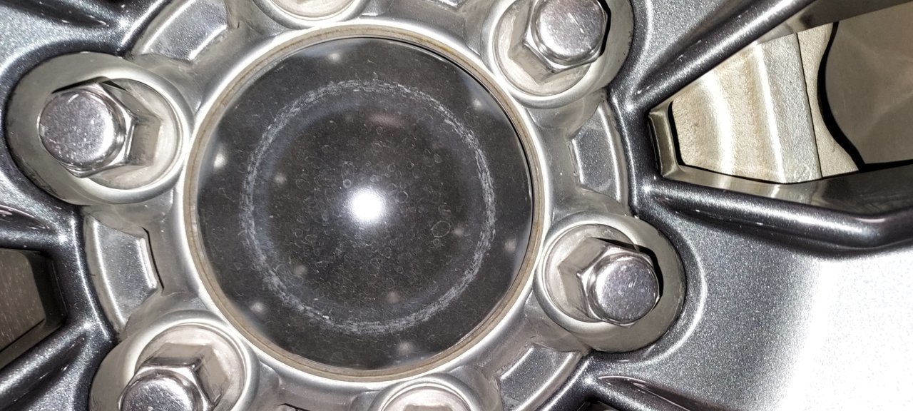

    Can't really tell from the slight above view.
    Looks like a you might have some gap at 3 and 9 o'clock?
    Here's mine for comparison.

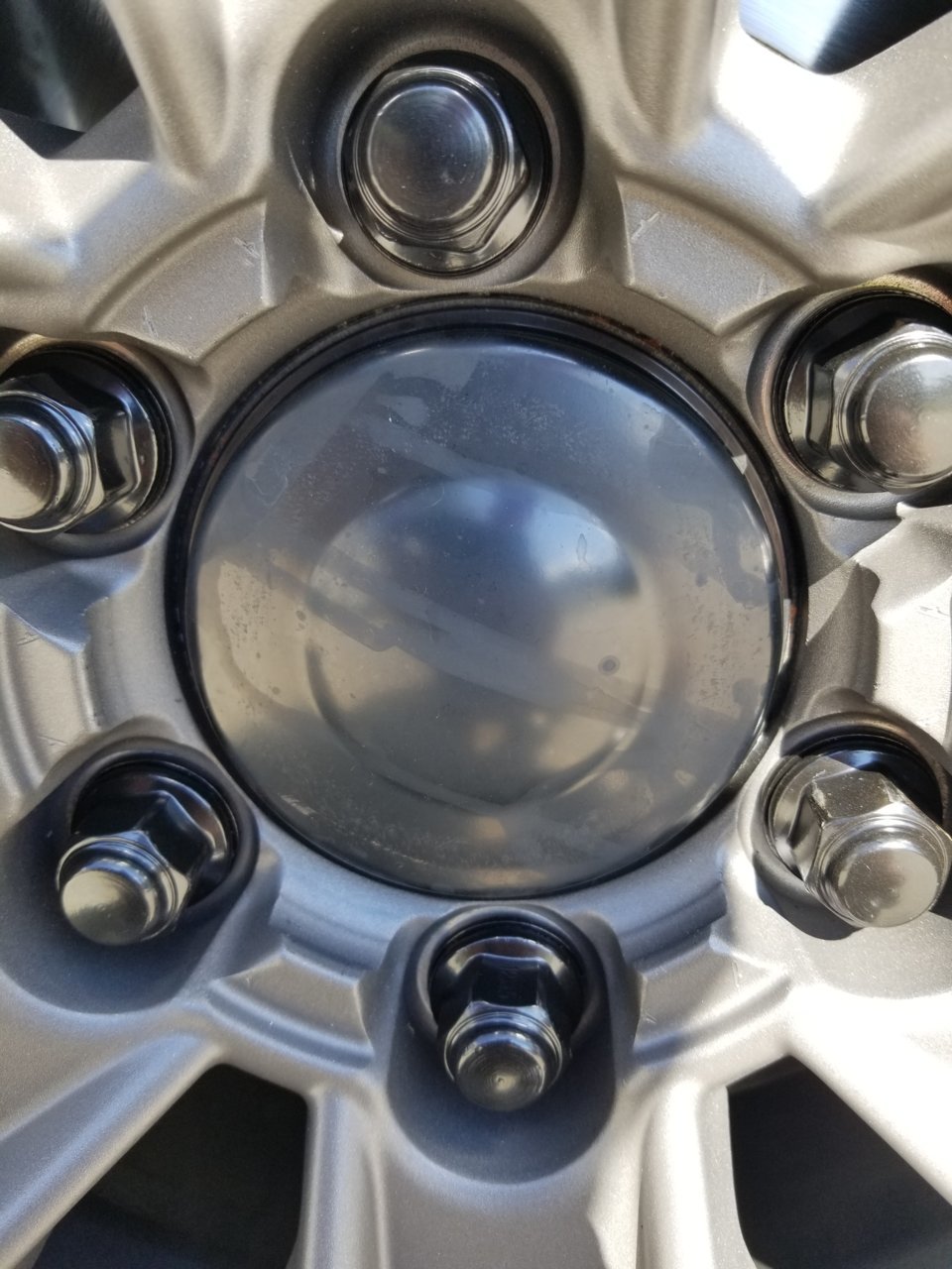

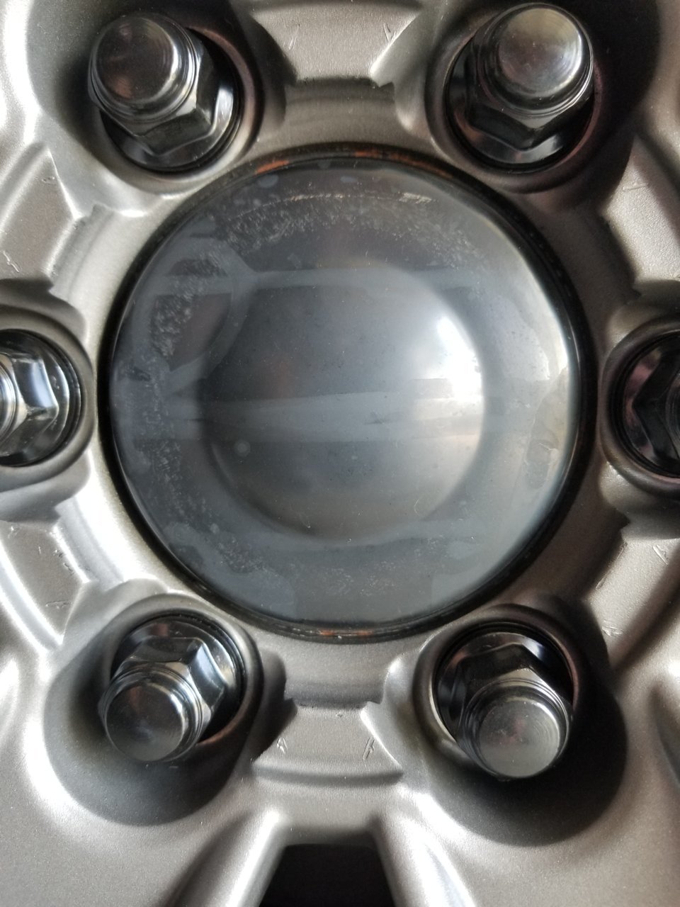

    Mine appear to have a gap compared to yours. Do you use mag lugs?
    Does your hub support your wheel and hole matchup when spun?

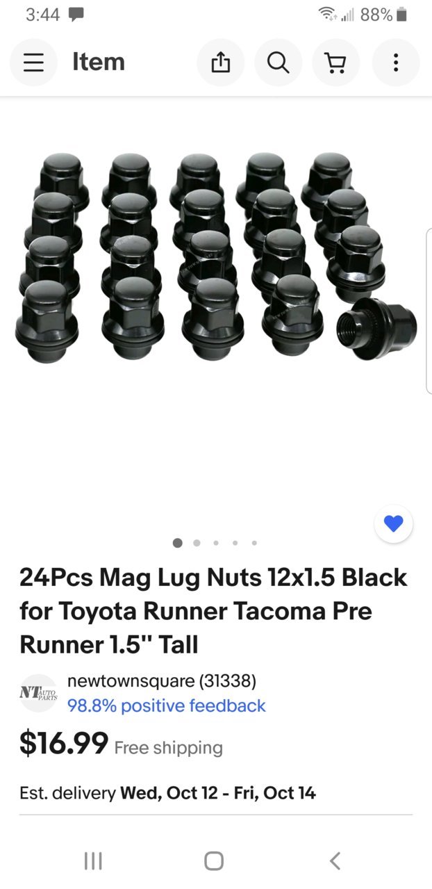

    If by mag, you mean tapered seat lugs on the OR wheels, that is likely a bad idea. You can get the Toyota lugs in black.

    I already replaced factory chrome lugs with black ones. The listing calls them mags and are the same as factory Screenshot_20220909-154436_eBay.jpg

    From the the part I can see, yours looks fine. 3 and 9 o'clock are obscured by shadows...
    Are you looking at the hub dust cover and not the actual hub?
