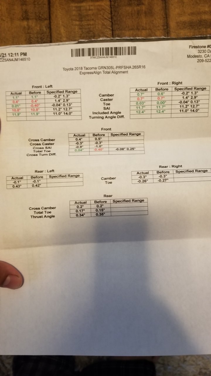

    I have a 2018 Tacoma dcsb 4x4, I recently installed Bilstein 6112, 5160 and All pro AAL. Its currently sitting high at 3" up front and 2" in the rear. I understand the caster is bad without aftermarket UCAs but it looks like Firestone did not touch camber or caster at all because it's in spec. Am I going to have issues with my new tires with that camber?

    Yes you will wear tires. Camber should be 0.0 - 0.2 caster 3.0 - 4.0. UCA’s will help

    Just called Firestone, they stated they can fix the camber but does not have the tools to adjust caster. Does that sound strange for a alignment shop to not mess with caster? I'm new to this wheel alignment stuff.

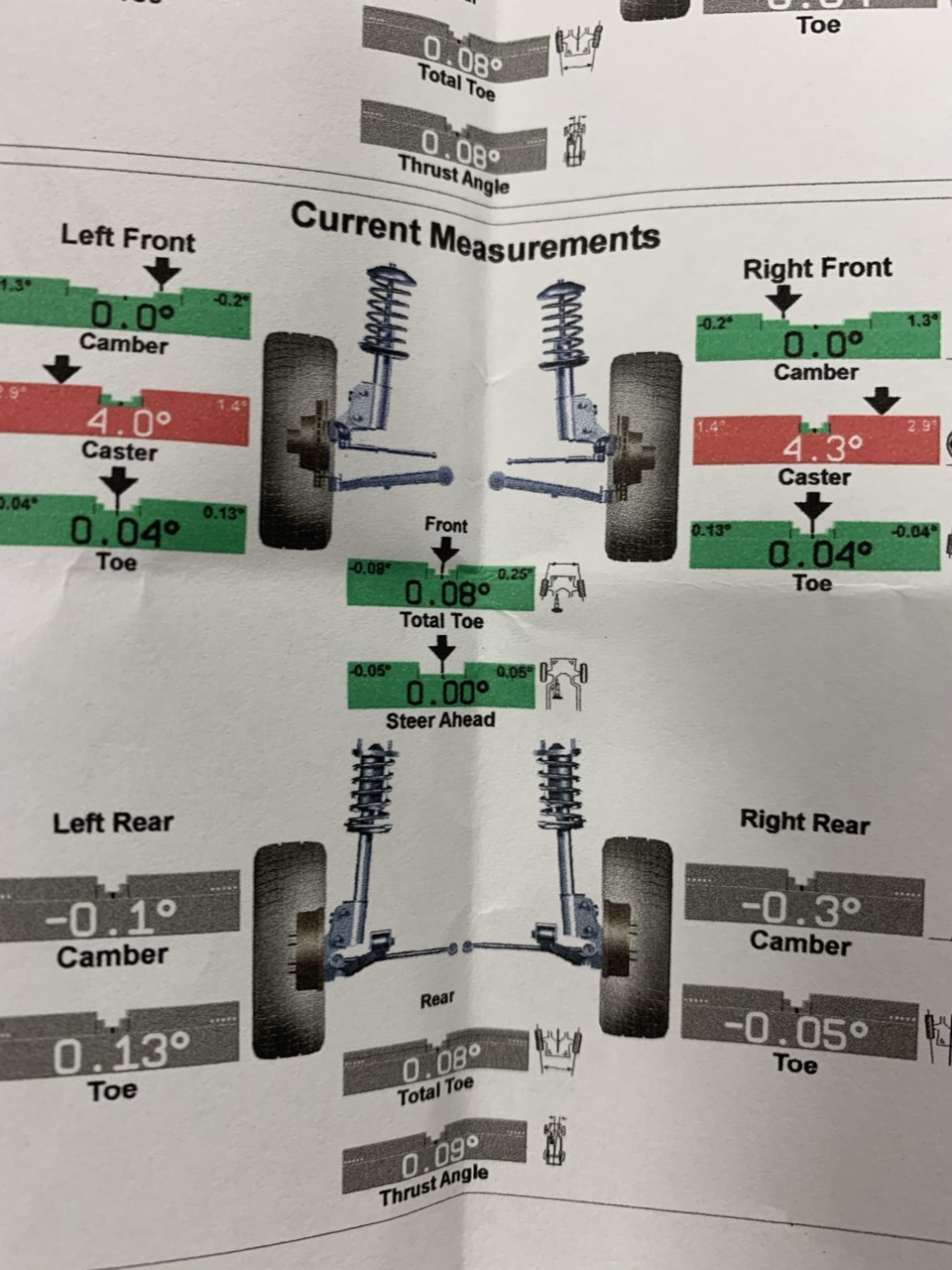

    Here are my numbers

    Thank you so much for the help today, I'll use your photo as a reference to show them if they can get my alignment close to your specs.

    Anytime. Just remember these numbers are with SPC upper control arms. Also I’m right at 2” of lift and needed them. It’s a good investment for sure.

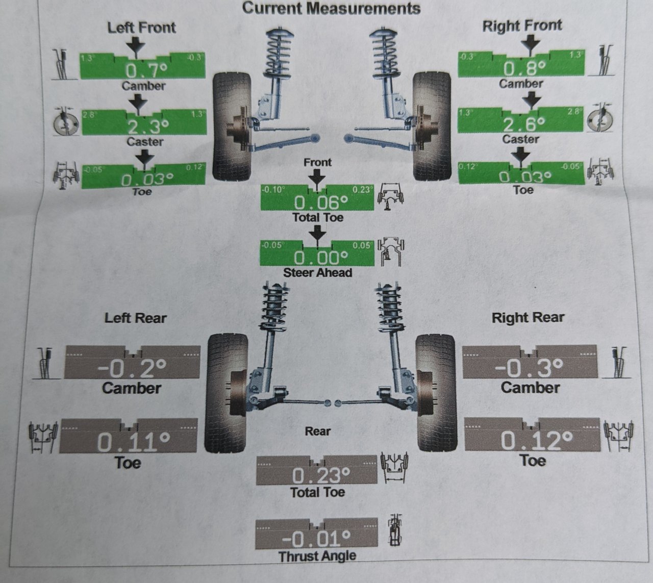

    You will be alot better with Aftermarket UCA's, here's mine that was just done, 2.75" front and 2" rear lift icon UCA's. And this was just a regular tire place that did minePXL_20210115_185348361.jpg

    I figure that was the case, I honestly didn't know they were just going to touch only toe.
