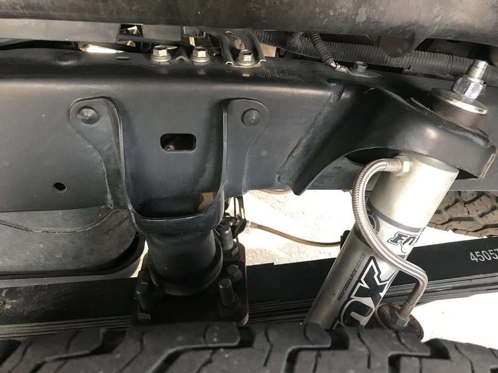

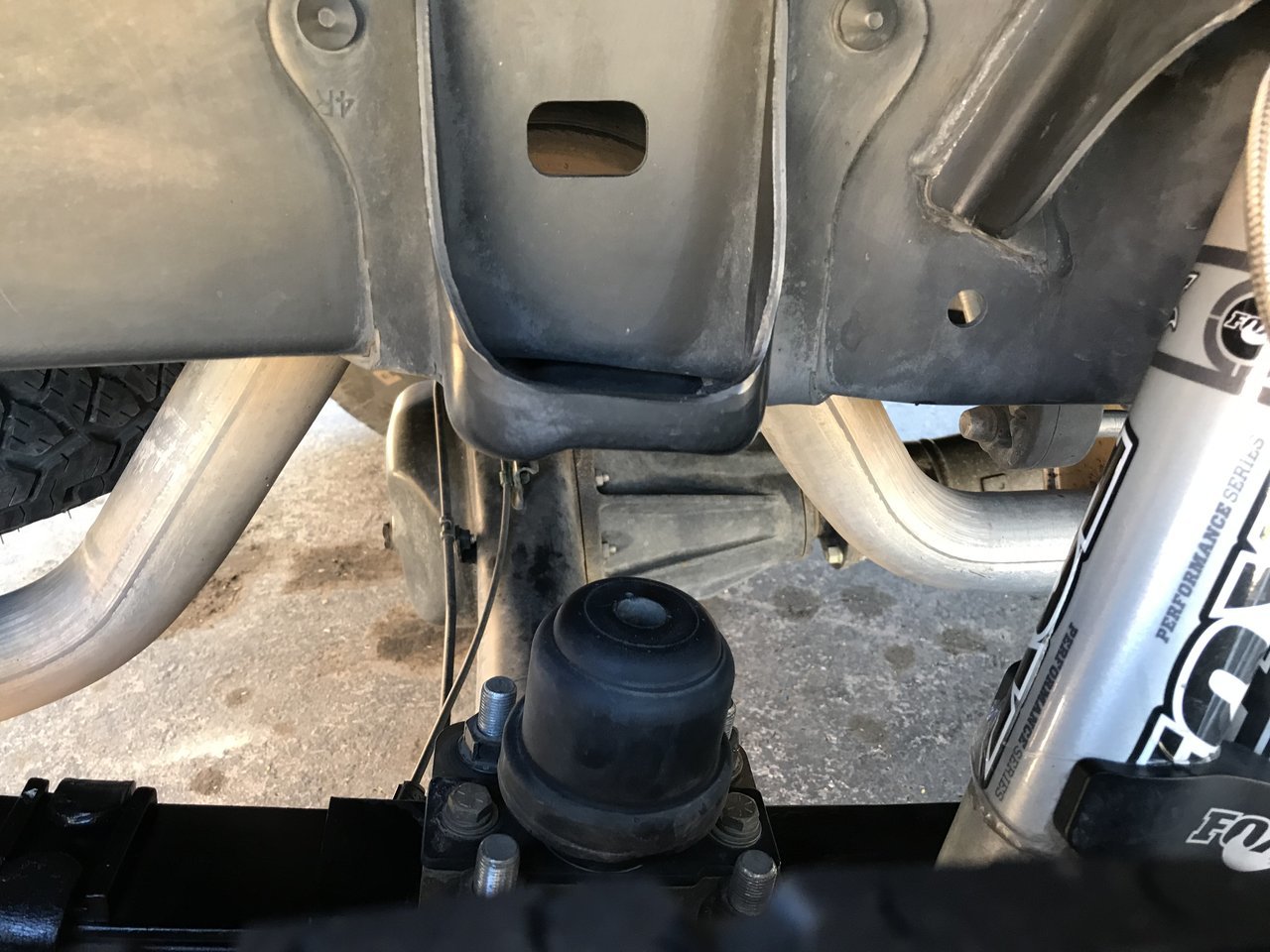

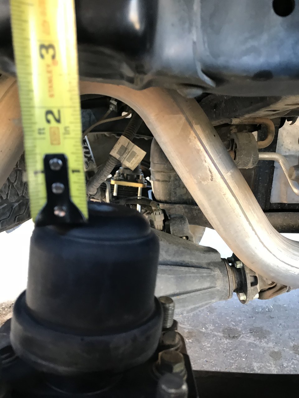

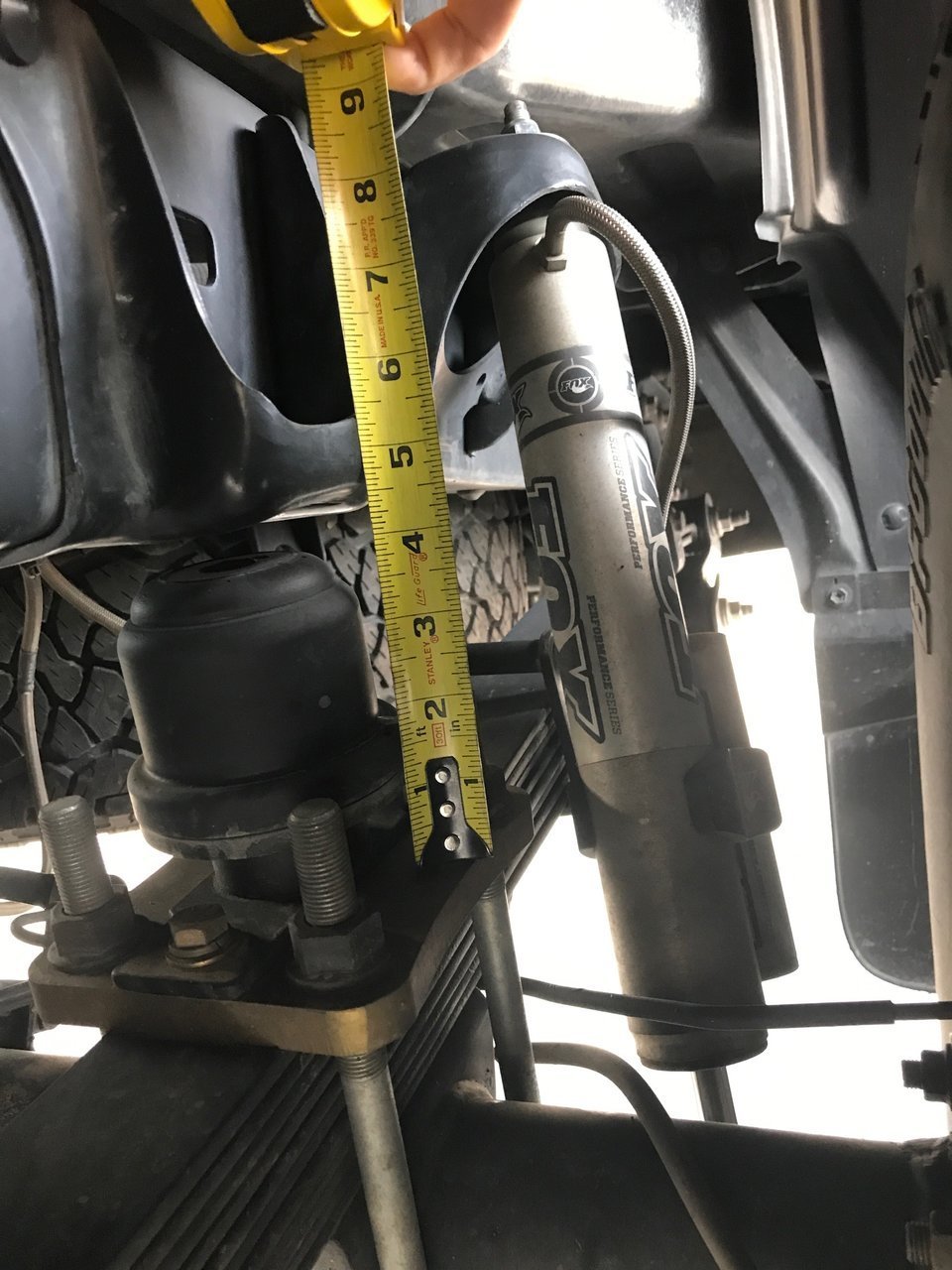

    @Dan8906 so got everything installed. All is well truck rides awesome but no more resting on the bump stops!! I’m sitting at about 25.5 hub to fender figure it will settle about .5-1 inch. Before I was getting less then an inch before the bumps engaged now I’m at about 3. The springs are also much more stout so it will take much more weight before hitting the bumps.
    How it sits with the expos
    Before with the standards
