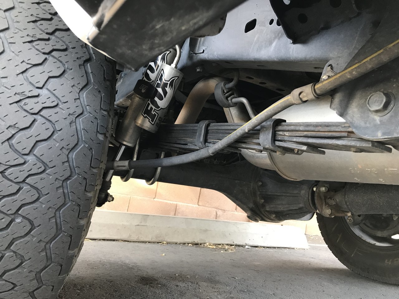

    How much weight do you have normally just daily driving?

    just went out to look at mine. def have more clearance and i'm running the same shocks & leafs. I did notice my rear brake line is leaking.

    Nothing besides a spare tire

    About 100 for the tent and whatever the bed bars weight. day to day there isn’t anything back there but the tent.

    Dakar 96R leaf packs is the way to go for your setup. I have the 95R and love them :thumbsup:

    I went from Icon add a leaf, to dakars, then dakars plus a leaf, then all pro expos, then a custom deaver pack. I just kept adding weight and had to make adjustments. Once your 1000lbs over stock in the rear you have to go custom.

    My Dakars + AAL ride great and do well for my current uses. I still have Firestone Ride Rites with Daystar cradles in there too for those times when I make the bitch work. Excellent overall combo.

    I'm running the AP standards in mine. I'll admit they are pretty crappy, but I'm getting more lift than you are.

    Well duh at full droop under no weight id hope there would be some uptravel.

    There is definitely something wrong I wouldn’t run Dakar’s just because they are stiff but that’s just me. I had deaver u402s on my truck before I swapped out with the icon rxt leaf pack and both hold my tent and rack perfectly fine.

    I have CS047R Dakars, which I believe are more similar to the current EL096R or the EL095R with the EL46XL. IMO that is the minimum configuration I'd put on a truck unless it is really just an empty, open bed.

    I'm still convinced there's something wrong with your install based on my experience with that same leaf pack. I know people love to dog it but it's seved me well. When I added a bed cage, rtt and rotopax to the back i tore that leaf pack apart and added a OME D29XL AAL. I think that would be a cheap fix for you as long as you have some tools and what not.
    A couple of us have done it as apposed to upgrading to an Expo...check it out here https://www.tacomaworld.com/threads/all-pro-leaf-pack-adding-a-leaf.462946/#post-13773360
