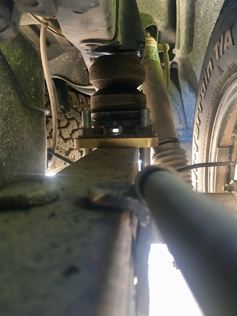

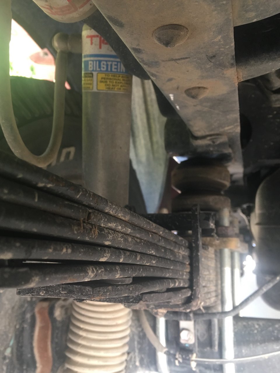

    I have the same exact problem!
    Same allpro leaf pack but I have timbren bumps and u-bolt flip. I just ordered longer shocks in hopes my bilsteins were the issue. After initial install I had about 1.5-2" of clearance b/w bump and after two weeks the bumps are almost touching the frame! WTF!
    It is comforting to know someone else has the same issue and I'm not cra.
    Sorry.
    Do you have TRD Pro? I don't think that would make a difference but I also have Pro and reaching for answers after ruling out the simple stuff (leafs on the correct way, everything tight and no wiggle, checked shocks as limiting factor, emptied everything out of the bed and even checked with an empty gas tank).
    As of last night I was thinking a shackle flip might be the answer but the cost is almost equivalent to switching out the leafs...
    Definitely let me know what you come up with and I will continue to follow thread.
    Thanks for posting!

    Same looks good rides good but with any weight the spring and shock have no room to work. I haven’t had to cut the bolt on the flip but my pack is only a few months old i can see this becoming an issue though over time.
    I haven’t heard anything from them. At the moment I am waiting going on to week 3 from my initial call. I have sent multiple emails but I have also just learned they are closed for moving.
    I’ll try to keep this updated as to what ends up happening but at the moment I think I’m going to take a loss on the allpro pack And have to buy a Dakar. I don’t have a pro basically a pro with everything I did tho lol. But once you change leafs it should sit just like mine. The pro suspension is only different in the front ride height and better shocks of course.
    As for the longer shock i don’t think that’s going to help maybe in down travel but it won’t push the spring and bump alway front the frame.
    I have also looked at all the little things shocks bolts only thing I see is the pack is very tall limiting space and any sag whatsoever is going to bring it close to the frame. I thought about cutting down the bumpstop or changing the mounts but after talking to wheelers they said it seems to be a pack issue as well.
