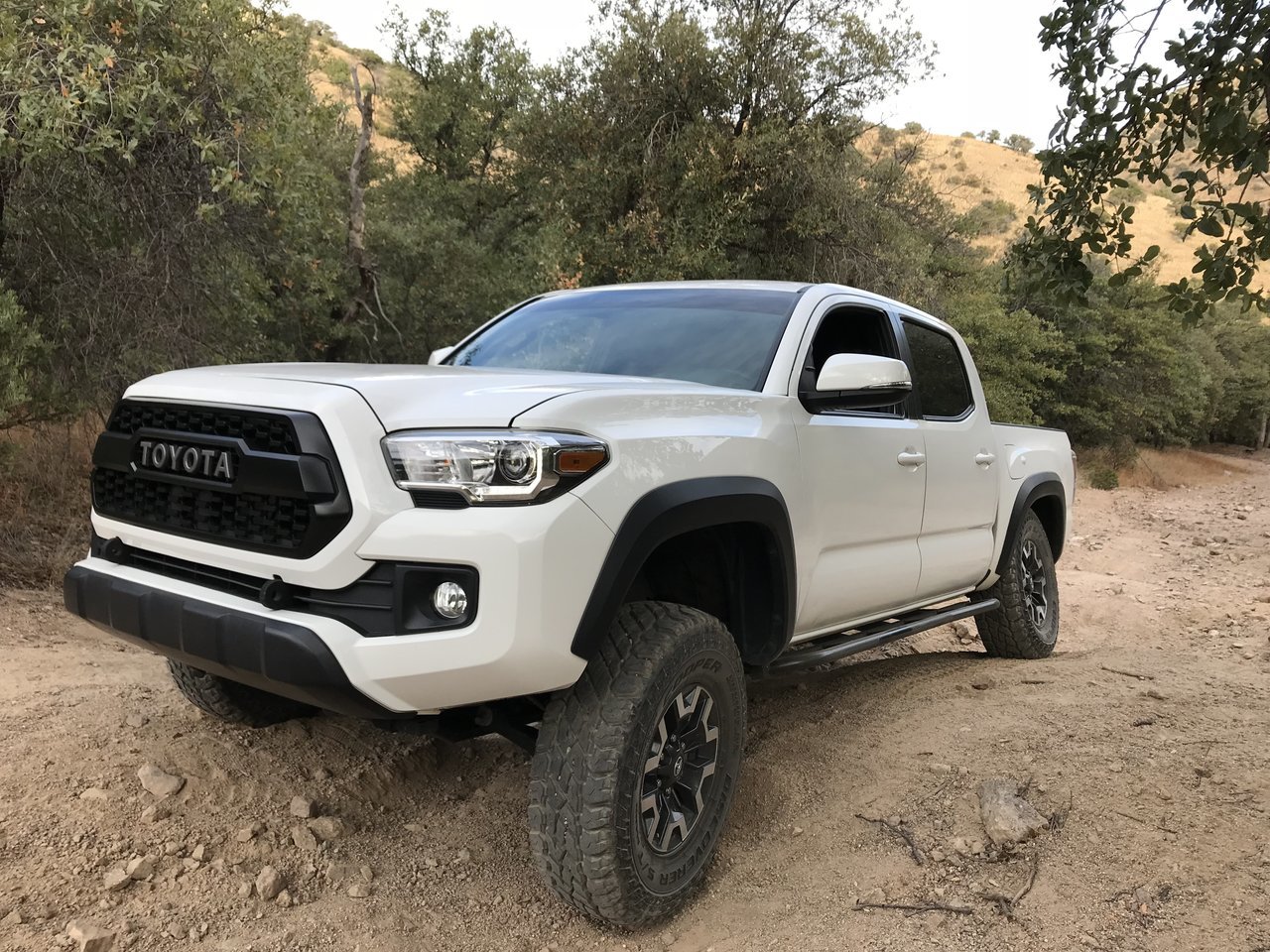

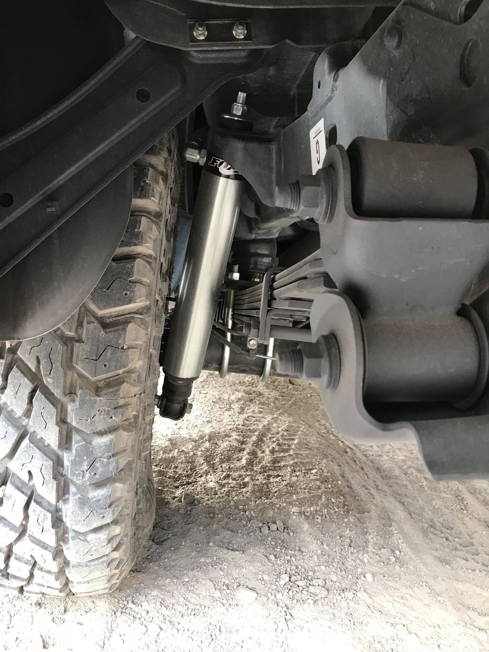

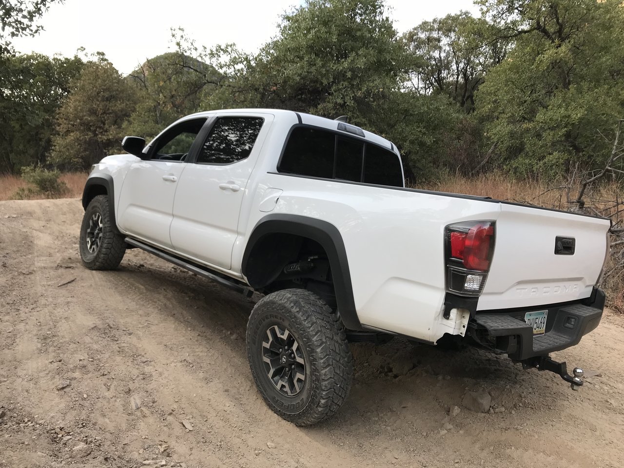

    It is the RXT pack. I'm running option #2 at the moment. May change to option #3 when my @Mobtown Offroad rear bumper arrives. Shocks are Fox 2.5 extended travel. U-bolts are flipped with shimmed @Wheeler's Off-Road Inc Superbumps. Here are a few pics of the rear drooped and stuffed.

    What's the fully-compressed length of that shock and how close is it to bottoming out when the bump stop hits?

    @Wheeler's Off-Road Inc lists 15.65" when the shock is collapsed. With their u-bolt flip kit and Superbumps you can shim the bumpstops as needed. I've got 1/2" worth of shims installed on mine.
    In the pic you can see the bumpstop is partially compressed. The shock still has a bit of chrome showing and the shock also has a rubber isolator which will compress a bit. Think I've got it where it needs to be.
