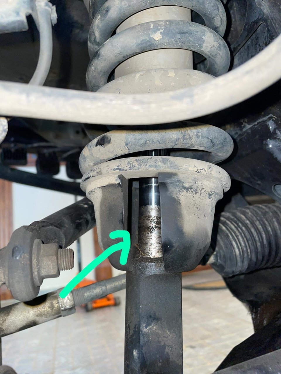

    Or is this just dirt?

    Definitely weeping.

    what’s that mean ?

    Very slightly leaking.

    does this mean I need a rebuild?

    Time for a rebuild

    Is this common for Icon? I've seen this happen to a few other people and it's always been on Icon parts

    There have been a number of threads for complaints on ICON

    I would suggest reaching out to Icon about servicing the shocks. Its not a simple easy job if you don't have the proper tools etc

    Did you try touching it to see if it felt like oil or dirt? I mean it does look like oil, but does it feel like oil? Taste like oil? Does it burn like oil?

    Yup feels like oil.
    the other one is fine though. Should I still rebuild them all?

    Great opportunity to sell them and get some Kings

    How long have you had them?

    Since 2017

    Rebuildable coilovers will need a rebuild eventually, its par for the course. 3 - 4 years is a decent stretch, usually if you do a fair amount of wheeling it's less than that.
    They have an authorized rebuild service in Texas, at the bottom of the page
    http://news.iconvehicledynamics.com/icon-factory-shock-service/

    thank you! I actually shipped my truck overseas here in Beirut lebanon. I’ll have to order the parts from icon to here.

    Probably a little overdue for servicing. :rofl:
    How often do you check N2 pressure?
