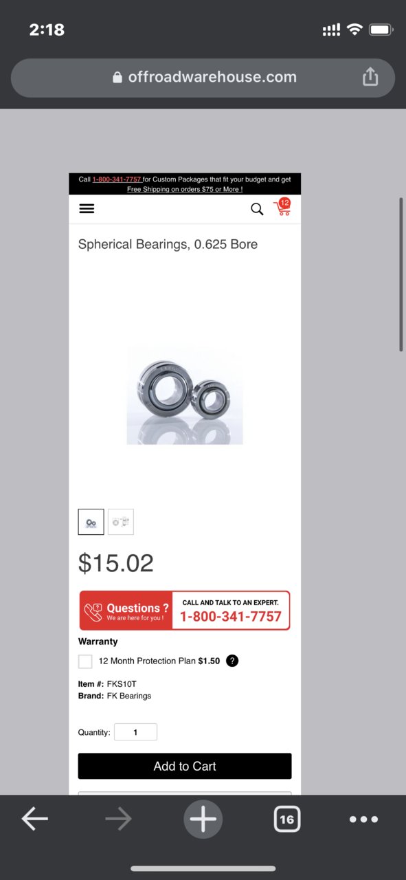

    yeah problem is I’m in the Middle East. So I have to order all the parts from the states and ship them here. There are shops that can do the work they just don’t have the parts. So should I just order all the seals for all 8 items? Shocks and reservoirs? And all bearings for upper and lower shocks ? Just to be safe.

    2016 DOUBLE CAB MGM 4X4 TRD OFF ROAD SHORT BED
    Are these both the same? And do they all apply to the front 2.5 coilovers and 2.5 back shocks? Both top and bottom mounts? Thanks
