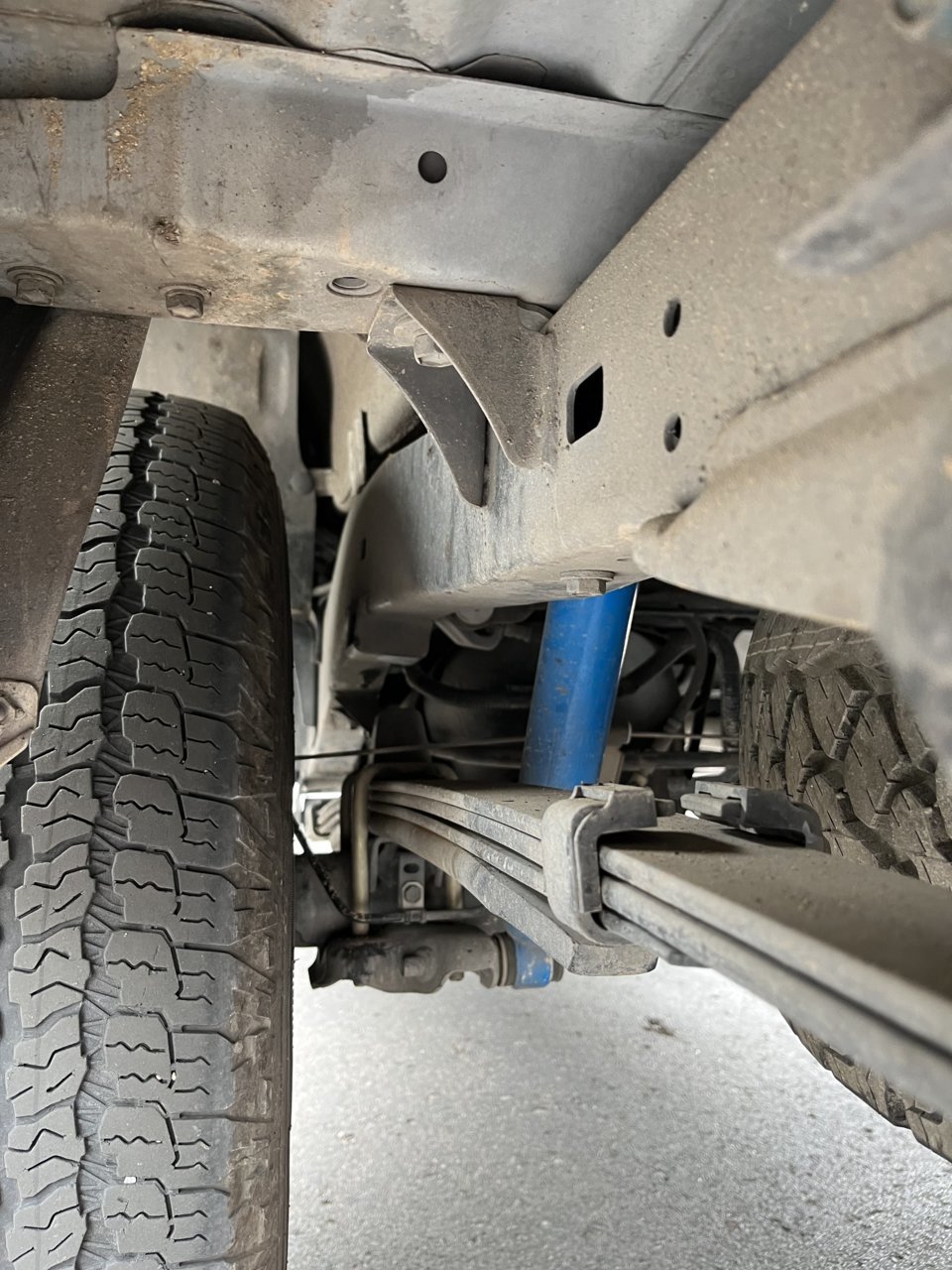

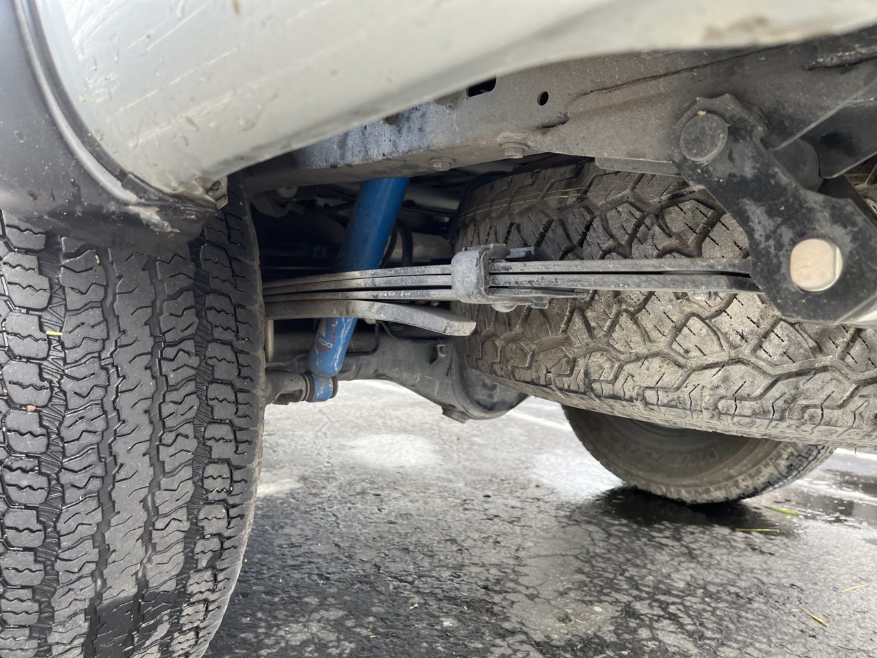

    I have shell, and I carry tools all the time in the bed, I’m not sure if these are stock springs or not. In my opinion they seem to be over stressed or bad. it’s a 2001 4door 2wheel drive Tacoma

    Oof! The three upper springs are basically just sitting on the overload leaf.
    I don't think they are stock springs. The overload leaf isn't shaped the same way I recall my stock springs being.
    You should consider a new pack, probably HD or custom, to carry the weight of the camper + tools.
