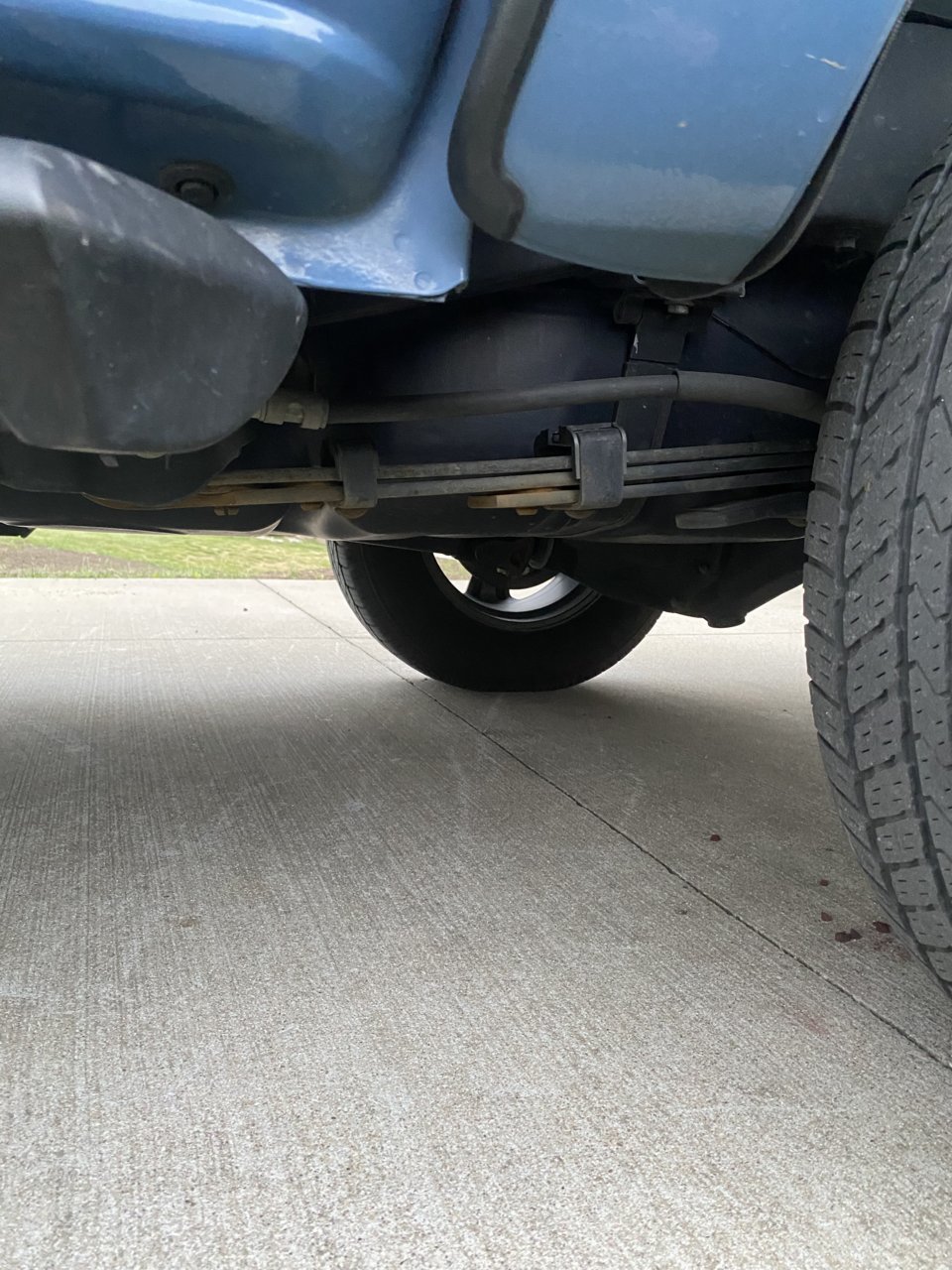

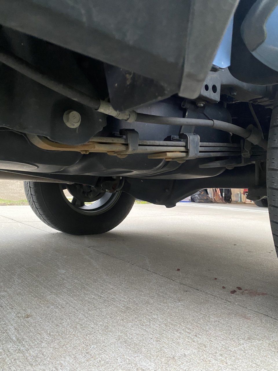

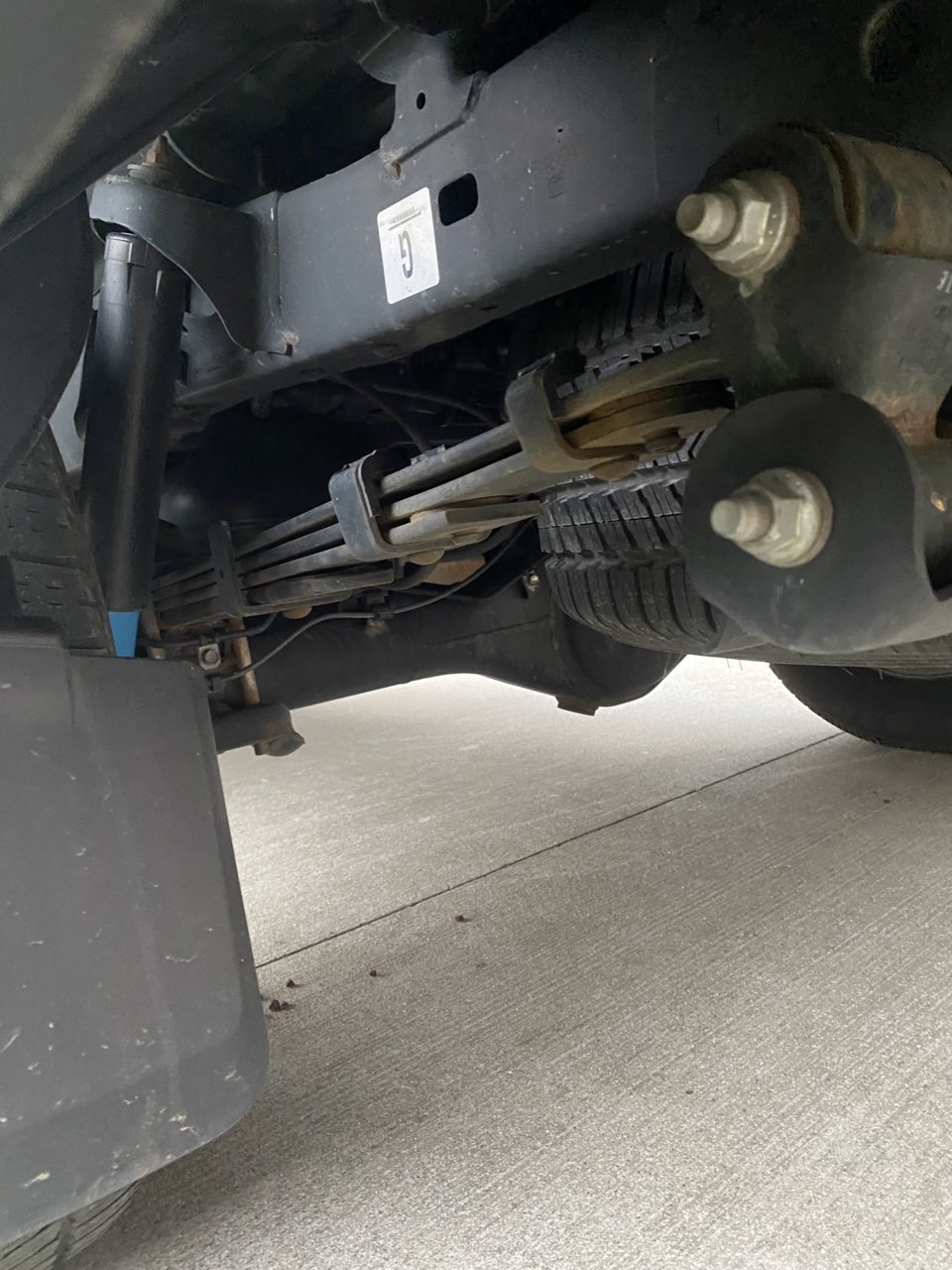

    I have a 2019 Tacoma TRD sport.
    It has about 40k miles on it.
    I was stupid today and hauled about 2000 pounds like an idiot. It was very squatted. I went about 10 miles with it. I’m not sure what they looked like before or even what they are supposed to look like.

    yeah they cooked

    "Yup, they cooked" was what I was thinking while scrolling through haha

    Stock leafs are pretty flat. Stop by any parking lot and look at the other 10 tacomas in the lot.

    They look as bad as stock leafs do before you put 2000 lbs on them...

    They looked exactly like that before you loaded it. Tacomas flatten out over time and are not that arched when new. They do the job.

    Stock leafs are practically "W" shaped from the factory. You're fine.

    Buddy man the leafs look better than mine. Stock is flat leaved for Toyota's usually, as previously mentions walk around the dealership and see. Don't haul that much again but at the same time I bet it just sat on the bump stops the whole time

    They're actually flat from factory. I looked underneath my 2023 TRD before I drove it off of the lot.

    Measure from bottom of arch to the center of the hub and ask a fellow sport owner to do the same and compare.
    My ‘20 OR long bed measures 22.5” from center of hub to bottom of arch.
    But yeah putting twice the payload limit in your bed will likely mess something up…
