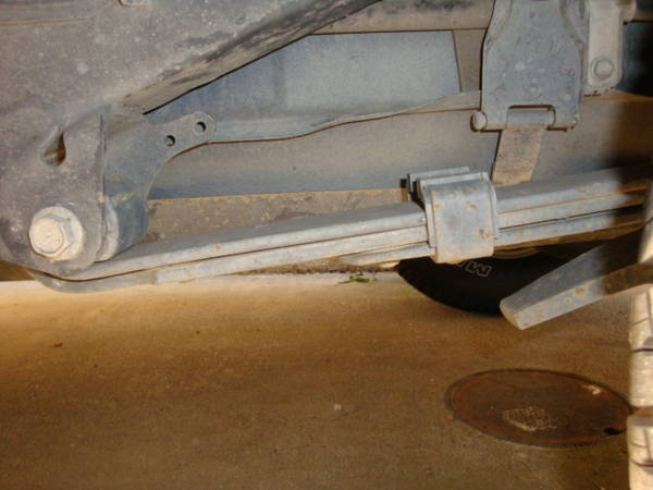

    Hey guys. How do my leafs look? I think they look pretty bad but im not sure after looking at the OP's leafs which look way worse than mine.
    They have 158,000 miles on them.

    Mine look the same! Do we need new ones??

    yes you do.

    my leaf springs looked exactly like yours when i had my blocks in the back

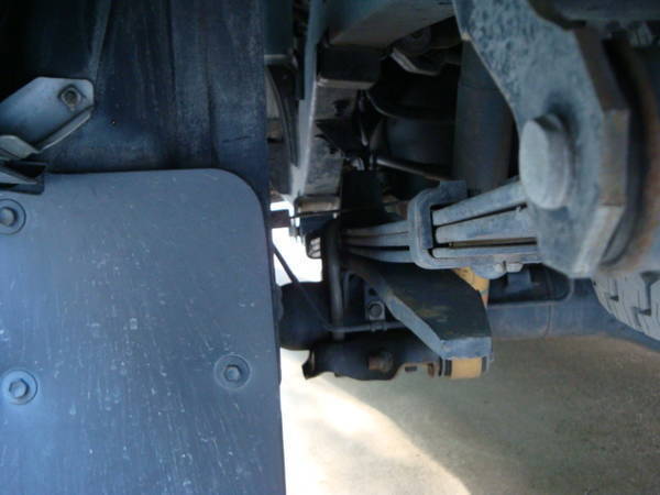

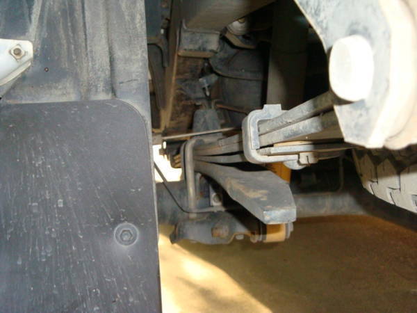

    OMG! Mine do too!
    The real question is does the rear end feel sloppy and do you get axle wrap when starting from a dead stop (feels like hopping or lurching, at least with a manual) and when braking to a stop?
    Here are pics of mine. 105k miles, and a Snugtop (~200 lb?) lives on it.
    As a reference, there is 1.75 inches between the top of the overload spring tips to the bottom of the bottom leaf, both front and rear. I'm getting new ones.
    Lots more discussion on this thread:
    http://www.tacomaworld.com/forum/gr...heelers-offroad-1st-gen-leaf-replacement.html
