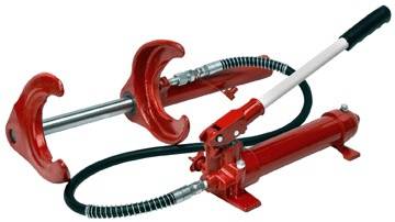

    That's why I bought this ... So I can change the front struts myself
