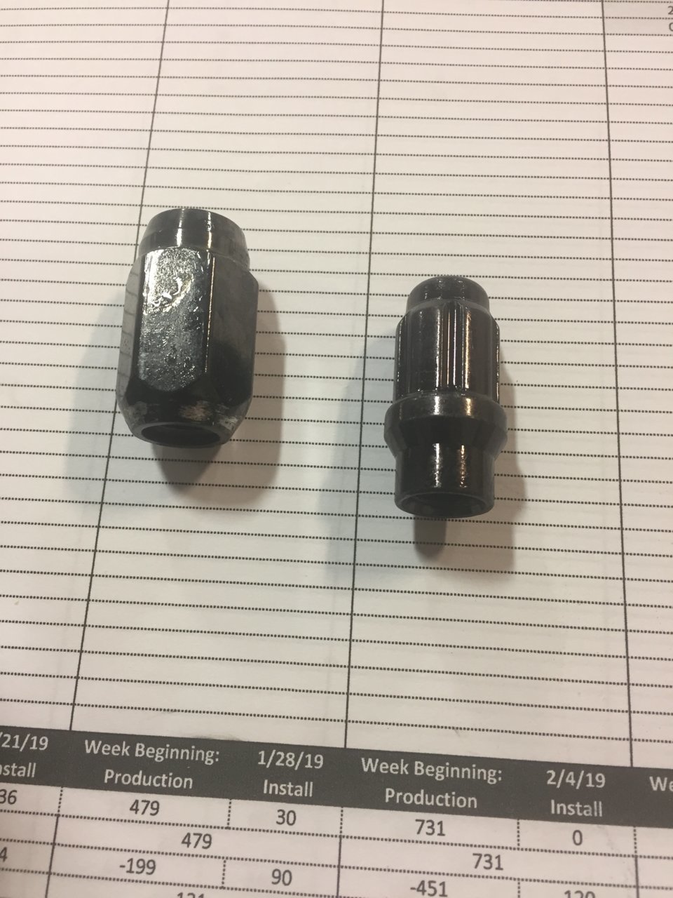

    Before replacing the Duratracs, I switched lug nuts from regular taper style to ET style. Now I am looking at outer tie rods because the tire guy said they shouldn’t move so easy.

    Changing lug nuts as you did shouldn't make any difference. The newer ones you went to still seat on the conical section of the nut. The extra length is there in case you need more "reach" to access enough threads on the studs. They're most commonly used with relatively thin spacers.
