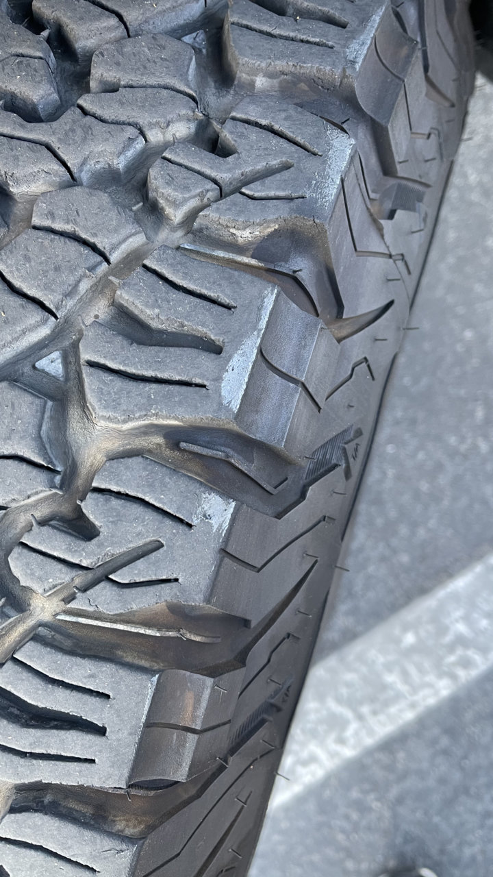

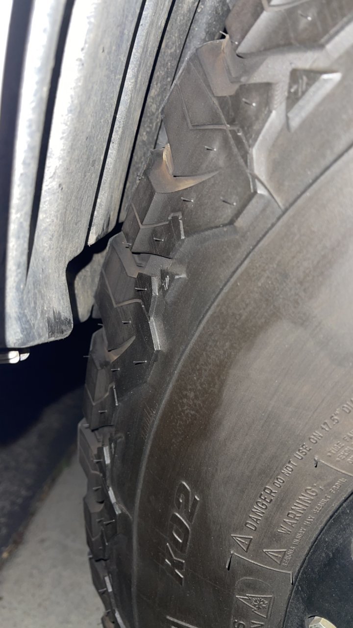

    So I got a cmc done because my tire was rubbing in the inside part of the frame and I put some bora 1.25” spacers and now it’s rubbing on the area where they did the chop Smh. I’m running icon 2.5 cdcv with resi, camburg tubular, method 17” and BFG 285/70/17. Are my tires just to big? Will getting my caster forward solve it?

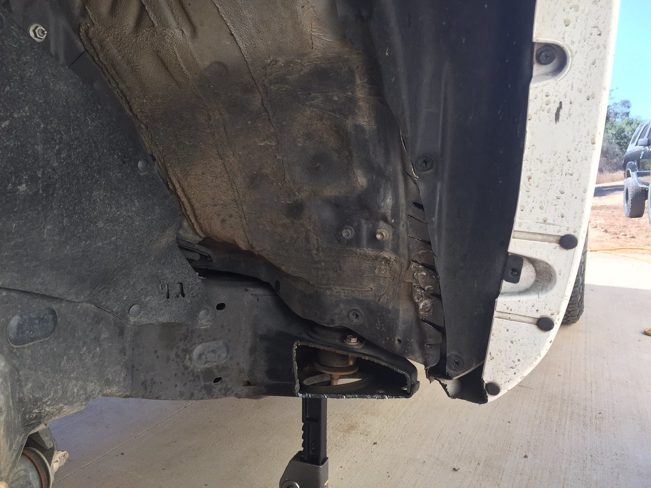

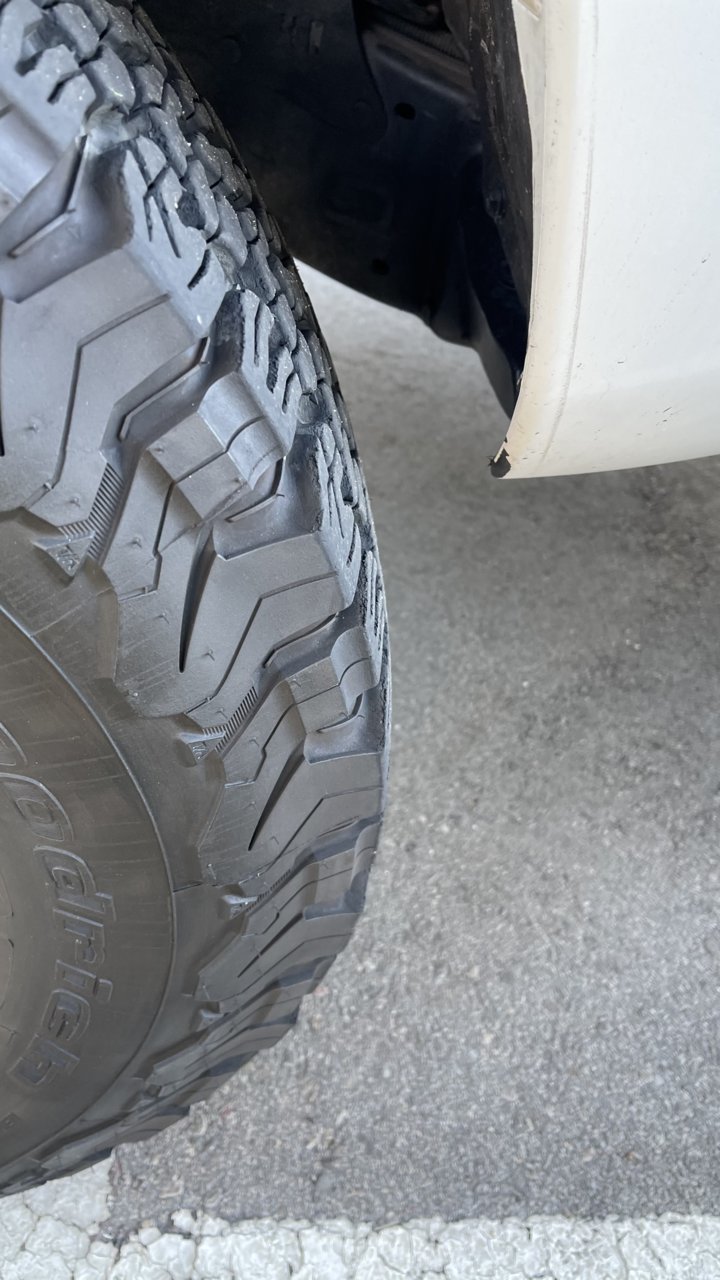

    yeah I think nuts my chop because I’m noticing more on the drivers side and the chop looks like it has more meat. 1st Pic is drivers side

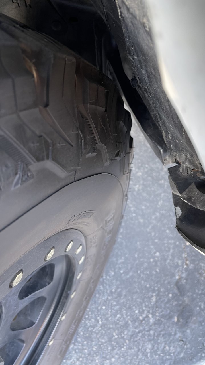

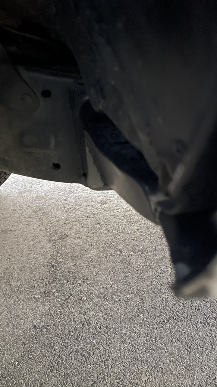

    So much for caster I’m getting rub on the front wheel well plastic going in reverse Smh

    No, he's asking what the wheel specs are, not the tire. It sounds like they might be something like 17x9 with 0 offset. Even that shouldn't rub the frame so your offset might really be something like +6 or +12. I had 16x8 wheels with 0 offset and 285/75/16 and did not rub the frame or cmc. The front plastic is easy to trim but your spacers are probably pushing the wheel out too far causing the rub on the cmc. The wheel specs (or part #) will give a better idea of what's going on.

    I'd rather have it trying to rub on the front fender wells than the cab mount area. The front fender wells just require a bit of heat gun love. Warm them up so they are pliable and then you can use something to roll them out and stretch them a bit. Hold the shape you want till they cool and then they'll stay that way.
    Also, the little "bulge" in the fender liner at the very bottom with a hole in it...you can remove the two screws that hold that to the bumper, drill new holes slightly further back in it, and then push it further forward so the new holes have the screws pass through them. This will hold that fender liner further forward adding a fair amount of clearance.

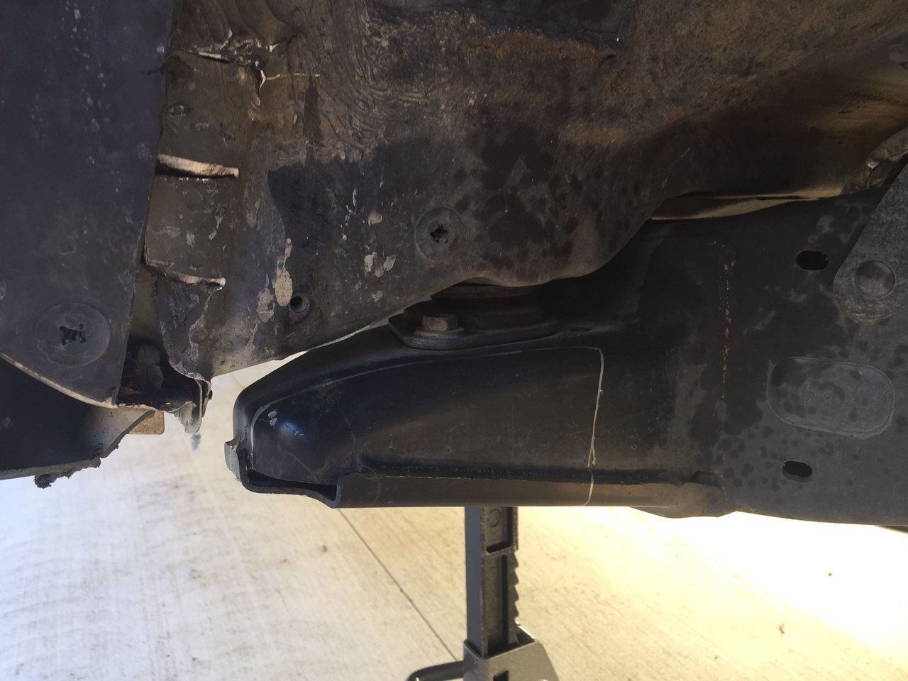

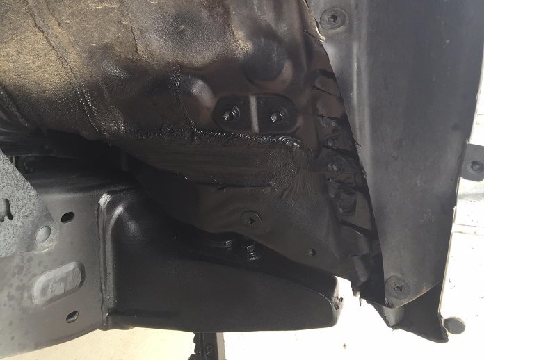

  19. Jan 12, 2021 at 9:54 AM
    #19
    FJ to Taco
    FJ to Taco Well-Known Member
    Mar 10, 2015
    #150578
    556
    Tony
    Lacey, Wa
    2015 DCSB 4x4 TRD Off Road,Snugtop Rebel
    Bilstein 5100's all around, OME 885's and OME Dakar CS047R Leaf Packs. Snugtop Rebel, pet screens,front slider drop down window. WeatherTech mats. Interior LEDS

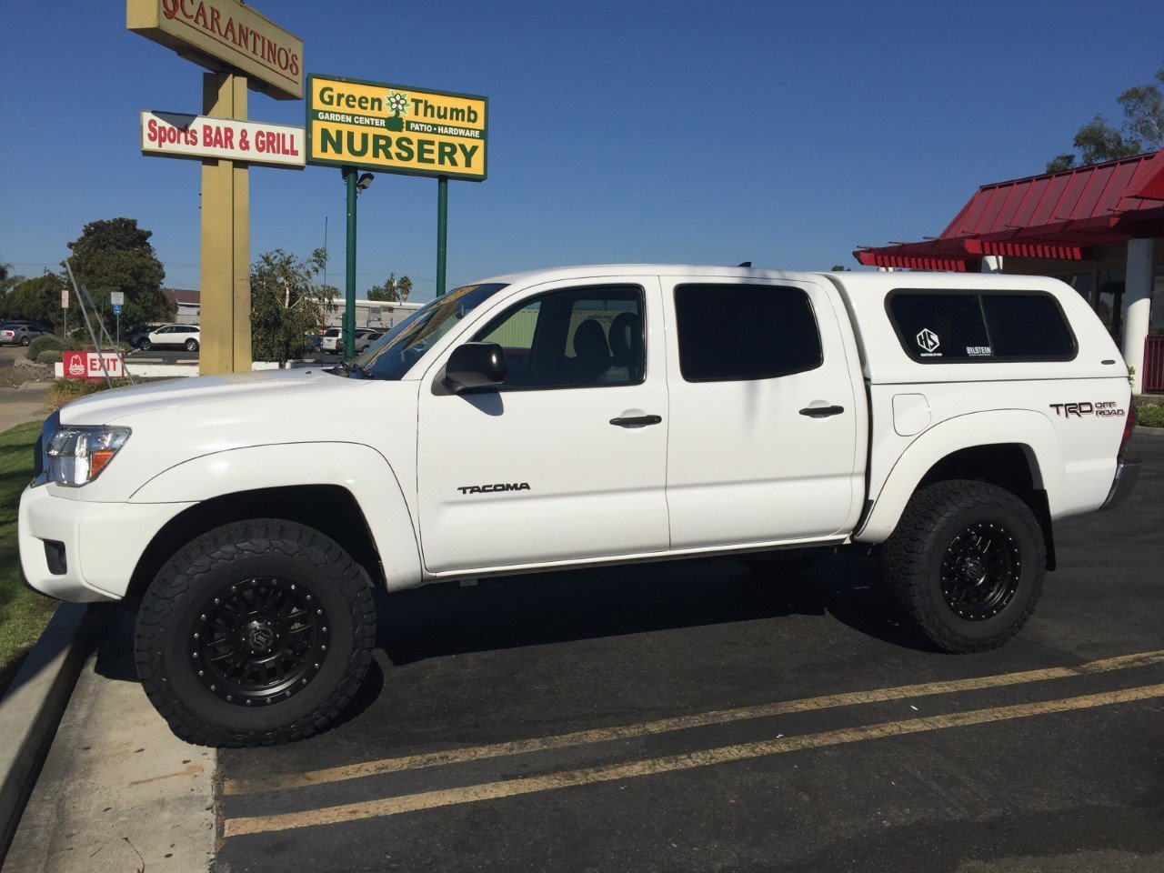

    Your tires are not too big, I have the same tires and they do not rub.
    It looks like you CMC is not correct. The replacement piece sticks out to far as others have stated. Also the caster can be adjusted as you say. Here are a couple pictures of mine done with the pinch weld hammered down. 17" Icon Alpha Wheels BFG KO2's 285/70/17's, 2015 DCSB 4x4 TRD OR, 2 1/2 " lift
    Before BMC.
    Next
    Done
