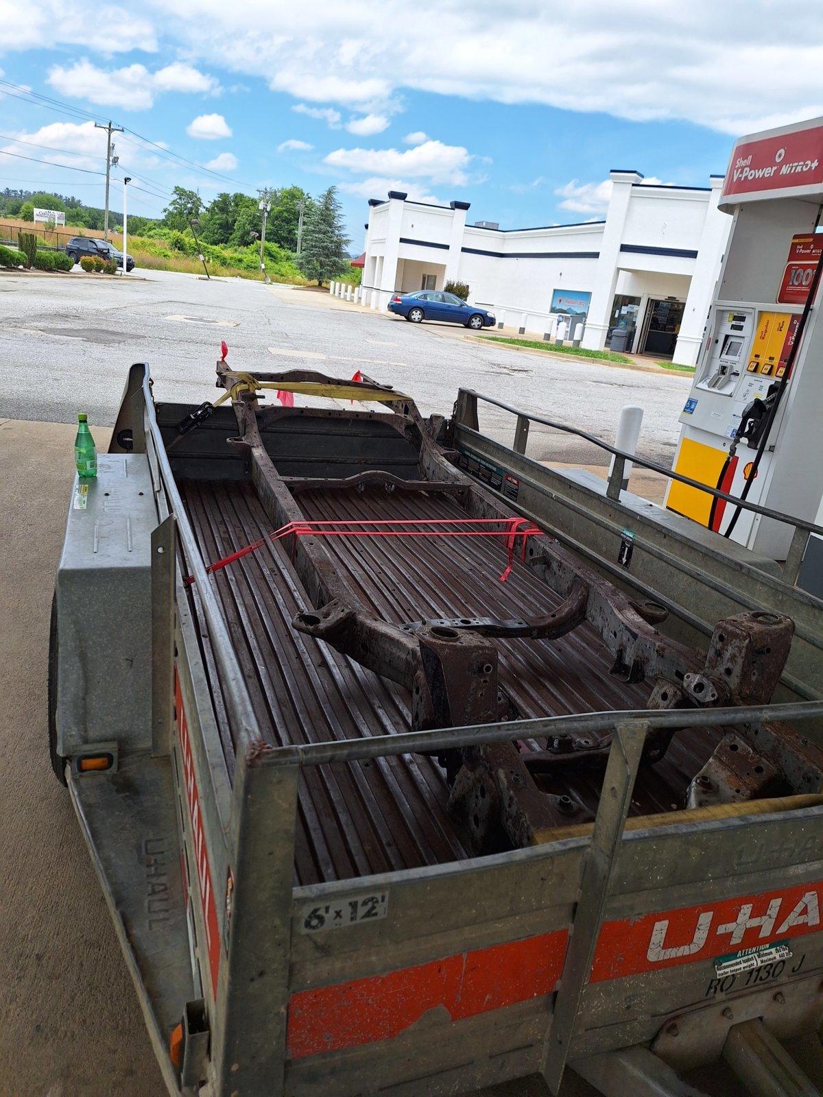

    I galvanized mine last summer. It was less than $500. The frame holes all had to be re-tapped, which was the most time-consuming part of the project but it could have been avoided with better planning. I ended up coating the frame with POR15.
