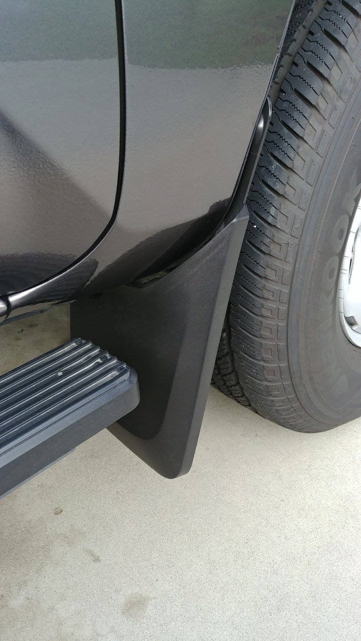

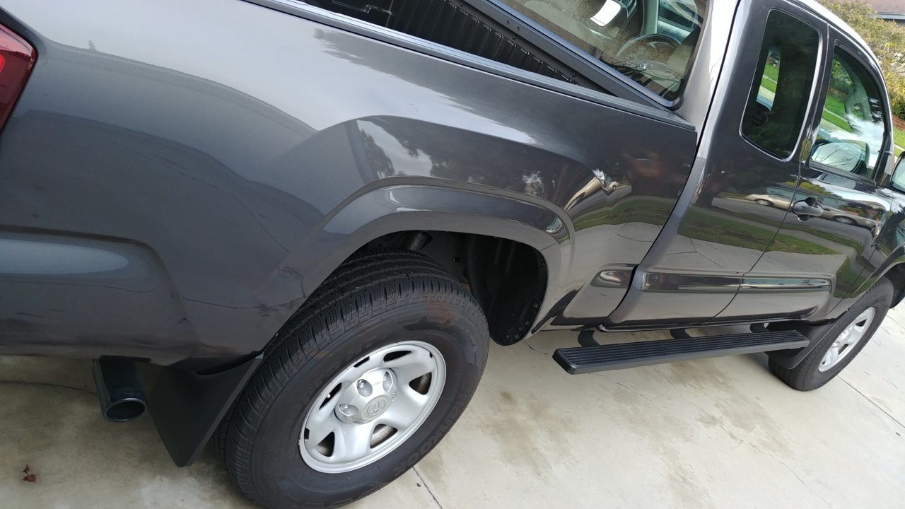

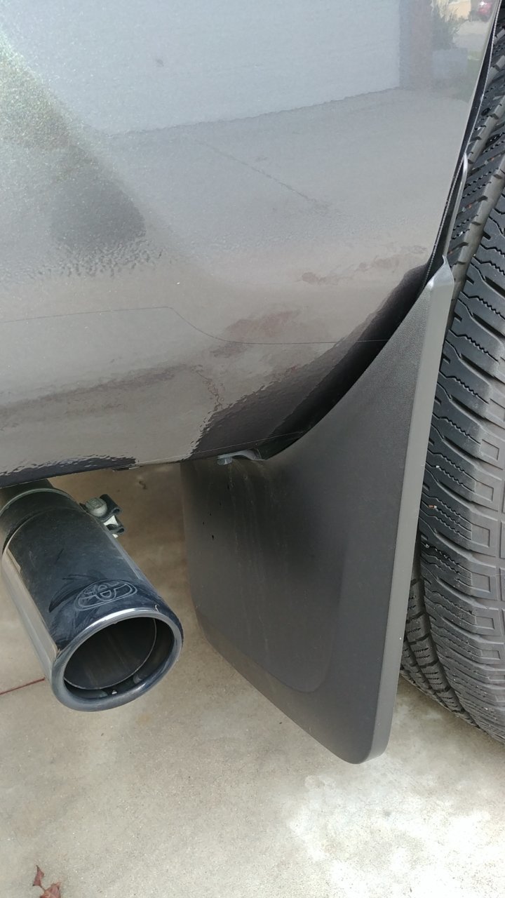

    No. As far as I could find, only toyota makes one mud guards for non access cabs. I own an access cab and I bought the oem mud guards for the double cab and all I needed was I think 2 more screws and 2 more grommets and to remove the rear bottom plastic piece behind the rear wheels. Those plastic pieces are only held in by two screws and tape. You can buy the rear plastic pieces that goes behind the wheel that fit the oem double cab mud guards but not worth the time. You can get the weathertech access cab mud guards but I'm not sure about the fitment. The double cab one mud guards fit fine but has a small gap but its not really noticeable.

    Looks fine to me15516579977186093828366222078076.jpg 15516580464832616096495637330883.jpg 15516580765974472541698944183223.jpg

    You will get a better fit. Those mud guards are for trucks with flares which he does not have and you do. There is no difference between access and double cab just flares and no flares.

    Excellent point...the flares would just fill that gap perfectly. I back on track to get mud guards. Thanks for that info!
