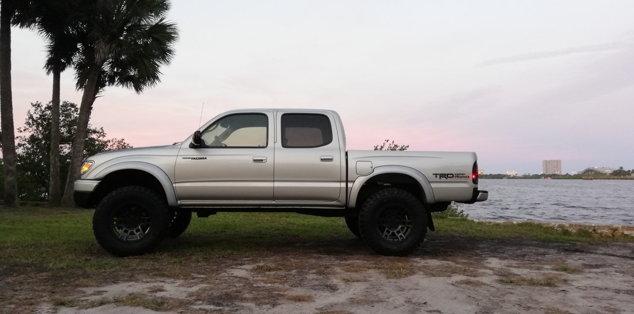

    Why is that? Have you ridden in one without a bumpet/skid/winch and 883s? For 3 years now its felt great. More forgiving then the stock trd setup. IMG_20201016_185234.jpg
    39 5/8 from ground to fenders all the way around with an AAL.
    Cutter_[OP] likes this.
