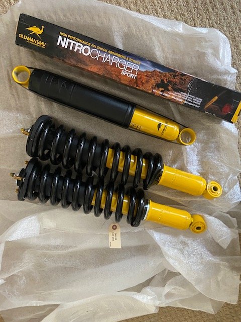

    Suspension came in today, still waiting on the leaf springs. I went with 882 springs per @jbrandt's advice. Spring choice was difficult because I wanted something as tall as the 883s but made for stock bumper/no winch. I was looking online and calling around to get the technical specs on them, and I got all kinds of mixed info.
    Wheelers, who I bought it from, seems to agree with @jbrandt that the 882s aren't as gnarly/stiff as the 883s, but give the same lift, more than the 881s. Toytec says the 881s give 1.5" of lift, while the 883s give 2.5" of lift (roughly) while being made for a heavier bumper. I called ARB directly and the guy seemed to have no idea what he was talking about, saying I couldn't run 882s. Wheelers rep said he runs the 882s on the same truck and likes them.

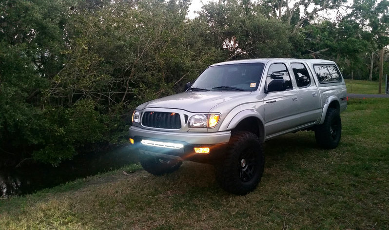

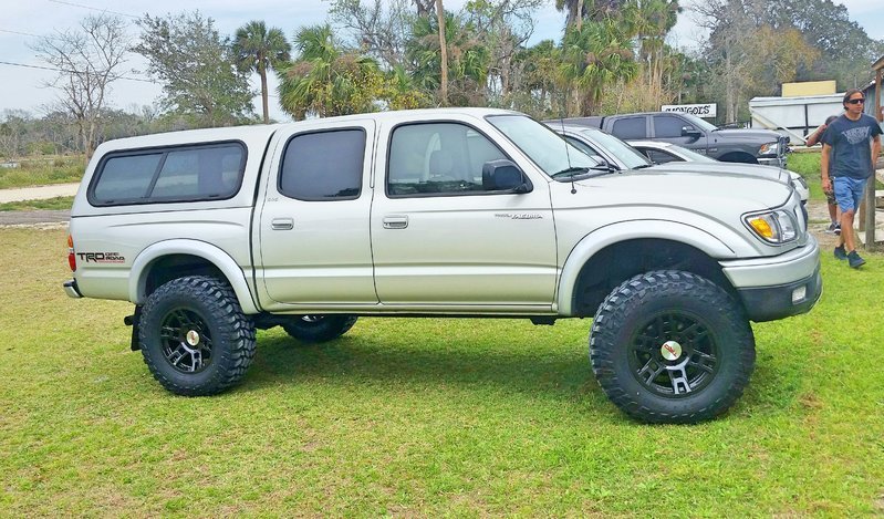

    Bottom line, I'll be running the same rims/tires as @SellyKlater and hope the truck sits level with the 882s vs the 883s, without looking too tall running 33" tires. I've got a Dakar leaf kit with separate Dakar AALs coming, I'm sure I can find a way to ensure its leveled. I'm just hoping I don't lift it past @SellyKlaters truck. If it is, maybe I can run 34" tires to make up for the extra space between the wheel and the truck that just looks goofy.

    I know @SellyKlater is running 33s with no rub, same truck and suspension

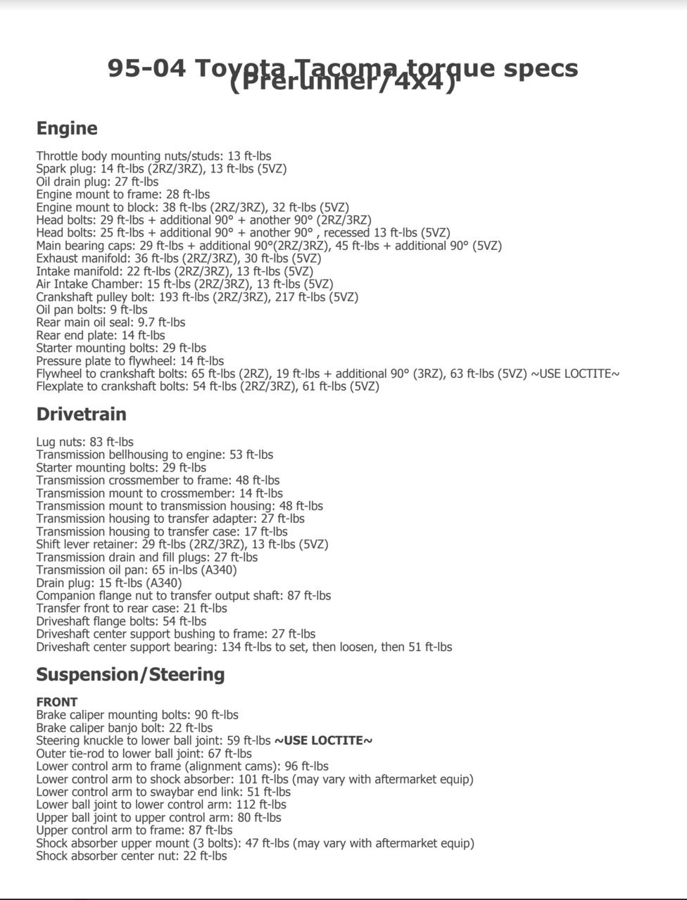

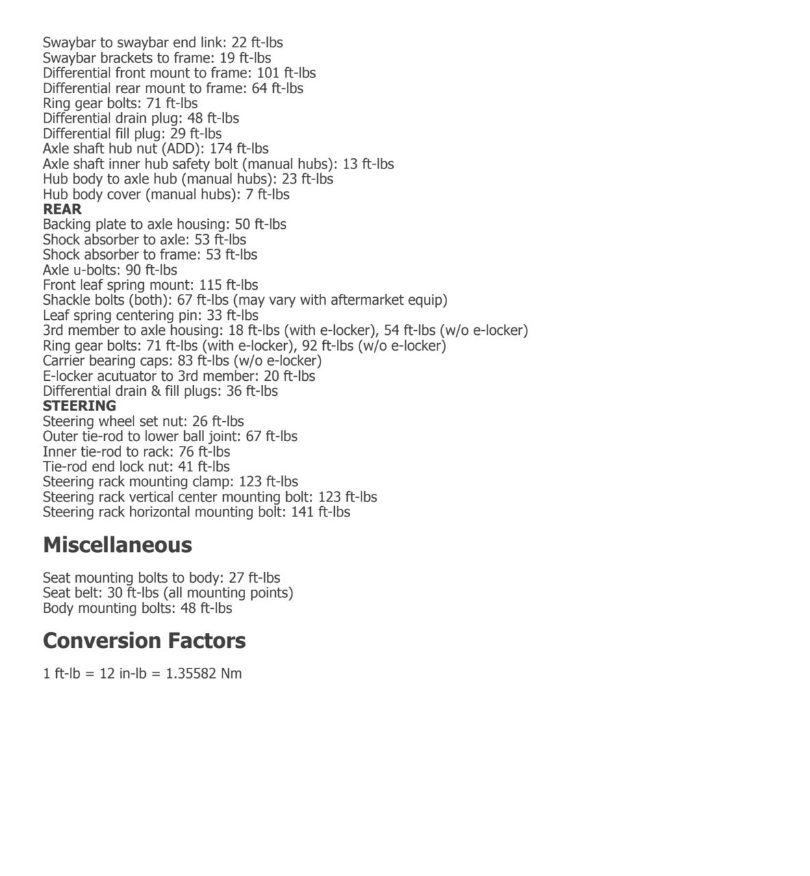

    Should I grease bolts? Anyone have torque spec for front shocks, rear struts, and leafs for an 02 prerunner?
  16. Nov 27, 2020 at 9:32 AM
    #56
    eon_blue
    Mar 4, 2016
    #180213
    69,965
    Azusa, CA
    Here ya go
    Don't need to grease any bolts, the only things you want to add lubrication to are the leaf spring bushings if they are poly bushings. If you have the stock OEM/rubber bushings no need to grease them.

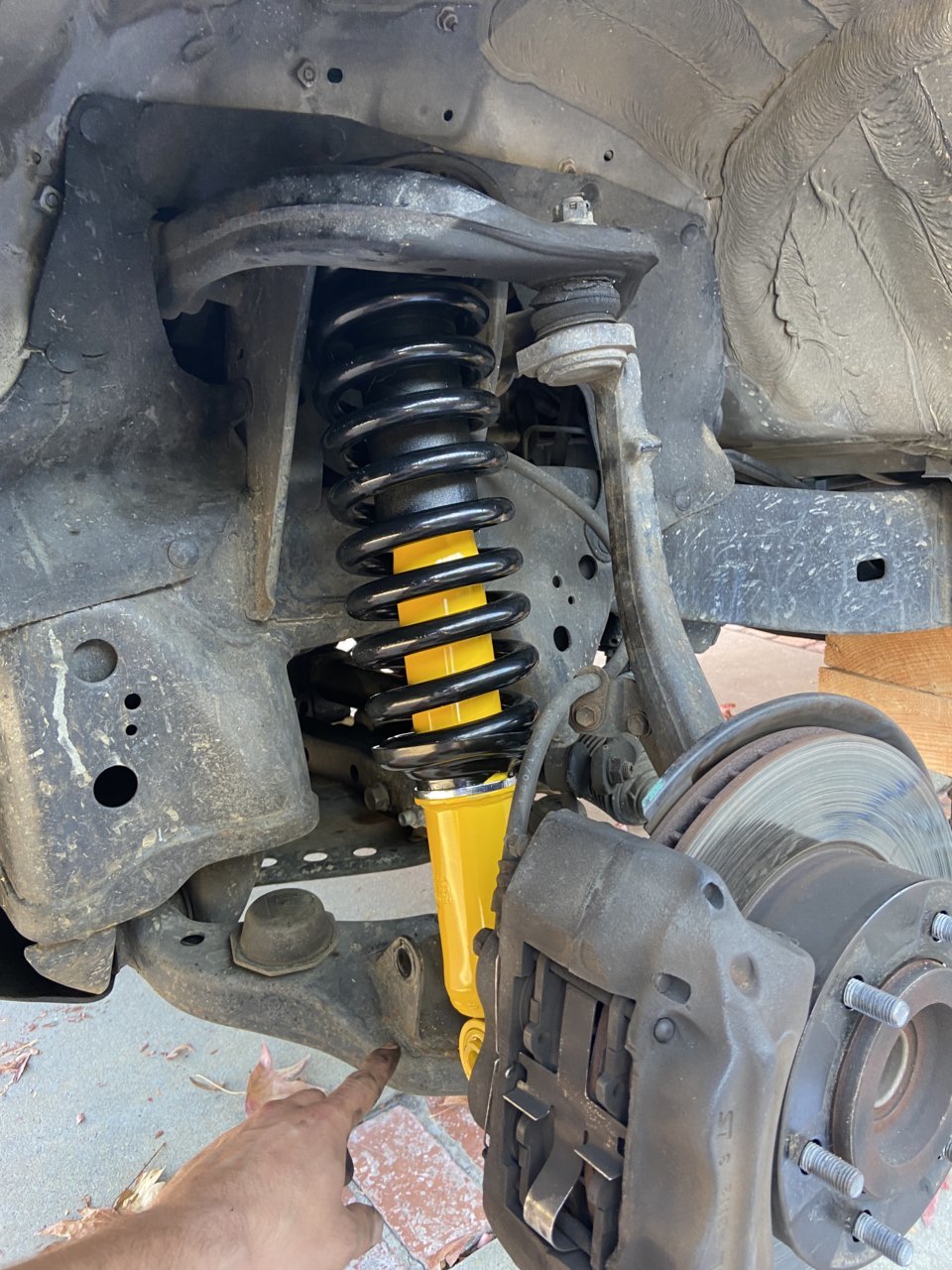

    Cant get bottom of shock into the swing arm. How do I get clearance? Tried everything. Truck on Jack stands in driveway
  19. Nov 28, 2020 at 2:24 PM
    #59
    SellyKlater
    SellyKlater Well-Known Member
    Feb 8, 2017
    #210037
    753
    Ponce Inlet, Fl
    2004 Tacoma 3.4L Double Cab TRD
    3" ome lift 883. Fnfx pros.
    I used a long crowbar between the top of the arm and the bottom of the frame to push it down. Takes some force.
