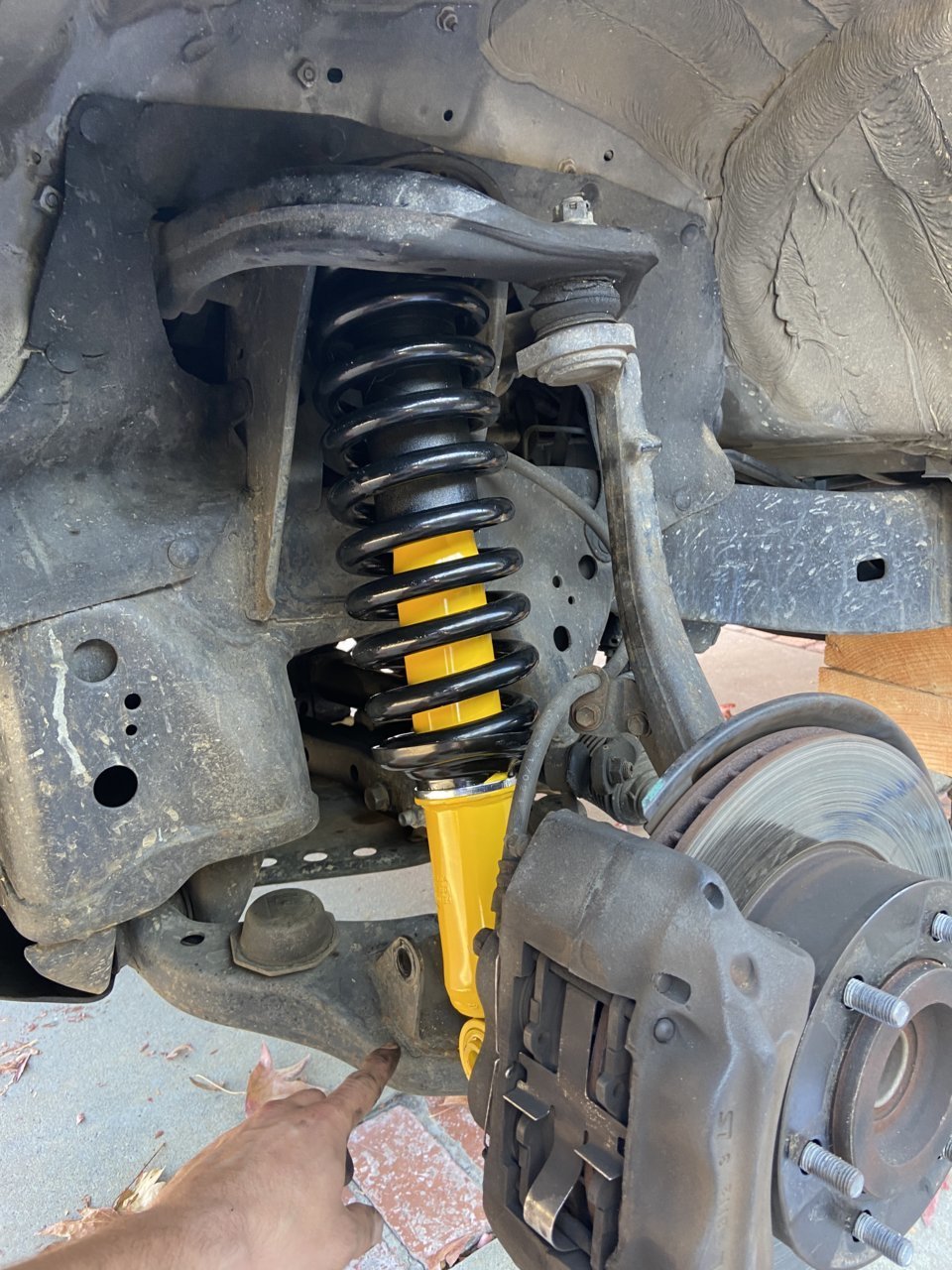

    If there is some way I can unbolt the LCA and drop it down I can get the shocks in. But I’m not seeing how to do that on these trucks
    EDIT: Looks like this is what I need to do
    https://youtu.be/5E6u7dC7EHg

    Wedge a pry bar between the arm and where the bump stop strikes and push down, should be able to get the arm to move down more.
    Some people loosen the cam bolts on the arm to get it to drop more instead but make sure you mark them if you do that so your alignment isn't all messed up afterwards

    I’m going to attempt this today. Crowbar method won’t work. Will remove bolts connecting ball joint and steering knuckle, then loosen cam bolts on the other side of the LCA

    I haven't had to do it before but I believe aftermarket UCAs give me more droop allowing the LCA to drop down more.
    If you have a bottle jack I've heard that can work too, I think it goes on top of the UCA against the top of the wheel well... When you extend it, it pushes the both arms down further.
    I would be inclined to try that before messing with the cams but if that's the only way its the only way. Be sure to torque them properly when done so they don't clunk like crazy, cams are around 90-100 ft/lbs... Should be on that torque sheet I posted a ways back

    I'm not worried about alignment, I'm getting new rims and tires in January. The cams are what is adjusted for alignment, correct?
    eon_blue[QUOTED] likes this.

    Yep, that's part of it. You'll want to get it as close to what it was at though because if it's way off it can be difficult to steer and drive.
    If you mark the cams position now and match it up when you tighten them it should be fine

    @Cutter_ did you remove the sway bar links from the LCA? if not you NEED to do that otherwise too much resistance
