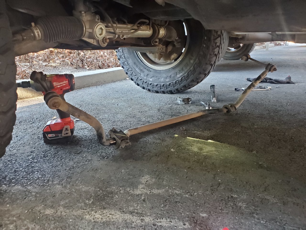

    This will definitely help, but even then most people (myself included) didn't need to remove the sway bar or loosen the LCAs to install their coilovers.
    Removing the sway bar, or at least undoing the end links, will allow more droop.

    what do the links look like? I was just going to loosen the cam and unbotton the steering knuckle. Is your method easier?

    Some have had success with loosening the lower control arm via cam bolts, just mark them as suggested so you can put them back in place. You'll need an alignment after lifting anyway so it doesn't have to be perfect.
    Just look at your truck; your end links have an allen key insert and a bolt outside if they're OEM.
    Some people use a box/open ended wrench and allen key but I've been successful in zipping them off with an impact alone.
    Stupid easy and takes 10 seconds to zip them off on both ends.

    Here you can see the end links at the end of the sway bar.
    Total of maybe 5 minutes to remove completely if you wanted to. Good time to replace the bushings as well on the sway bar, or leave the sway bar completely off like most of us do.

    I'm only showing you what @frizzman suggested, as he is right in that unbuttoning the sway bar will help provide some needed droop.
    My method, was already posted before in your other threads, which was simply the use of a bottle jack.
