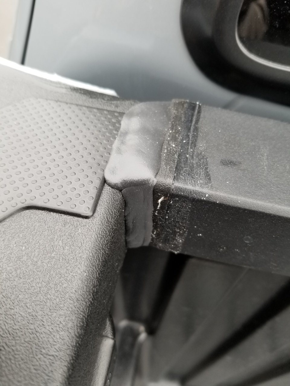

    I pulled the bulkhead, removed the end plugs, sealed them with RTV, put down a line of RTV under the bulkhead and re-installed it. Then pulled the rail caps, put down 2 lines of RTV and filled the 6 threaded holes and reinstalled rail caps. Then I used butyl tape to fill the front corner gaps; both sides of the plastic rail cap. I made little tootsie rolls with the tape and kept cramming them in there and packing it tight with a nail head. It was a pain. I had the cap installed 2 days later. Also got Mike's cubby cap covers and sealed tailgate (ESI kit) and those 3" gaps in front of tailgate (black RTV).

    20190404_135222.jpg This is how I used butyl tape in the front corners. It doesn't show the gap underneath the rail cap overhang (also crammed butyl tape in there). So far, so good.

    I didn't realize that the installer needed to lift up the back of the drivers side rail cap to access wires. Luckily, I had just put RTV under the rail caps 2 days earlier, and it wasn't cured yet. The installer was amused. Maybe try to time your trip to the installer so they let you put down RTV after they tap into the wire?..
    Again, a good installer/dealer is key.
