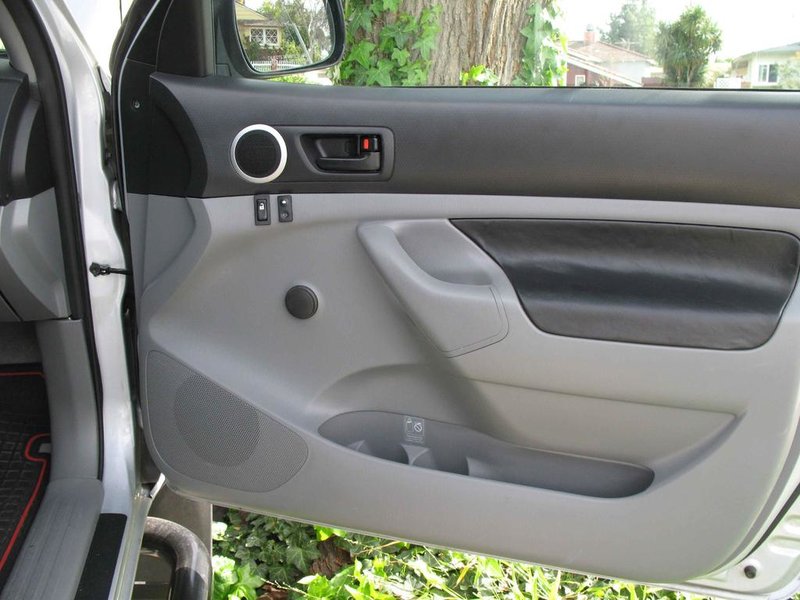

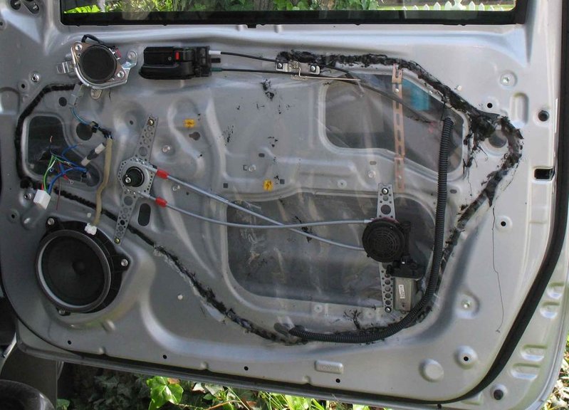

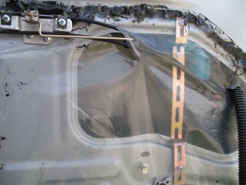

    There is not much info on power windows and door locks upgrades for 2nd generation Tacomas. I am new to Tacoma World and thought I would share my recent do it yourself project. I own a 2007 Tacoma Prerunner single cab. I was disappointed when I bought it that it did not have power windows or power door locks. In sunny southern California, power windows are a very nice feature, particularly on a nice day while driving alone, a must to lower the passenger side window. I started by buying the Spal deluxe 2 door window kit. I was lucky to find a new one on ebay with switches for $95.00. I also live near an electronics surplus outlet "All Electronics" where I picked up some power actuators $5/each and wire for about $10.00. I purchased 2 power door lock switches on ebay for $12.00. I've posted some pictures of my install and would be happy to answer any questions if any members have any.:p
    http://www.tacomaworld.com/forum/attachment.php?attachmentid=91590&stc=1&d=1299509449
    http://www.tacomaworld.com/forum/attachment.php?attachmentid=91591&stc=1&d=1299509449
    http://www.tacomaworld.com/forum/attachment.php?attachmentid=91592&stc=1&d=1299509449
    http://www.tacomaworld.com/forum/attachment.php?attachmentid=91593&stc=1&d=1299509449

    The Spal power window kit includes almost everything you need, a complete kit. Only exception is switches and wire. As I mentioned earlier, I was lucky to get the deluxe window kit with a Spal switch kit as an extra in the ebay auction. I highly recommend getting the Spal window switch kit as well. It makes everything complete and easier to install. The switch kit runs around $50. Now, regarding the door locks, I basically put together my own kit from scratch. To do this, I bought 2 actuators, 2 switches (ebay), wire and made my own cable converters from scratch. Cable converters allow you to attach the actuators to the newer cable drives. There are a few posts on the internet about the installation of these. Toyota uses cables now instead of the older rod mechanism. You can find these cable adapter kits on ebay for around $10 each. you will need one for each door. Aside from the $127 mentioned above, I bought extra wire from the home Depot that I think ran an extra $30 for the door locks. The door lock switches have five terminals each for 5 wires and I needed to connect from one door to the other to be able to operate the passenger door from the drivers door. I bought about 12 feet of each color but only needed about 9 feet. All in all, I think I spent about $160 for everything. If you are unfamiliar with electrical/mechanical things I would strongly recommend buying a door locks kit as opposed to putting one together from scratch like I did Hope this helps.
