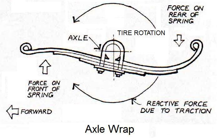

    That's a completely fair argument. I'd make one small point, the 2005+ Tacoma has a shackle inverted like Ford has used for a long time so it's possible the rear springs geometries are more similar than on 1st gen Tacoma and older trucks with traditional shackles. Shock placement isn't and I couldn't say about overall geometry, length or comparable spring rates. I agree with you, so just making a point for discussion.
    FWIW, just in case someone's following and not sure what the heck is being discussed. When you put torque into the axle the leaf springs tend to "wrap" up like an 'S'. This is an exaggerated visual and of course shows spring under axle, but the principle is the same. It's stressful to the springs and causes the tires to hop. As the distance between the spring and axle is increased the greater the moment (e.g. torque, leverage) the axle can exert on the springs.
    It's not a simple this-or-that problem when designing or modifying things but you can generally say blocks should be avoided if possible. But sometimes there's benefits, such as angled shims, which improve pinion angle for driveshaft stability. That's why I mentioned a small block, 1/2" to maybe an inch, can be OK. I use shims and if they cause axle wrap to get worse I haven't noticed.
