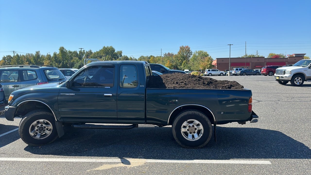

    It isn't the bed you should be worried about

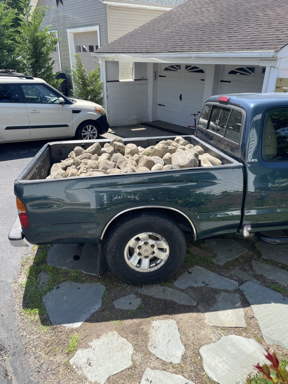

    When I haul stones and topsoil I splurge the 30 dollars and rent a trailer. Why risk your own equipment and paint job when it's easier to load it on something that's better designed for abuse?
    "I bought mah truck to do truck stuff," say the contrarians. So do I. I use my truck to pull a trailer. And on Monday morning, I still have an intact suspension to drive to work with.

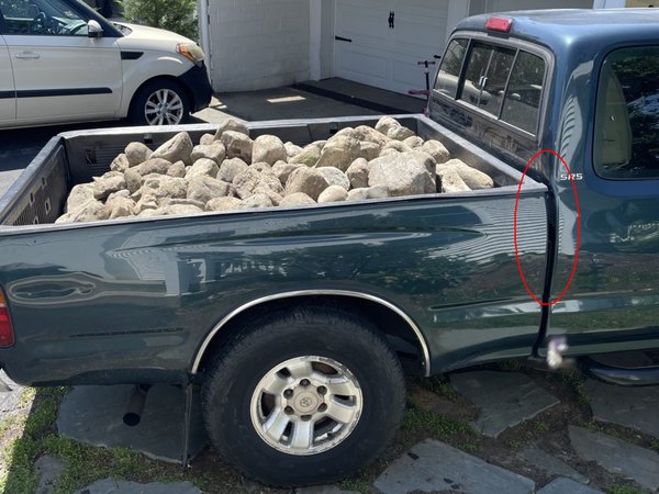

    You'll be fine. I haven't seen issues with the bed in the 2nd or 3rd gen Tacomas, as far as hauling the things you've pictured.

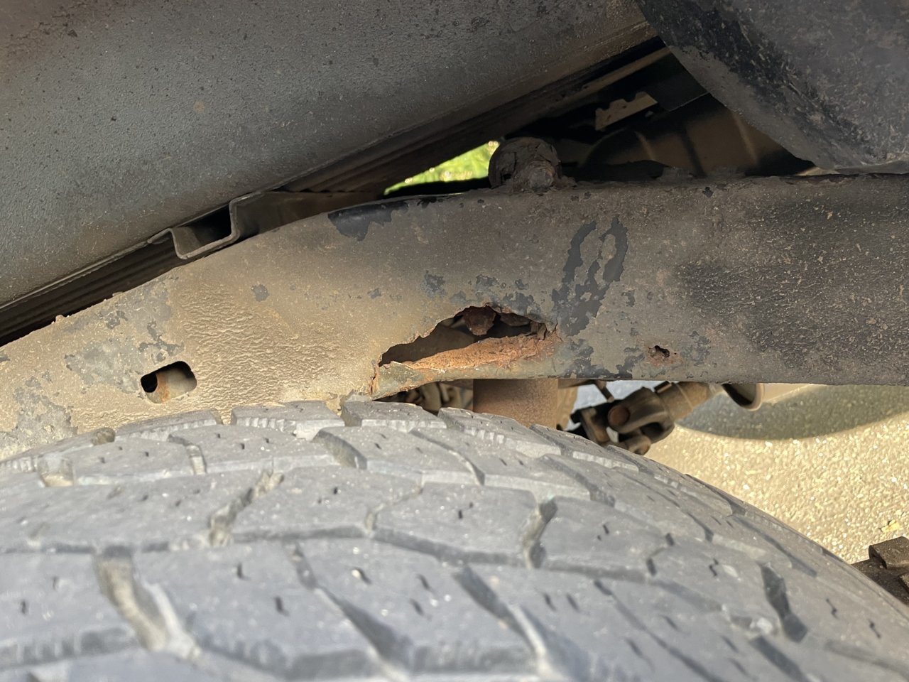

    I don’t have this truck anymore. The frame failed on that side and I had a safety cap frame repair. It was always crooked after that.
