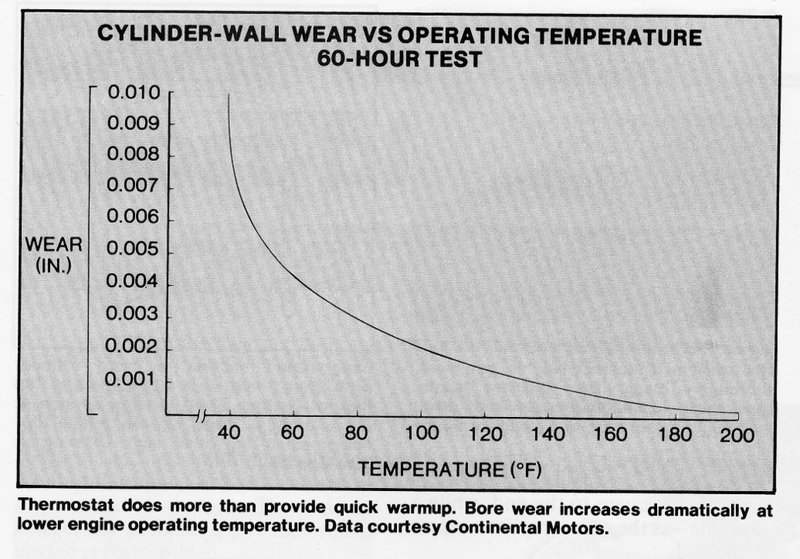

    Short trips no bueno. It takes 20 minutes of steady state driving for all fluid temperatures to equalize to full operating temps.
    Does the op have access to a golf cart?
