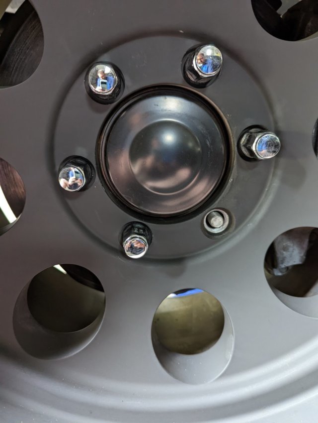

    This is what I'm talking about when the bore center does not coincide with the bolt circle center. The other unknown here, is what does the overall center of the wheel coincide with; the bore or the bolt circle?
    In this example a hub spacer ring would not solve this. A 100% lugcentric balance would not solve this; at best, it would require a lot of weight to balance.

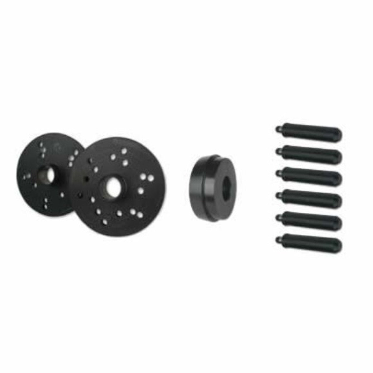

    They use the pins because the large cone has too much taper. It is hard to center on the balancer shaft. There is a special cone that is made for toyotas that has very little taper and works very well. Even with the bolt plate adapter, you still use the cone. The bolt plate adapter is a pain in the ass to use. You need 4 hands.

    Are you referring to the Haweka adapter? I thought that was called a collet, not a cone? Used in conjunction with a mounting plate...

    Haweka is one of many manufacturers that make balancing products. They were one of the first that made the bolt plate adapter or lug hole adapter or one of the many names for this tool. A Collet is probably by definition is probably not exactly what Haweka is using, but that is probably an argument for engineers. It looks like what haweka is offering is an adapter that mimics a hub flange. I would say that is better than a cone, but using that along with a bolt plate adapter, it would be a real hassle to use over simply back coning a wheel and going on. Shops are focused on speed. No tech want to spend 20 minutes setting up a balancer when you can spin down a cone and get pretty good results.
    The big difference between using the adapter and just a cone (or call it a collet if you like) is the position of the device. Getting back to speed, the easiest way is to front cone the wheel. Meaning the wheel goes on then the cone. That isn't how it mounts on the car, but for the majority of wheels, this method works. The correct way is to put the cone on then the wheel. The challenge is that for the majority of wheels, it is difficult to tighten down the hub nut (the part that spins on to the shaft to tighten the wheel on the balancer) without marring the wheel. That is where the adapter comes into play. You can use the lug holes to push the wheel tight against the balancer and center with either the cone or the machined adapter that haweka offers. Haweka addresses this on their site - Haweka - Front Coning Issue (haweka-usa.com)
