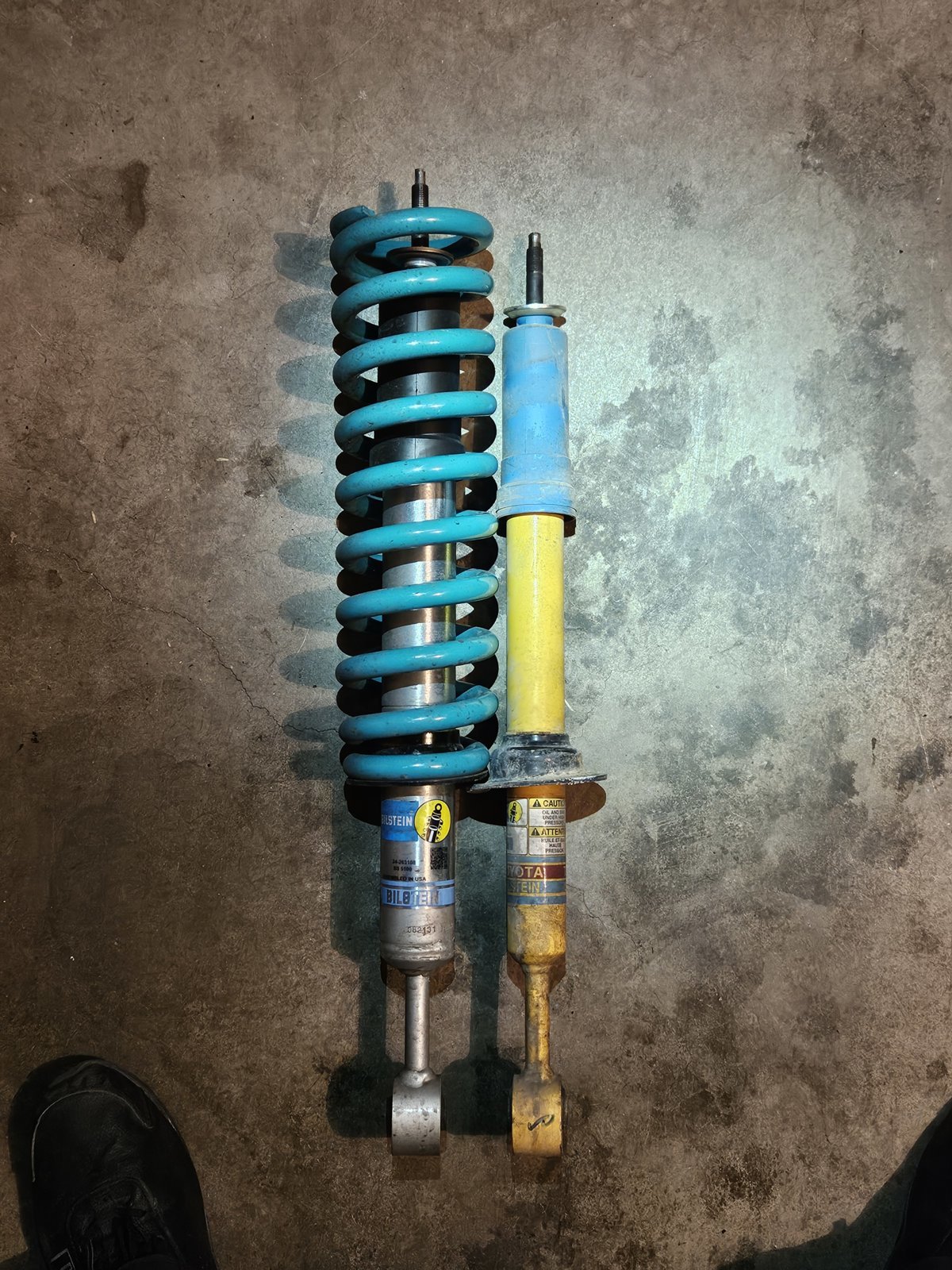

    5100s longer than OR stock. I did not measure when I had it out. 20240216_174821.jpg
