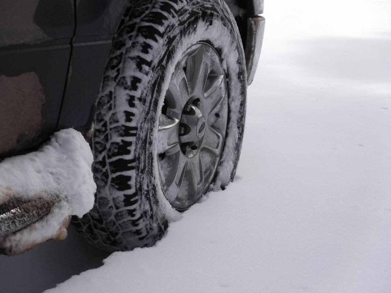

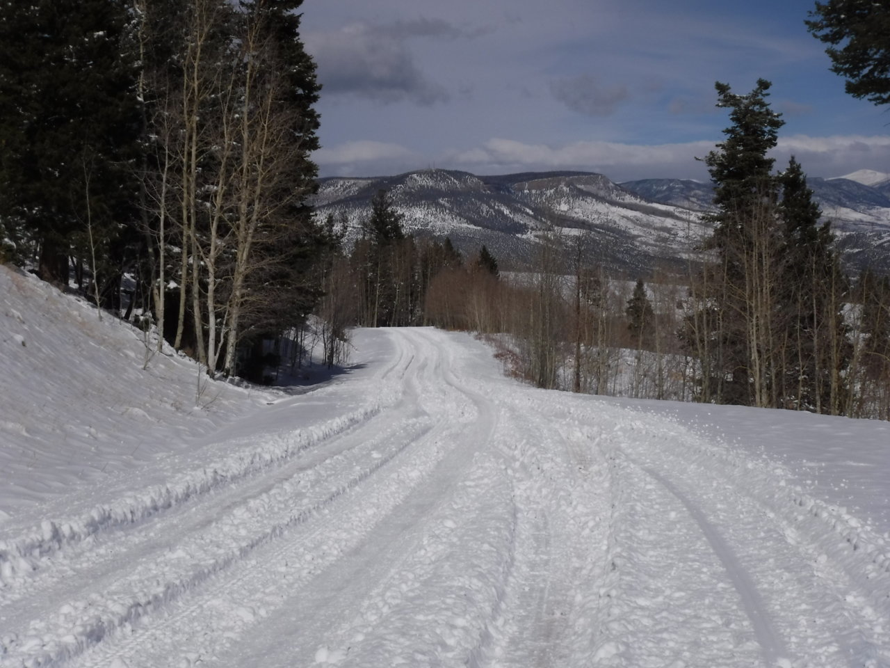

    I have the older AT/3's on my F-150. I've gotten good service out of them, The new version is very close, just a more aggressive sidewall. I'm at 55,000 miles now and might be able to squeeze 60,000 out of them, but will buy new tires next month before we get any snow here. They are not a hard core aggressive off road tire, but they've never let me down. I had a set for a similar number of miles on my Tacoma with similar results. They ride good, are quiet, and have performed well in snow. Neither truck saw a decline in MPG's. I drove the Ford to CO last November for an elk hunt and probably drove 200 miles on snow covered forest service roads.
    I'd advise an "E" rated tire, not that it is needed for load capacity, but it is a tougher tire less prone to getting flats when driving on rough forest service type roads. I've ruined a few "P" series tires that couldn't be repaired. It is cheaper to buy 4 "E" rated tires than 4 "P" series tires and then have to start replacing them one at a time due to damage.
    I'm at the point where my truck will be used mostly as a truck, and less as a DD and I want to go to something a little more aggressive next time. I haven't decided exactly which tire yet. I'm considering BFG's next time. Cost would be over $1100 installed. I'm also considering these.
    https://www.tirerack.com/tires/tires.jsp?tireMake=Pirelli&tireModel=Scorpion+All+Terrain+Plus
    I have a relative who works for Pirelli and can get me a set at a very good price. They are a more aggressive tire in person than the photo makes it appear. More aggressive than the Falkens, closer to the BFG's. I just need to see how much the price difference will be before I decide.
    This photo was taken a year ago with over 40,000 miles on the tires.
    I had no issues driving in these conditions.

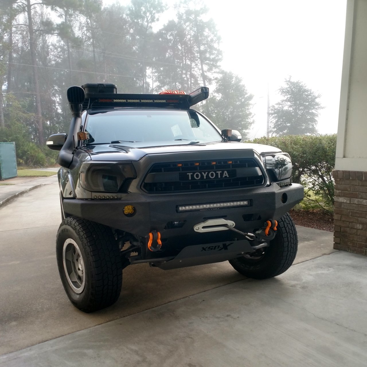

    I had the Goodyear Wrangler Duratracs. They were awful. Hydroplaned in anything. Got them replaced under warranty. Second pair was just as bad.
    Then I got the AT3 4s. Amazing! They're fantastic daily drivers. They look great and are nice on the trail and mud. No snow here in Coastal GA.
    The Duratracs look awesome. But being a grown up is better. Ha. IMG_20191003_052029_222.jpg
