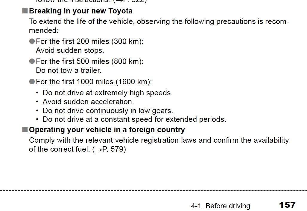

    First off, aside from the master tech the guy at the dealer usually don’t know jack chit. Therefore, and according to the manual, the engine is not broken in, that’s on you.
    That said, they are better assembled, with better tolerances. In other words, you can go full load with less chance of damage that maybe attributed to engine break in.
    But less we forget, it’s not just about the engine, but also the A/T, Differential(s), tires, shocks and brakes.
    This is in your owners manual, and if we don’t believe it, then you are free to believe anything or anyone you please.

    Thank you for this! I don't have a manual yet since, well, I don't have the truck yet. But this helps. Thanks again!

    It's in the manual.
    See?
    500 miles.

    The “Don’t drive at a constant speed for an extended period” is for rings and cylinder wall break-in, some old school advice still works.

    Just about anything that moves or has some type friction needs a little "break-in" lol
