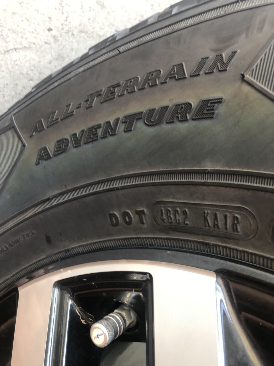

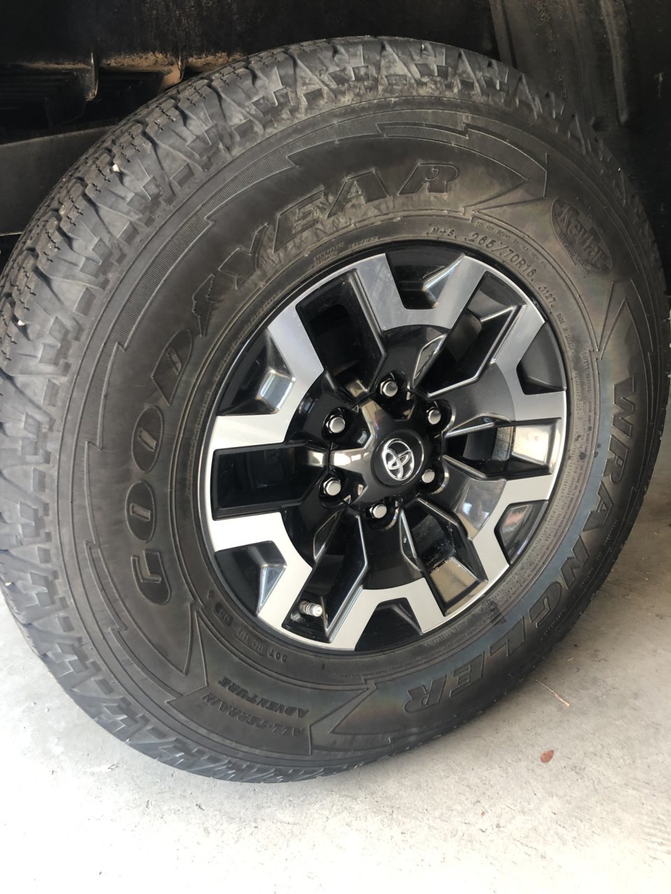

    Are the Stock Goodyear Wrangler AT "Adventure" tires any good for Off- Roading. Not looking to rock crawl. I have the 2020 TRD off-road and they came as standard equip.

    They are ok as far as oem tires go, but if you're worried, sell them!
    Buying tires is fun, and a thick 10 ply LT tire will look better and will be more resistant to puncture.

    Probably not. In my experience, the P-rated Wranglers do not hold up off road.

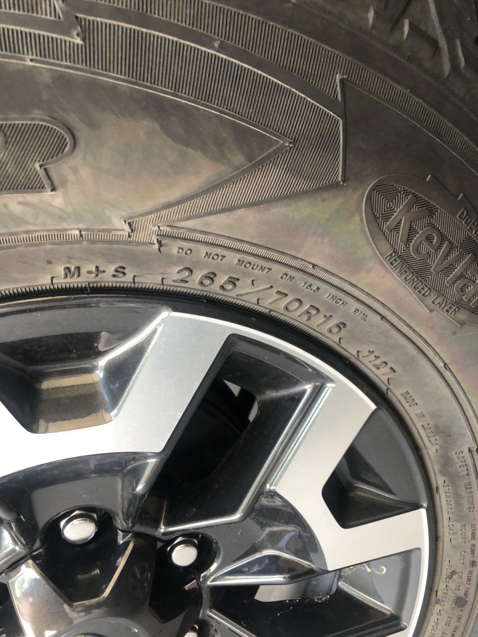

    They are LT (Light truck) rated, not P (passenger)

    They are standard load metric tires. Not LT.
    LT tires would have LT###/##R## in the label. Goodyear doesnt make the adventure in LT265/70R16.
