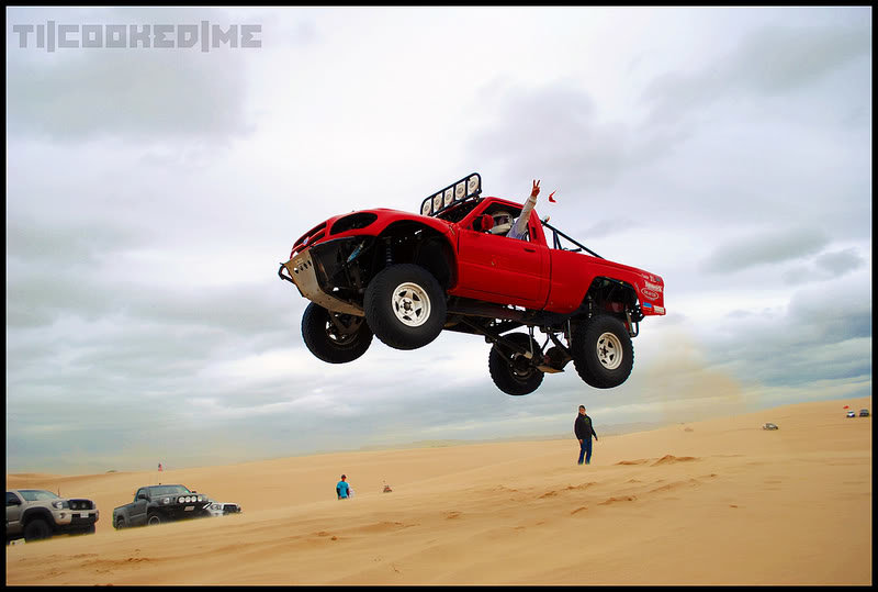

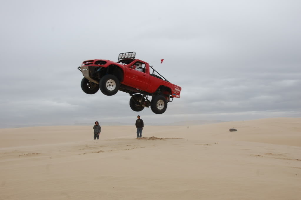

    And there's nothing wrong with 12" of suspension travel:

    The red truck is not mine. It's Bryan's (desert guy here on TW).
