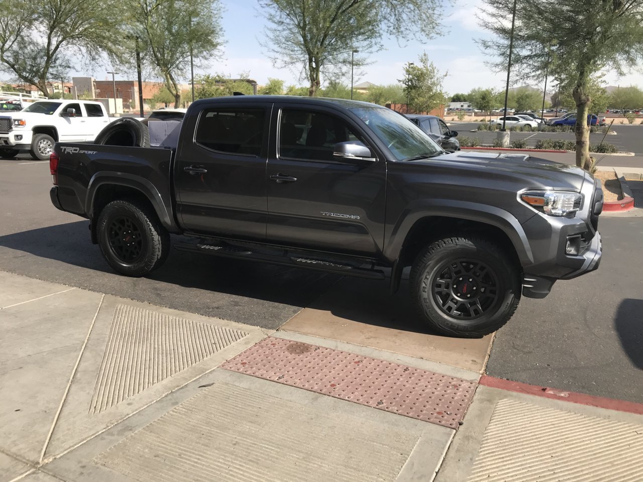

    I am running Cooper AT3 and TRD pro rims. With everyday driving around town, no rubbing issues even with mudflaps.
    As others have said, the problem seems to be primarily with bumps while turning. If you are just driving a mall crawler you should be fine. Most of the rubbing people have mentioned seems to be very minor. 005.jpg
