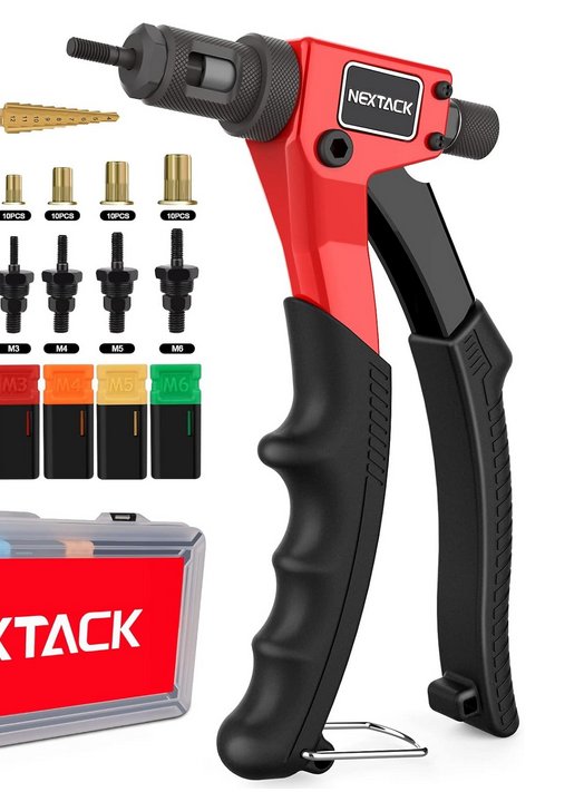

    I've been having an awful time trying to set rivet nuts. The problem is finding a one-hand tool that isn't crap.
    I don't set a lot of rivet nuts and never larger than 1/4-20 in aluminum. And very few of those. Mostly I set 5mm and 6mm. I've never broken a mandrel, nor have I worn one out. But the problem I have is finding a tool that will adjust to where I can set a rivet nut without having to reset the tool and do it twice.
    I've tried the Harbour Freight models and they are semi-OK, for a while. But they don't hold up.
    I bought a Nextack (picture below) and thought I had what I needed. But the adjustment on that is so fussy that when it is ready to set a rivet nut, the nose piece and barrel are so loose that they are in danger of falling off. And that's what happened today. The 5mm nosepiece and barrel disappeared into the bowels of my Tacoma, possibly into a catalytic converter shroud. Once the Nextack barrel is gone, the tool is useless.
    So, any ideas for a one-hand rivet nut setter?
    The Nextack:

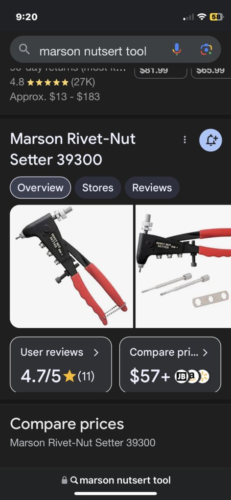

    Oh really? I was just doing more research and saw it only does blind rivets so I was looking for a nutsert tool made by Marson and it looks like they are available. Not sure though- never had to use rivnuts. Worth a google though

    Marson rivet tools are the best. I'll look into their nut setters.

    I actually use the Nextack. The instructions are wrong. They want you to make it fall apart like that. I fiddled with the adjustments my way and did some 8-32 rivnuts good.
