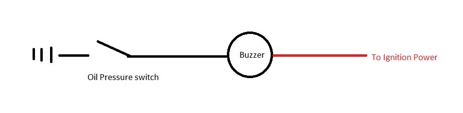

    If you just want something that makes noise what the oil pressure drops below a desired pressure you could just use some sort of 12v buzzer and a pressure switch set at whatever pressure you want it to come on at.

    This seems like the easiest way to achieve the solution.
    Some older cars (Ford?) Had oil pressure switch tied into the fuel pump relay. No oil pressure=no fuel pressure.
    They are handy for fail safe systems.
